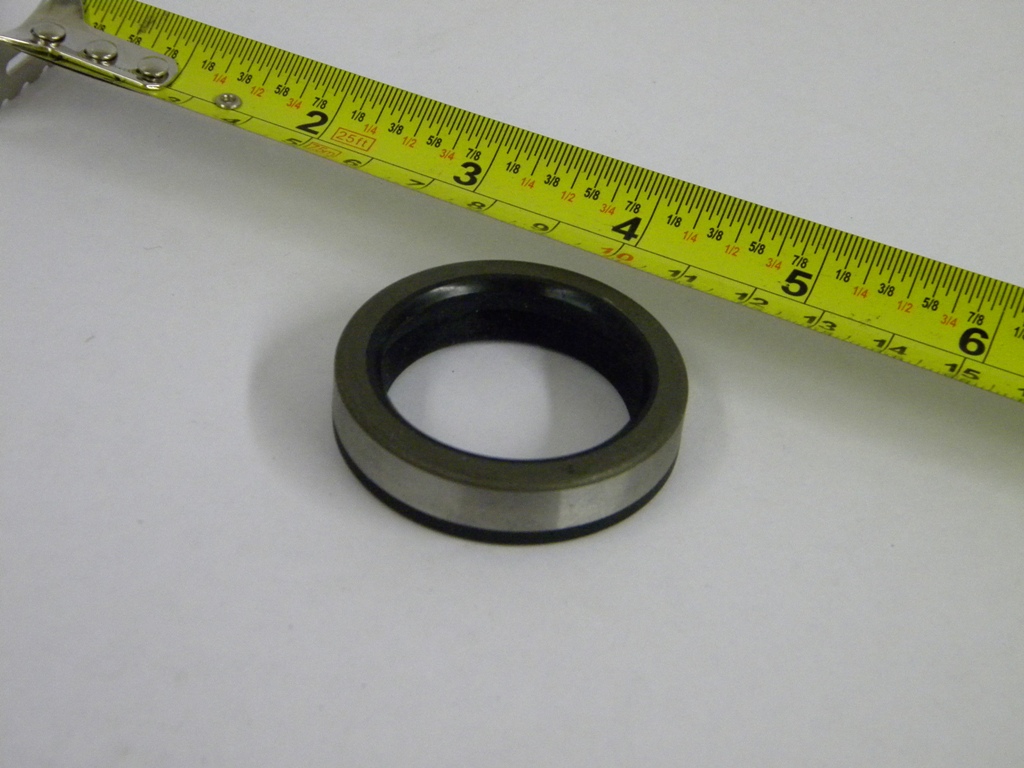

gringeltaube
Staff Member
6,886
2,269
Montevideo/Uruguay
Does anyone know of a source or p/n for the output shaft seal on the M35 steering gearbox? .....
Just so the original question doesn't go unanswered...
From the ORD 9 SNL G-742 parts manual; Fig. 14-1, item BB: Part No. 500044, SEAL, oil, type ML, 1-3/8 x 1.832 x 7/16.
Now, 7/16" would be extra-wide, for that size of seal at least. Best if you could get an OEM repair kit, which would include the (mil.spec)seal.
Otherwise the closest you will find in the civilian world are:
  • TIMKEN #330480N (1-3/8 shaft Ø x 1.832 seal O.D. x 3/8" W, single lip)
  • TIMKEN #323138 (1-3/8 shaft Ø x 1.832 seal O.D. x 1/4" W, double lip)
  • SKF #13537 (1-3/8 x 1.828 hsg. bore x 5/16" W, single lip) ---> NAPA
G.

... According to that link this is the timken part number
http://www.amazon.com/Timken-323138-Power-Steering-Shaft/dp/B00460G1EY
No, it just says #323138 "provides a compatible interchange". It probably is more popular but it's a single-lip style and only 1/4" width. And made of Nitrile (S) instead of Polyacrylate (N)
The #330480N is a much better option IMHO; unless someone wanted to use two of the thin ones, with the outer one reversed - its lip pointing outwards...?
G.
Edit: Updated (corrected) info, in post #21
rustystud
9,071
2,388
Woodinville, Washington
Gerhard, I downloaded the Timken seal catalog and according to it the seal #330480N is a single lip seal. The seal #323138 is a double lip seal and is used in over 960 automotive steering gears.
I received my seals today and there is an extra outer lip on it. It is also new manufacture not old NOS like the surplus stores will have.
