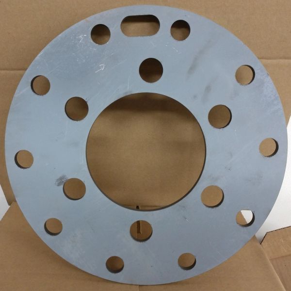

I'm interested in swapping my deuce to super singles. I found a couple sites for adapters and wheels. Didn't know if they are the right things for what i need. I don't mind if wheels are scuffed up because I'll end up getting the sandblasted and powder coated. And i need to know what else I'll need to complete the swap. If anyone has feed back or information it would be greatly appreciated.

While I have A3 wheels, I like the custom made wheels that Eastern is selling. But man are they pricey at over $400 each. The offset is good to bring the front out a bit and then use them dish out on the back.
Actually I like them on the front (only) because of backspace and A3 wheels with dish out on the back.

In regards to singling out, I have everything I need to do it, but I did have someone tell me I would need to shim the front end to track straight? Does anyone have any info in regard to that claim?

I went with the radial Goodyear’s, MV/T’s, any idea the length of the 1 inch bolts for mounting the MRAPS to the adapter plate? I’ve heard 2.5” length and 3” so need to verify please and thank you

@Metalpoptart I went with 2.75 in long ones with mine. I’ll post some pictures, they were perfect but just barely long enough. All depends which wheels you have. More than likely you have the aluminum ones but there are steel ones also. The steel are a thinner hub area compared to aluminum. If you have the aluminum ones I’d go 2.75 or longer. Grade 5 will be plenty strong enough also, I asked when I did mine. All the hardware I got from copper state nut & bolt company. They seemed to be the best priced when I did mine and the customer service was awesome. If you have any questions just ask, happy to help any time DCEFE765-32A3-4461-ACB9-A8DFE04B5F6F.jpeg38F42C67-1EC7-46AD-A2EE-0BA3F1CD9AB9.png

I was told not to use nylon, but to use the metal locking type nut, but I appreciate the info! That’s exactly what I needed, what was the torque? And I have the aluminum rims.

I’ve not had a issue with them so far and have used it quite a lot here on the farm, but I don’t plan on ever taking them apart for anything and have applied torque strip on them to watch any chance of loosening. On the torque I don’t have the exact spec but I believe I went somewhere around the 4-450 ftlbs on them I believe you can just use general torque specs for the hardware you use.

Using nylon on something like a tire/hub assembly is a no no. Vibration and heat make the nylon weak over time. There is a reason reason military used fine thread with lock nuts on deuces and 5 tons. They vibrate A LOT. We all know this.
I've ran across nylon fine thread locknuts on some rebuilt companion flanges on the M939s and when the joint gets weak and has a Vibration the nylon just crumbles out.

Also one thing I might add is when you are swapping the hubs over if you are is to throughly check the wheel studs. Out of everything those six buggers are the weak link. Which the age of the truck they can be stress cracked. I found four between my front two hubs cracked visually, and quickly decided to change out the complete front axle set
