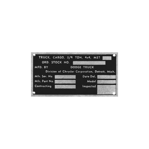

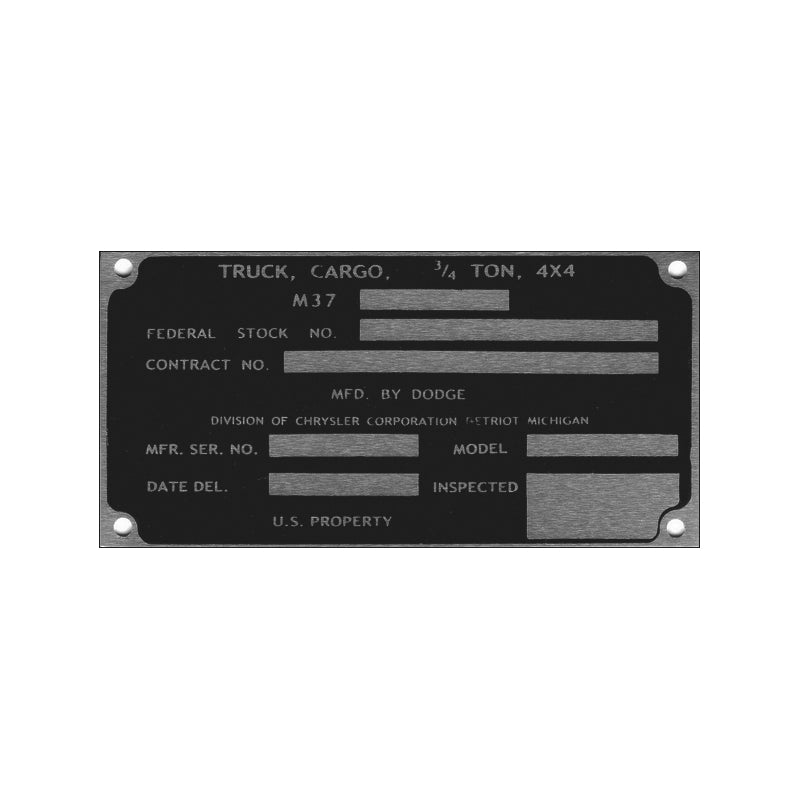

It turns out that for duplicating the stamped characters on a replacement main data plate, it appears that I will need 3/32" letter/character stamps instead of 1/8" stamps, so I just ordered a set. I've also been trying to locate an accurate reproduction main data plate. Not much luck so far. I may have to make my own. I should be able to duplicate the layout used on 1954 data plates, which has slightly different fonts from the earlier (e.g., 1951, 52) plates.
John Mc
251
365
Monkton, VT
Vintage Power Wagons appears to have two different Main Data Plates for the M37 (the description for one of them says it's for the M37B1). I can't tell a difference between the two, but I did not look all that closely.
ab705
71
207
33
Maine
Thanks for the links, but the original 1954 M37 main ID plates (at least the ones that I've seen) have all upper-case characters, rather than a mix of upper- and lower-case characters. If someone has an original main ID plate with mixed upper- and lower-case characters, please post a photo of it.
I also want to make sure that the black areas of the plate are recessed slightly (probably etched?) into the aluminum. Some of the reproduction ID plates I've seen are just ink or paint silkscreened onto the aluminum surface.
Years ago, I bought a very nice set of reproduction data plates that included an excellent main ID plate, but I can't seem to find them anywhere. :(
I'll keep looking through my stuff as well as online, but if I can't find one I think it might be fun to try making a reproduction plate myself. I should be able to create a reasonable facsimile with Adobe Illustrator, InDesign, etc., based on photos of original ID plates. If someone could post or PM a clear, direct photo of their original main ID plate, preferably a 1954 or maybe 1953 version, that would be helpful, as most of the photos I've seen online are not the best quality.
ab705
71
207
33
Maine
I guess you are right. I just found the picture of the data plate on my 1951 M37. It's all caps:
Actually, I think some M37s may have had original data plates like that one from VPW. I just haven't seen an original plate of that type in person...yet. I'm going to do a bit of research on the topic and see what I can find out, since I'd like to have a plate that is appropriate for my 1954 M37.
