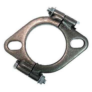

Howdy gang! Got an issue with an mep 007b. The gasket that holds the muffler in place and stops it from rattling is gone. I found the gasket (71-4396) in the manual but its no where to be found online. Anyone have an idea on how to keep it centered?

The issue is that the muffler has an area that is flex piping. When that gasket goes, the flex pipe start rubbing against the genset chassis till it breaks. I have 3 of these units with the exact same problem.

Oh I see. Well maybe something outside of the box then... not sure what the OD of the muffler pipe is, but maybe a two piece flange that you can tighten correctly, then drill holes into the case for a final location?
