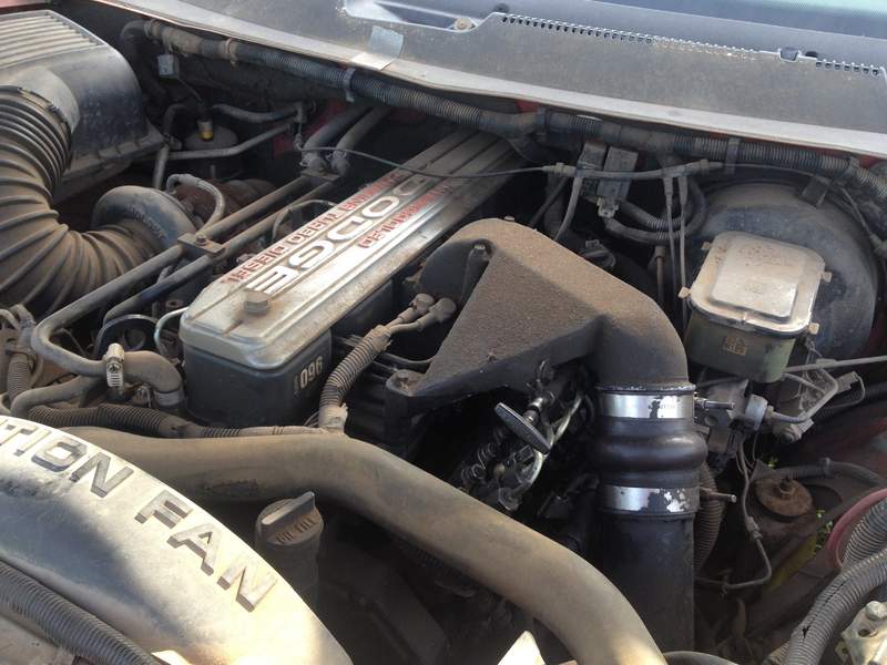

Nah. A2 will be when I get around to a Cummins 12v swap. Still looking for the right donor.
Picked up one of those today. $1K for the whole truck. Pics to follow.

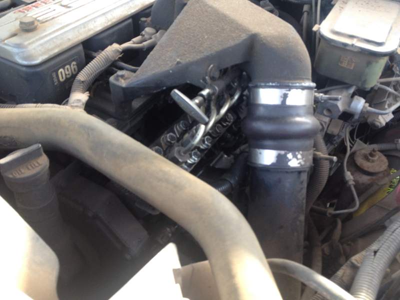

1994 with the P7100 inline pump. Only 200K on the clock.
4x4 w/manual

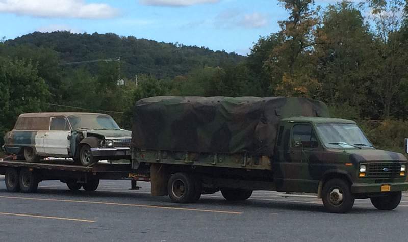

Awesome build I'd love to have something similar it'd be really handy. Biggest pain would be closing the back of the cab up
wheelspinner
3,754
1,539
North Carolina - FINALLY !
Thanks!

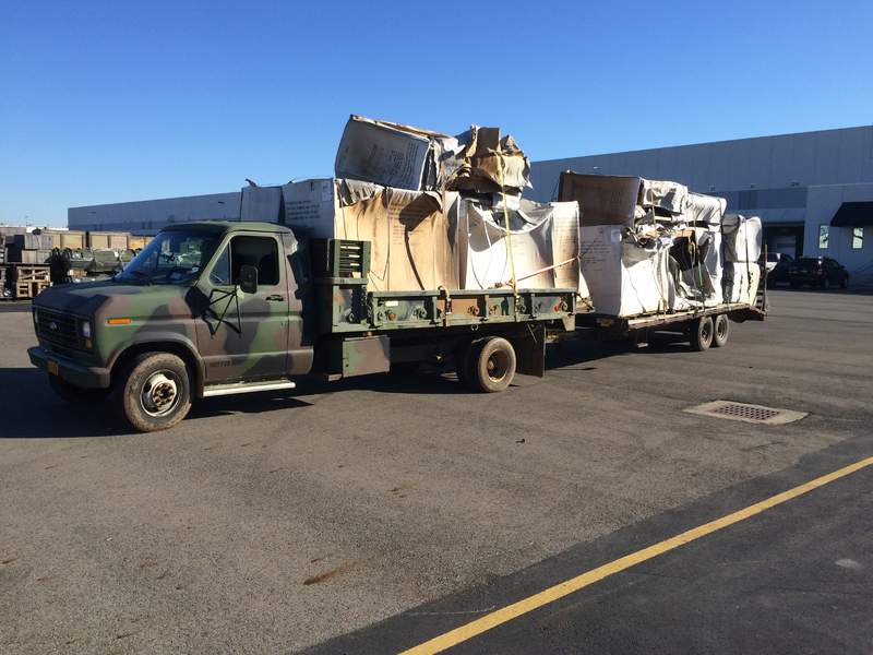

I was going to use a cutoff van back with the roof section still attached. I found this cab back at a commercial scrap yard. Off of a junked UHaul. Really wasn't too bad. The original cut away cab had the flange and even the bolt holes to put them together. Yeah it's def handy.
