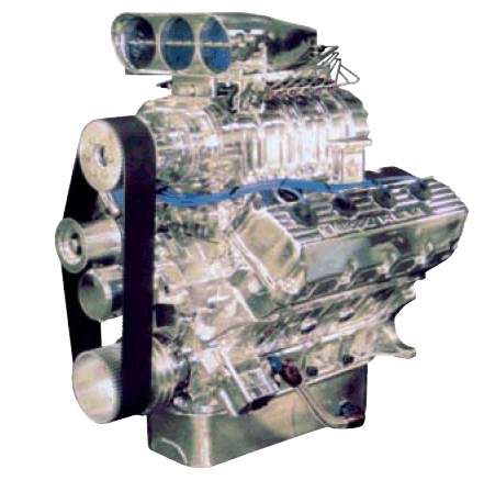

Gunner,
Here's a pic of a generic Super-Charged Engine (Googled "Supercharged Engine" Images).
Using a geared pulley/belt system, to assure NO SLIPPAGE, power is taken off the engine crank shaft to turn the blower rotor(s) in the Turbo to pressurize the intake pressure.
Alternately, a TURBOCHARGED intake system can be (and is on most of our Deuces, etc.) pressurized by harvesting the exhaust gas flow pressure to spin a dual chamber fan. The exhaust side essentially powers the intake side to pressuze the intake air entering the combustion chambers. The turbos were added to the Deuces not for power increase, but to provide a cleaner fuel burn and reduce smoke complaints.
Hope this make some sense. If not, hollar and I'm sure someone can explain it better.
