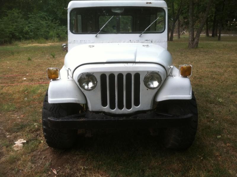

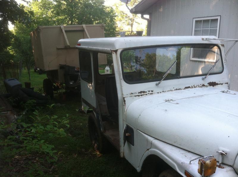

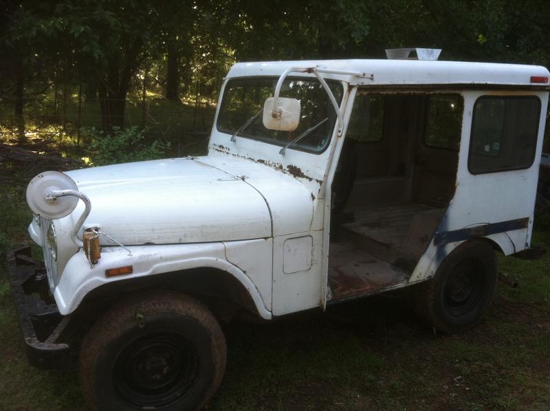

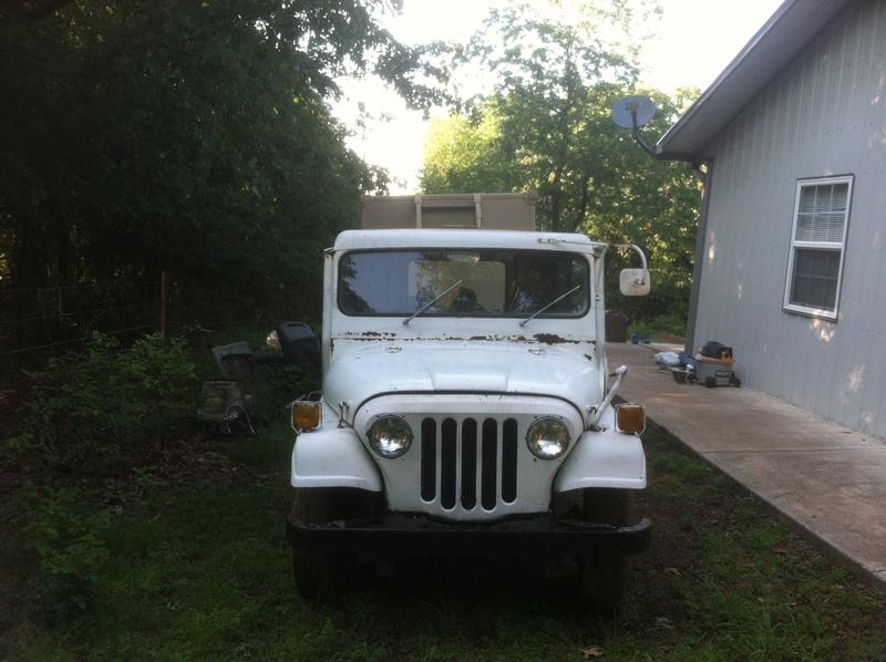

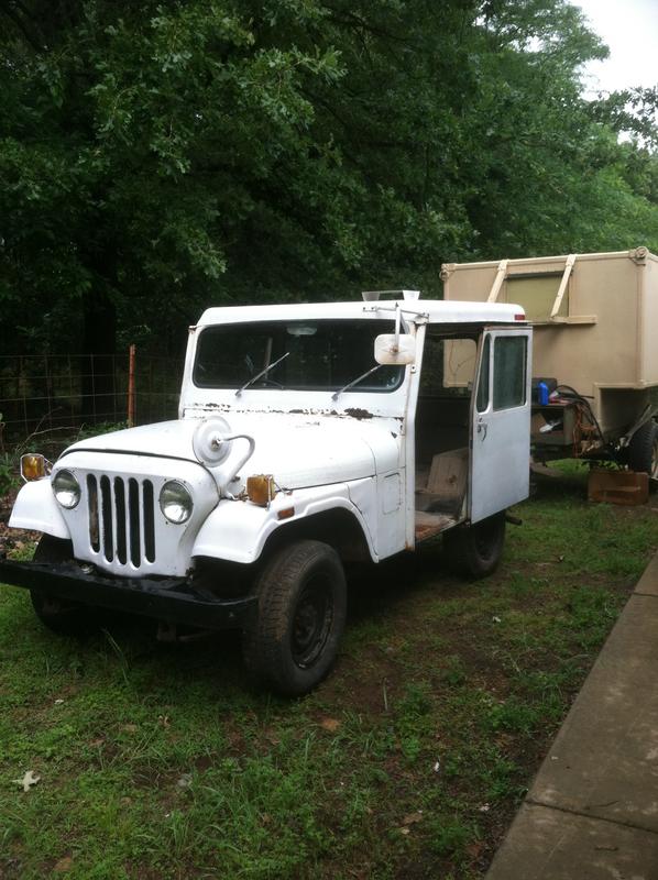

Well its not od green or tan (yet) but i picked this up super cheap. I have replaced all the breaks, switched to a 258 intake and exhaust manifold and a motorcraft 2100 carb, fixed the electrical, and lifted the rear and soon to lift the front. I will be switching it over to right hand drive and adding a bigger alternator and 2 5kw ac/dc converters. it will get 235/85r16 tires with 2 inch spacers and a rapco tan paint job. as well as a roll bar. i will be coating the underside with por 15. i have a good start but the difficulty i have is the doors i think that hmmwv doors will work but one i need the measurments on the doors. (i have looked and cant find them, and 2. i need to source some place to find the doors. with any luck i can find 2 tan front doors i think that will be the closest fit. any help you can send my would be great and mods i couldnt find any other place that this seemed to fit.
army_nurse
203
Fort Gibson Oklahoma
and by the way i plan to pull this in the back of a 923 for trips but my wife doesnt know that yet. Feel free to offer up your advice. this is a budget build but i want it to have a military look. i will be converting it over to left hand drive as well. the body is in good shape with the exception of just under the wipers. i plan on using a m series gauge cluster and aircraft type switches for my misc. off and on stuff. no a/c planned. front 5000 lb winch and if i can find one a 4bt with a 400 turbo trans. but that will be last and only if i can find one cheap. (like that is going to happen) thanks for your input and God bless

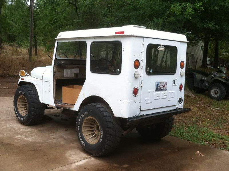

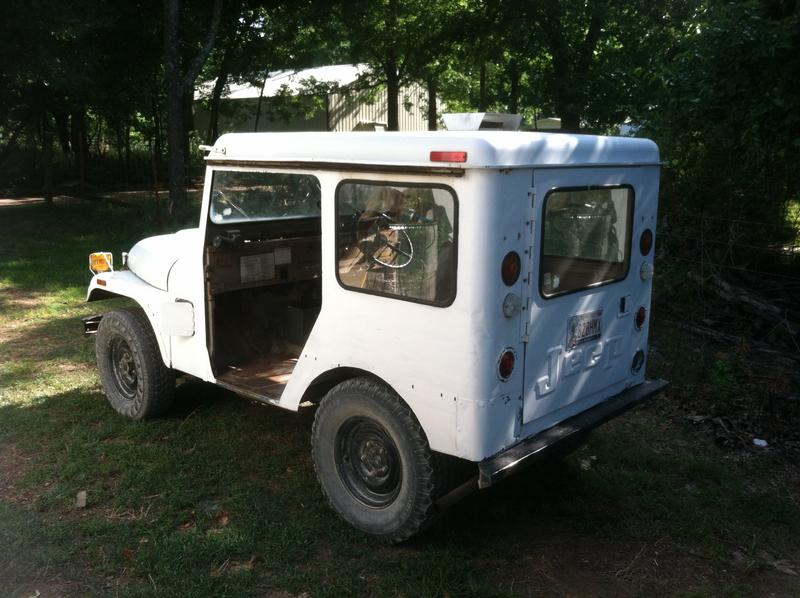

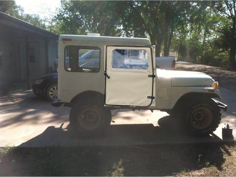

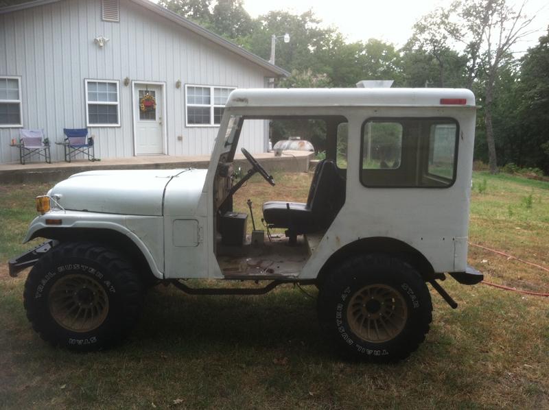

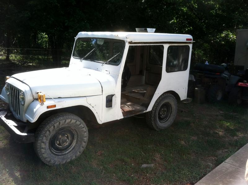

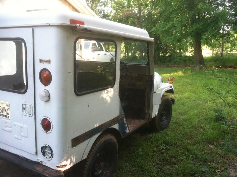

the doors that come on the dj5 are sliders and they run on a track at the top of the door. i took them off, cut off the tracks as well at the front metal pieces and the goal is to get soft doors. the stock doors are very heavy (over 90 pounds each) and rattle as well. not at all the look or function i am going for. you can see in the pics i attached the cutting i have done around the back wheel well, and all the metal i took off of the doors. so far i have taken off over 300 pounds with most of that being the doors. i think it looks more like a jeep should not just a box on wheels. i think the finished product will be nice. and as i said a one of a kind

Ok i might leave it right hand drive. that will save me some time anyway. does anyone know where i might get some hmmwv doors? i also would like to find a set of 5 m151 wheels they are 16 inch and would give it the correct look. i think they will hold the 235-85r16's even though they are narrow wheels. any other mods you can think of let me know. i will be keeping it 2wd however it will get full time posi in the rear via a spool on the dana 44. lots of plans and soon to be working some overtime to have the funds i need to do said plans with. my wife has been way more cooperative with this as compaired to the last m35a2 i had. as i said keep the suggestions up and God bless.

my plan is to run 235-85 r16's they are tall and narrow they are aprox. 31.5 inches tall but only about 8 inches wide. the wheels and tires you see on the jeep now are ones i got off a ford 3/4 ton on the ranch just because the little tires looked odd. i do believe that the 235/85 are similar in size to the 9.00x16's. this will be a mostly highway vehicle with an occasional hunting trip or repair job. the wide tires on the highway tend to road walk as well so they are on the chopping block soon. another of the features i have planed is a pair of 5,000 watt ac/dc converters in a mount under the seat. that will be enough power to run many different power tools and even a small cooler. i do understand that this will require a bigger alternator and maybe a dual battery setup. keep the suggestings and lessons you have learned headed my way, and thank you & 73
I may be severely flamed for what I'm about to type here, but if it were mine, I'd get my hands on some 1/8' aluminum diamond plate and fab up some custom doors on a steel framework and hinge them. The OEM sliding doors just scream "HERE COMES THE MAILMAN!". I'd also be enclined to set the body on a CJ5 chassis with a small diesel. You can't beat a diesel for torque and fuel-flexibility. As long as you don't try to get too intricate with it and follow the "KISS principal", you could have one wikked little demon of a Jeep and it would be super easy to keep somewhat of a "military vehicle" appearance.
