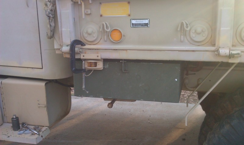

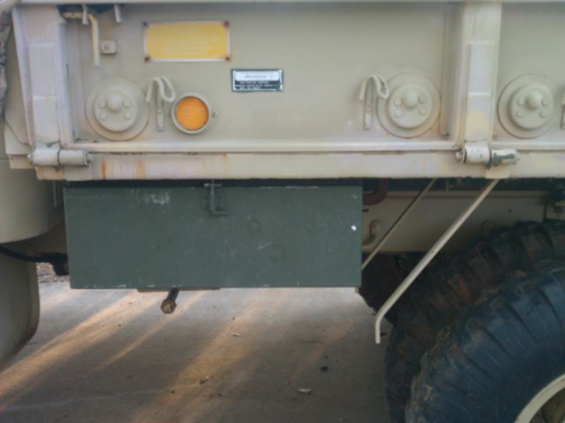

Well, that's an idea. I'll have to see if it will fit above the fuel tank. I don't want to lose my pioneer rack and spare tire carrier.
12,596
1,134
Nope-waaay too tall.
Nothing is available premade, GI or civvy that will fit. I looked. Only idea I've come up is a a way to mount some ammo cans above the tank and make them removable (i.e. some kind of mounting system like sliders or such).

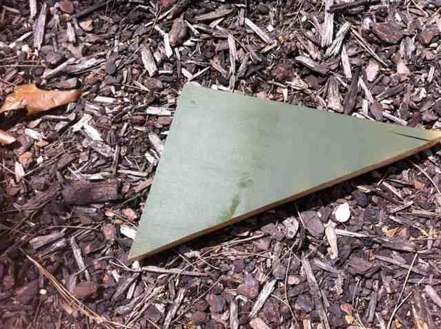

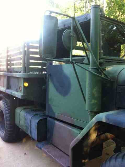

So here's what the comparo between the Rapco 383 and the. Behr 34094 looks like after about 24 hours of drying.
In anything but direct sun, they are the same. In direct sun and viewed straight on, they are the same. Viewed at an angle, the difference in sheen is visible because the Behr is more flat.

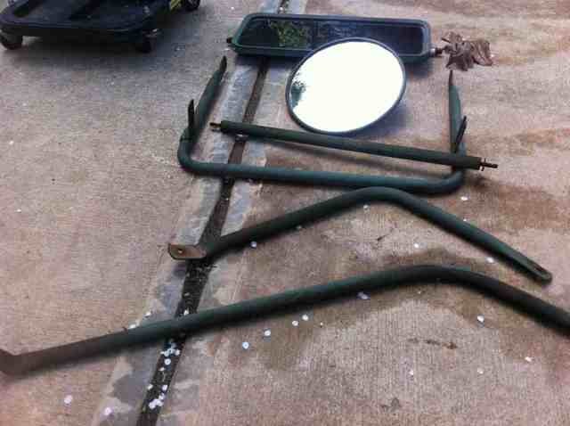

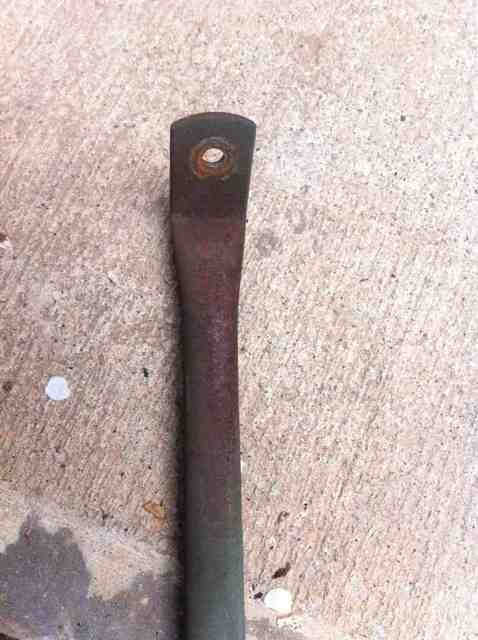

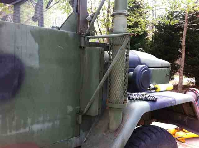

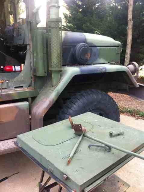

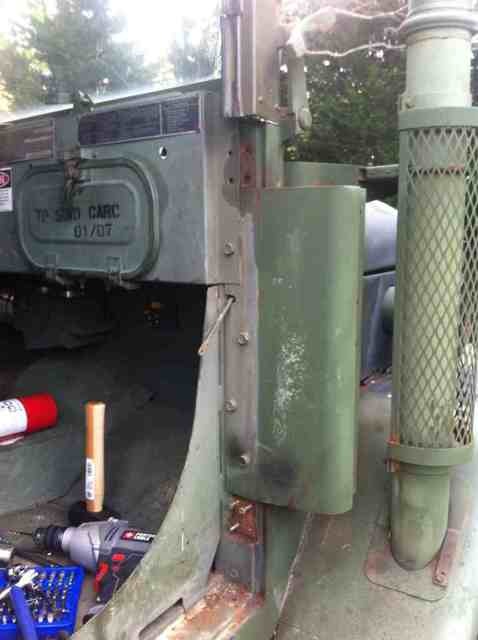

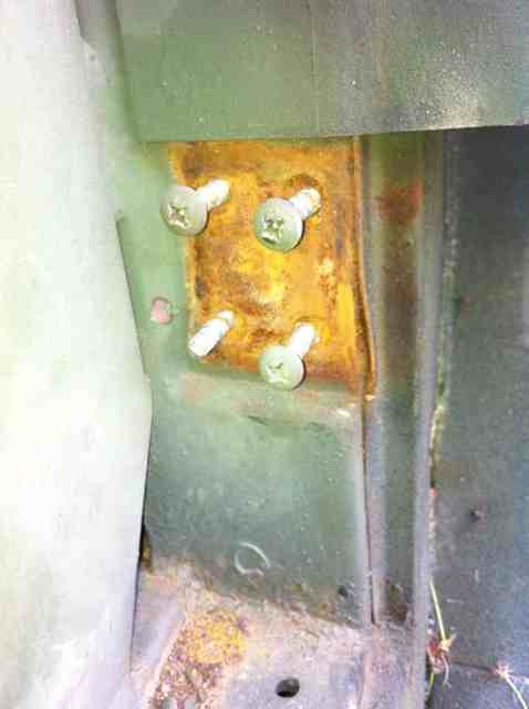

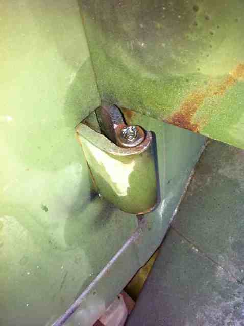

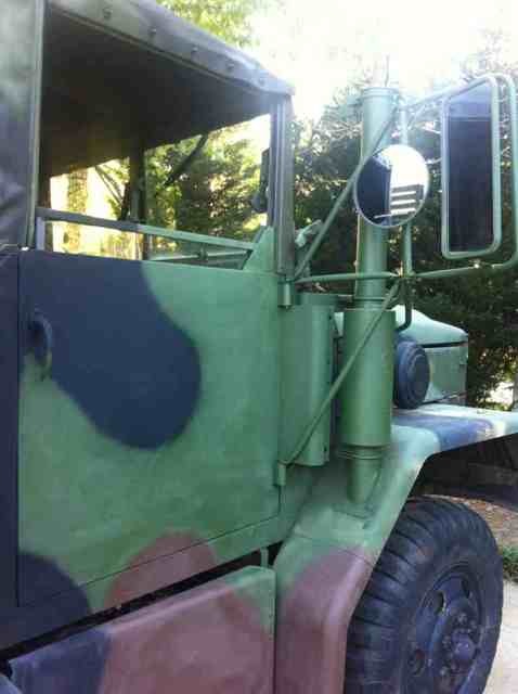

I've started the battle on the passenger side mirror. All of the hardware came off without much trouble except for the hinge bolts. As usual, they are frozen in the hinge. Hope my neighbors don't mind another round of hammering and cussin'!
TMNT
789
Canton, Ga
The passenger side is even worse than the driver side was. I'll have to let the PB soak a while longer and hope I can get these hinge bolts driven out by next weekend.

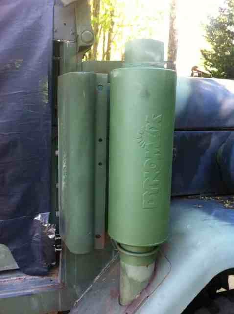

My DynoMax muffler should be here sometime this week. I hope to get the door/mirror finished and get the muffler installed next weekend. Getting the muffler installed with the mirror frame off should make that task a bit easier.

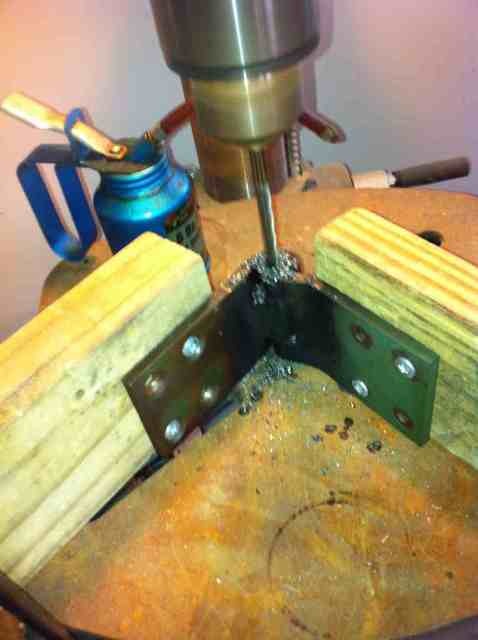

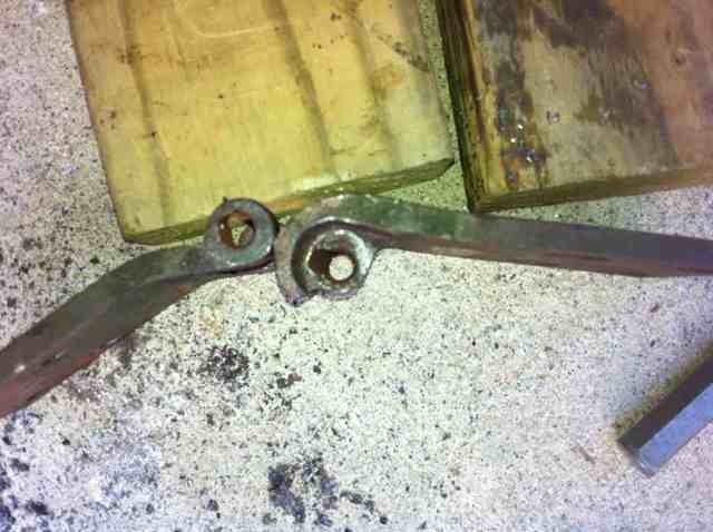

Well, ain't this a fine mess! The passenger side hinge bolts are putting up a real battle, but its not a battle that I'm going to lose. I was worried about bending or breaking something else while heating and pounding on the hinges, so I took the whole door off so I could get the hinges in a vise or maybe even a press.
I had one hinge screw give me a hard time but I was finally able to get it out with vice grips after breaking the head off of it.
I'm sure I'll need Soldier B to get that door back on.

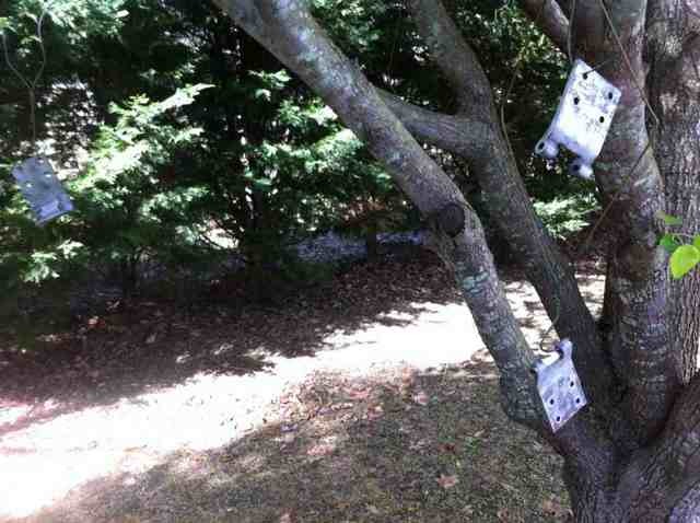

I dropped the door hinges off with a friend that has a hydraulic press. He's going to try pressing the bolt/pins out. I'm hoping a lot of steady pressure and a bit of heat will do the trick.
Just as a backup plan, I checked on the price and availability of replacement hinges. They range from about $45 to $50 each new! I'm hoping the original ones can still be saved.
Yep, I checked. The box is a good 3 inches too tall to fit above the fuel tank. It's a decent space though for a custom box. I work with a few fabricators. I think I'll see what they can fab up for that space.

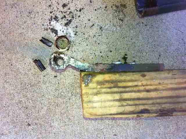

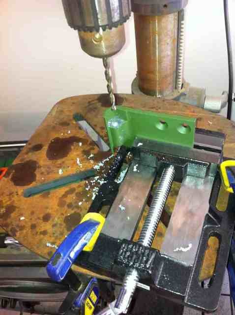

I found out this afternoon that a 12-ton press maxed out wouldn't even budge the pins. I'm going to try drilling them out with my drill press. If that fails or damages the hinges, then I'll finally give up and buy new hinges.

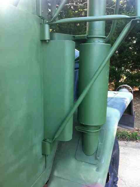

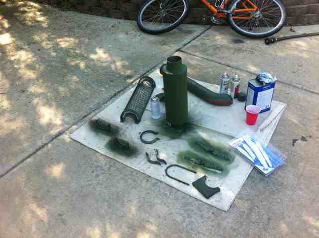

Weather is very nice today after the stormy Thursday night. I took the afternoon off and worked on Betty some more. I needed something low-stress so I didn't fool with the door hinges and saved them for tomorrow.

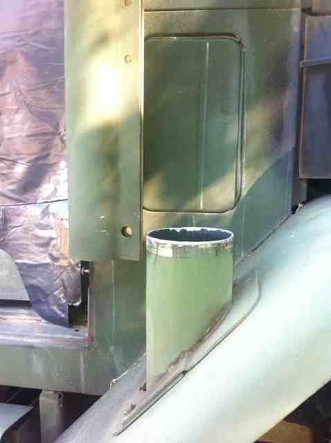

I started installing the DynoMax muffler instead. I disassembled the stack, did some trial fits, and cut off the J-pipe. An angle grinder with a cut-off wheel made short and easy work of that. I think I'm really going to like this upgrade.
I'm not going to use the turn-out stack and I'm going to install a flapper instead. I've always liked stacks with flappers and this will get rid of the jug.

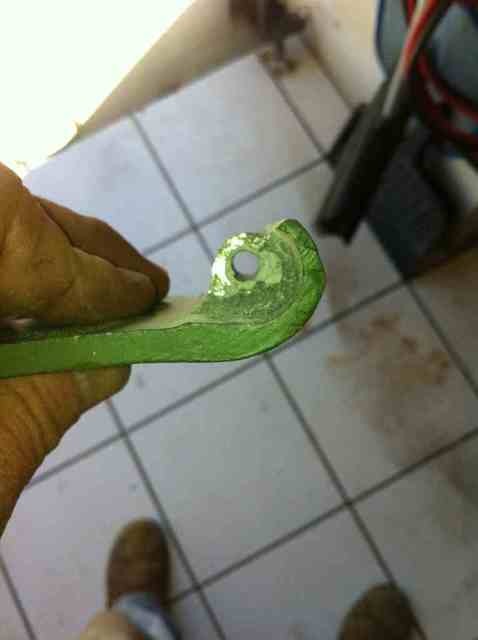

I made a mistake and ended up with a too short exhaust stack. I'll have to pick up a new piece of 3-1/2" exhaust pipe to get the stack cut to the right length. I like the way it sounds now.

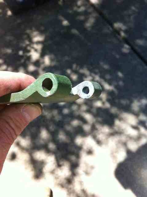

I also managed to get the door hinges drilled out and separated. The drill cut into one of the hinges and I'm fixing that with JB Weld, but I should get the door and mirror completely reinstalled today.

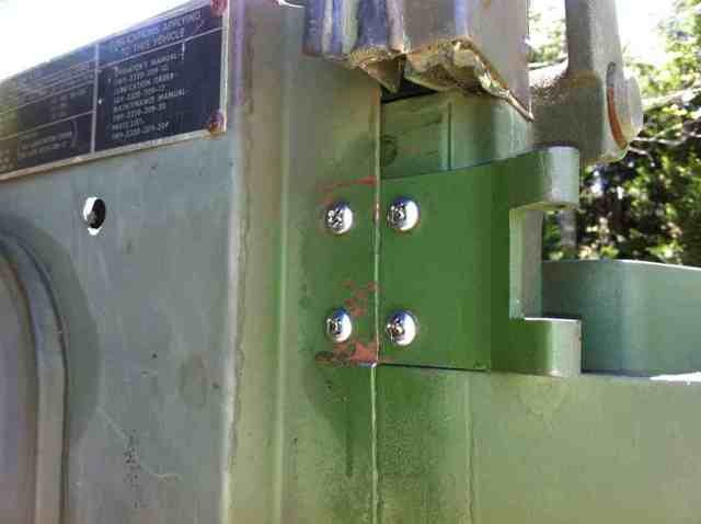

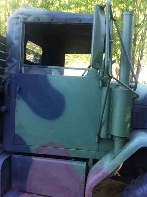

Slowly but surely. Sat down here for a break and a glass of cold rum. Ahhhh!
The door is back on. Here are some photos of the progress.

Finally got everything put back together and looking good. I like the exhaust note of the new muffler but now I hear all kinds of other rattles and squeaks that need fixing. Really pleased with it overall.

I discovered that I do not like the exhaust flapper as it rattles and clangs way too much. Above 2K the exhaust note resonates with the flapper and it sets up a terrible high frequency rattle/squeal. The sound transmits through the pipe so that it sounds like its coming from under the passenger floor. That noise combined with the 5th gear whine was awful.
I took the flapper off and it's much, much better. So, I'm going to convert it back to the original stack with the turn out at the top. Retaining the muffler of course.
