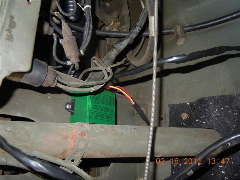

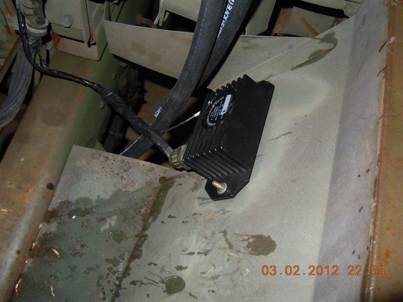

Well, looks like I'm buying a new flasher relay. I fixed the wiring, cleaned the bolt hole locations, verified there was good supply voltage and verified a good ground/return path and the relay won't flash. I get a constant "ON" with the turn signals activated. The relay module is cracked and the mounting ears broke off. I tried to baby it back to life but no dice.

There is a good thread somewhere that details a way to troubleshoot the flasher so you can verify it isn't a ground issue.
If you can't find, let me know.

I'll search for it, Clinto. I'm curious if I might have missed anything. I'm certain it's the solid-state relay unit. I checked resistance from the ground point on the fender to the body, frame, and engine block and the return path is solid. I ran a temporary ground jumper to the engine block and the flasher still won't flash with left, right, or hazards on. The lights come on and stay on instead of blinking.
The supply voltage is good (25.2V) and the continuity through the turn signal switch to the lights is good.
I'll let you know what else I find.

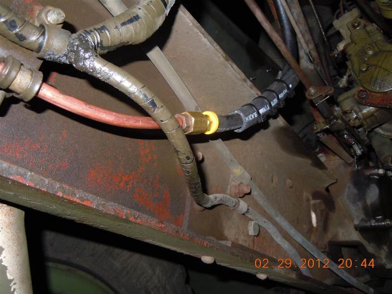

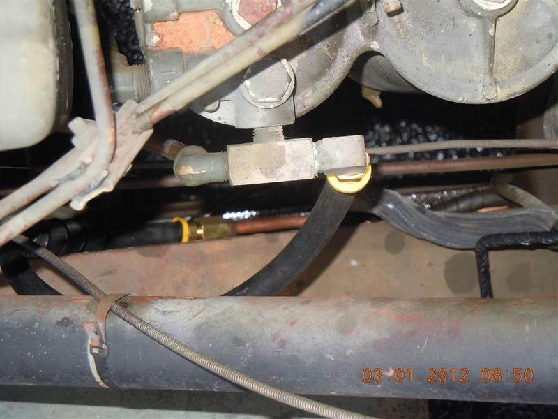

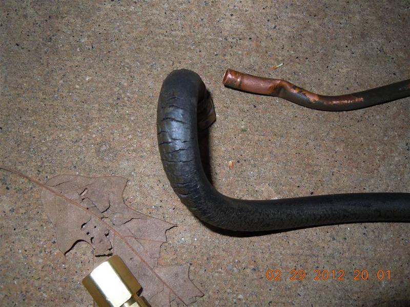

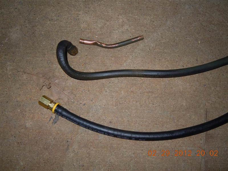

While I'm waiting for the new turn signal relay to arrive, I fixed the leaking fuel return line. At some point in Betty's past, something got tangled in those lines and pulled a pretty severe kink in the copper line and the rubber hose was cracked and dripping fuel. That hose was tagged 5/72 so it's been on there a while. I got a new one made at Royal Brass in Woodstock for $21. I cut the copper line back and used a flare union to add a new piece of copper tubing back to the original stopping point. The new hose connected perfectly and the leak is no more.

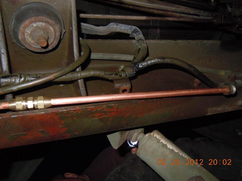

So, here a some photos of the the fuel return line repair from last night. The original rubber hose and the dented/crimped original copper line are in the first photo. It was leaking from the connector where the rubber hose joined the copper line.
I drove the truck to work this morning (about 15 miles) and no leaks.
I need to degrease the area where the leak splattered fuel around and I think there's another small leak somewhere above this point that I haven't tracked down yet.

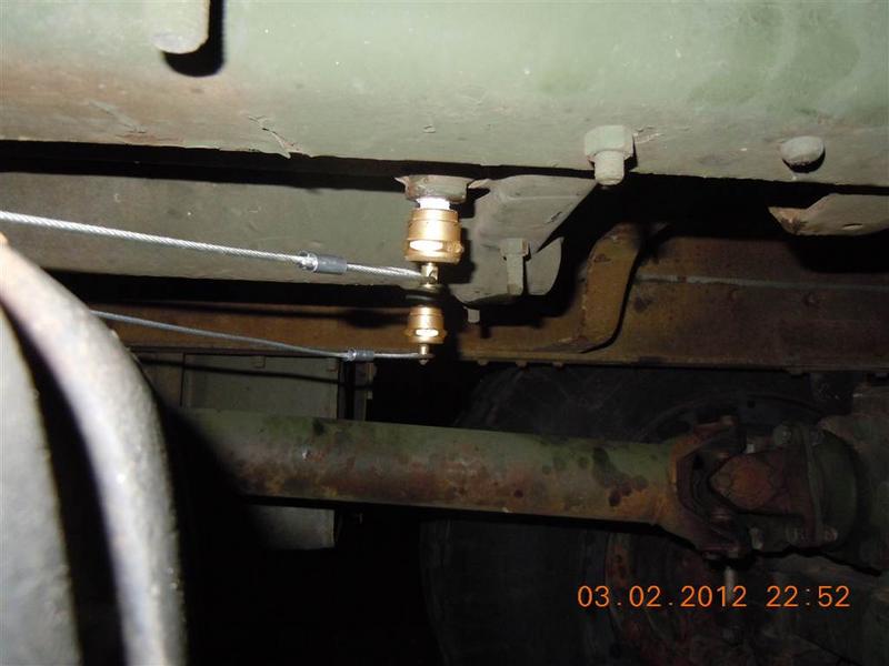

Before the weather deteriorated, I got the remote air-drain valves installed, though I still have some work to do to be happy with the cable securing and routing.

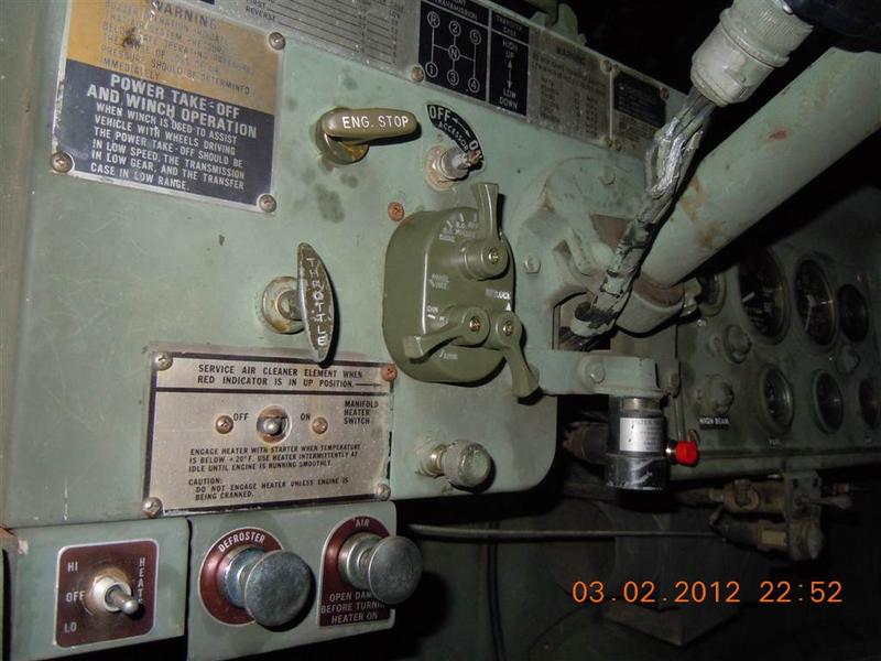

I also swapped out the headlight 3-lever switch with the new one and re-painted the Master Power switch. Its drying in the garage and I'll re-install it in the morning.
And finally, I swapped out the directional signal flasher relay for a new one and it works great. I have turn-signals and emergency flashers again.

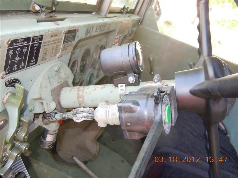

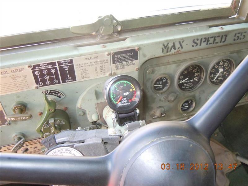

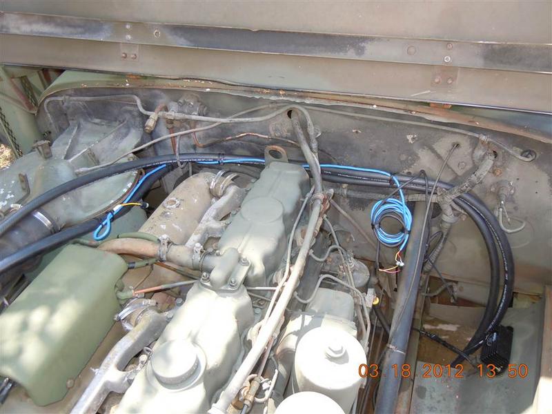

I've got the pyro mounted and all of the wiring pulled. I just need to connect the wiring now and the drill and tap for the temperature probe. I'm still undecided as to whether I'm going drill and tap the exhaust manifold, or have my neighbor drill and weld it into the turbo down pipe. Maybe I can get that sorted out tomorrow.
After I get the pyro installed, I plan to do some test drives to see how hot the EGT runs as it is setup now. After that, I plan to slowly turn the IP up to see what I can get out of her without getting too hot.

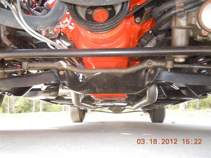

Went over to a buddy's house to check out his new 1970 Chevelle 396SS that he just picked up on Friday. Very nice clean car.
I didn't think about it until now, but I should have gotten a photo with Betty and the Chevelle together. They're both the same age.
Anyway, here's a few photos from the visit. I mixed in a few photos of my incomplete pyro install. I still need to make the connections to make it work.

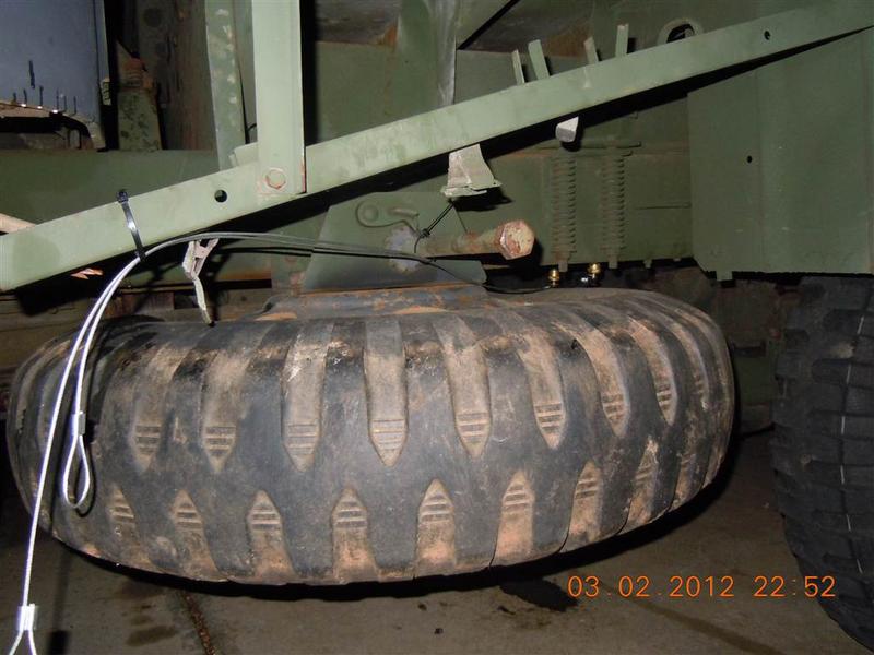

Had a good time today with Betty. I took my neighbor up to Lowe's and hauled a load of 16 foot lumber back for him. That 12 foot bed is nice to have.
After that I took my son and his buddy to town for a late lunch. My son loves those trips and it was his buddy's first trip in the Deuce. On the way back we took a detour on a dirt road and played just a little at a construction site where there was some dirt piled up.
I learned that my spare makes a heck of wheel chock! I climbed a steep bank a bottomed out when the front tires crested the top. It was just a soft bump into some soft dirt but it dislodged my spare tire.
After I backed down the slope and started forward I heard a really nasty scrubbing noise and the truck definitely felt like it was dragging something. My mind immediately jumped to things like broken springs and dropped dog bones, but it was just my spare tire stuck under the mid-rear tires.
It didn't break anything so I just winched the tire back into place and made very certain it was secured.
Clinto, I think that's how the damage to the original spare tire carrier and pioneer rack happened. If the spare drops, the rear tire immediately climbs up on it and of course it pulls everything else down with it.
Fortunately I noticed it within just a few feet and the ground was loose so the tire slid a bit. Lesson learned for me, make double sure the spare tire is securely in place before every trip.
I never considered that, but it makes sense.
Is your carrier ok?
TMNT
789
Canton, Ga
Is your carrier ok?
Clinto, yeah it's fine. I stopped as soon as I heard/felt the problem and it was a very low speed event. The damage was limited to getting dirt and scuffs on my freshly cleaned and painted spare!
