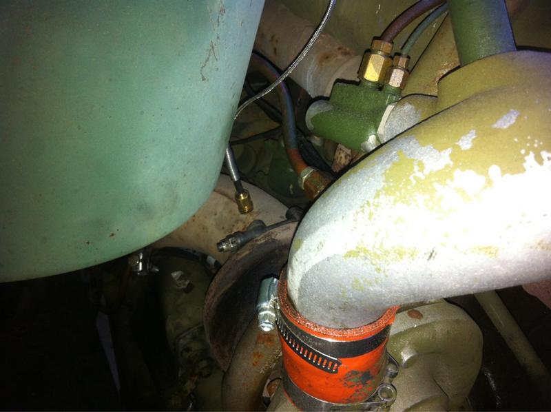

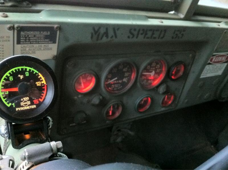

So, my poor son came down with the flu on his 11th birthday. In between trips to the store for stuff for him, and cleaning up the barf, I finished my pyro install and it works!
The problem now is that I'm not quite sure what it's telling me. I installed the probe after the turbo about 2 inches downstream from the turbo exhaust port.
When I fire up, it pretty quickly goes to 200 degrees and will rise to 300 within a few seconds of reving it up to 1500-1800 RPM.
It settled in to 300-350 degrees on the way out of the neighborhood in low range at 1500-1800 rpm.
A minute or so of accelerating up to 50MPH and it went up to 600-700 degrees and it stays in that range until I start climbing a hill. On a couple of different long climbs while maintaining full throttle but gradually losing speed down to 40 MPH, and once downshifting to 4th and maintaining 2000 RPM or so, the EGT hit 800 and once up to 850 degrees.
I don't know what the EGT should be 2 inches downstream from the turbo under any of these conditions. I read somewhere that downstream of the turbo will be about 300 degrees cooler than the input of the turbo, but I can't find that post again now.
Does that mean that when my pyro sees 850 degrees, that my actual turbo inlet temp is 1150 degrees?!! I'm trying to figure out if I have room to turn up the IP but these temps have me worried about that. I'm thinking that 1000-1100 degrees at the turbo inlet is the max that you would want to see.

Step 1. Turn it up until it melts a piston/headgasket.
Step 2. Turn it down 1 flat.
Step 3. Tow it over here and we'll fix it.
Step 4. Profit!
Not that I would mind the visit Clinto, but I'd rather it be for a new winch and not a new motor! I'm not turning it up until I'm sure of the EGT operating range. That being said, it was a mistake to put the probe downstream of the turbo.

I put an EGT probe in my manifold last weekend. I did not put two in because I dont have two, and I dont think its all THAT necessary. I tapped mine about 2 inches above where the turbo and mani meet, and its in the rear head pipe. I know this is not gonna give me a full accurate EGT reading for the whole motor, but it should be enough to give me an idea. I dont know if its true, but I have been told the back half burns a little hotter then the front anyway, so if that is true, then Im not worried about it.

After some additional research and reading, I've come to believe that the exhaust gas temperature difference after the turbo is a max of 100 degrees cooler than the pre-turbo temperature. In a long steady pull, the post-turbo temperature eventually matches the pre-turbo temp. Thanks to several other forum members for the very helpful info!
That means that with my 850-875 degree long-pull temperatures, I should be able to turn up Betty's IP a couple of flats. I think I'll try that today.

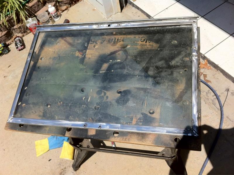

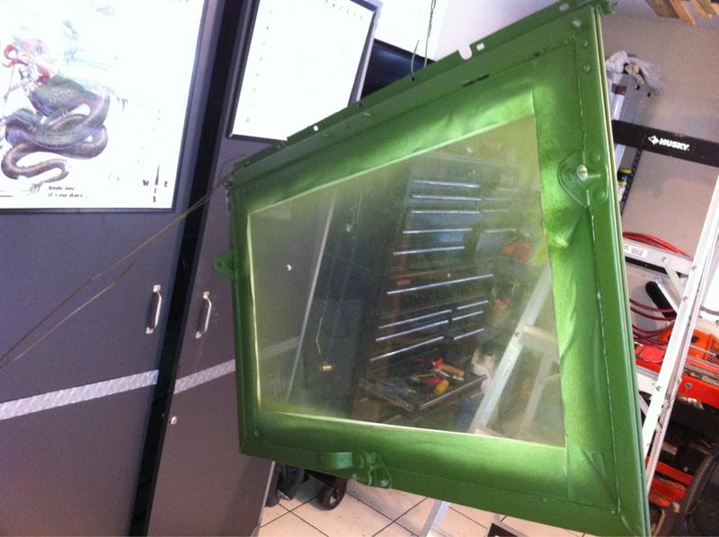

I finally finished stripping, cleaning, and repairing the inner windshield frames on Betty. They weren't in horrible shape, but each frame had rust in the lower corners so I thought I would get that taken care of before it got worse. In the process, I replaced the rubber seals and I'm please with the results.
I also stripped the area where the windshield meets the cowl and got all of the rust out of there. I found a couple of small holes through the cowl. I fixed those with a 2-part epoxy. Welding is not one of my skills (yet).

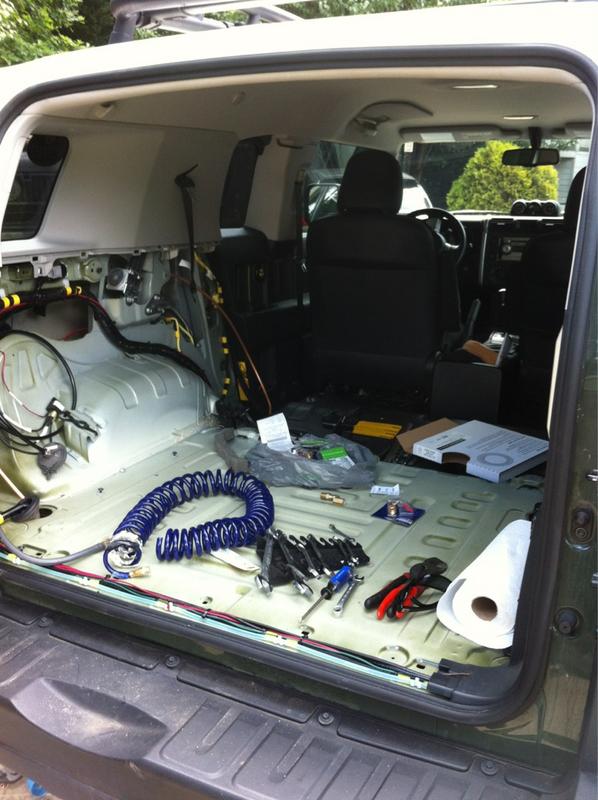

At the same time I disassembled the interior of my Toyota FJ Cruiser to track down and repair a broken air line in my on-board compressed air system. I ended up completely replacing and re-working the air lines from both compressors. The Cobalt PVC lines just weren't holding up to the nearly constant 150 psi. I put 250 psi rated stainless steel braided lines in. That should hold it!

Here's a couple of photos of the drivers side windshield frame in progress:
I used a paint stripper called Aircraft Remover. It worked extremely well on the old CARC. Twice through with that, a few minutes with a pneumatic sander loaded with a Scotchbrite pad and then Naval Jelly before rinsing it clean and drying it with compressed air and sunshine. I wiped it down with mineral spirits, primed it with etching primer and finished it with Rapco 383 green.

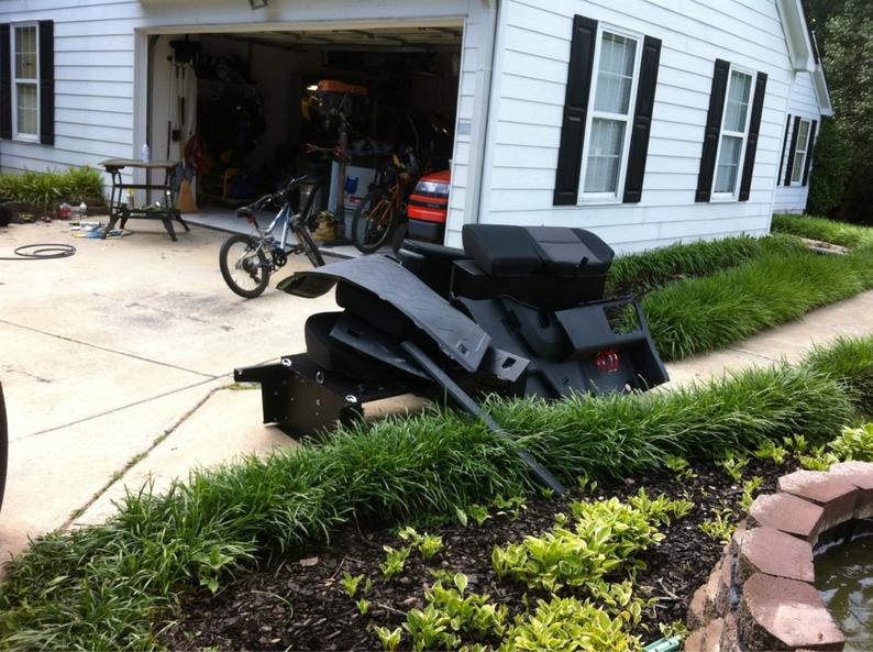

This is the back of my FJ while fixing the bad air line. It gave me something to do when I was waiting for the paint stripper to work on the frame and for the paint to dry.
That pile is the interior of my FJ. Seats, floor, wall panels, etc.

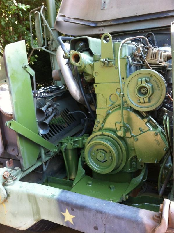

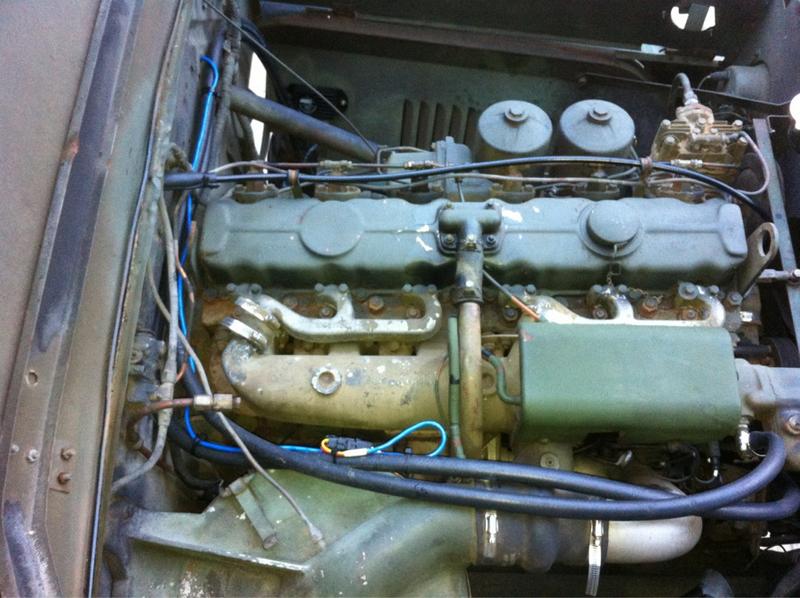

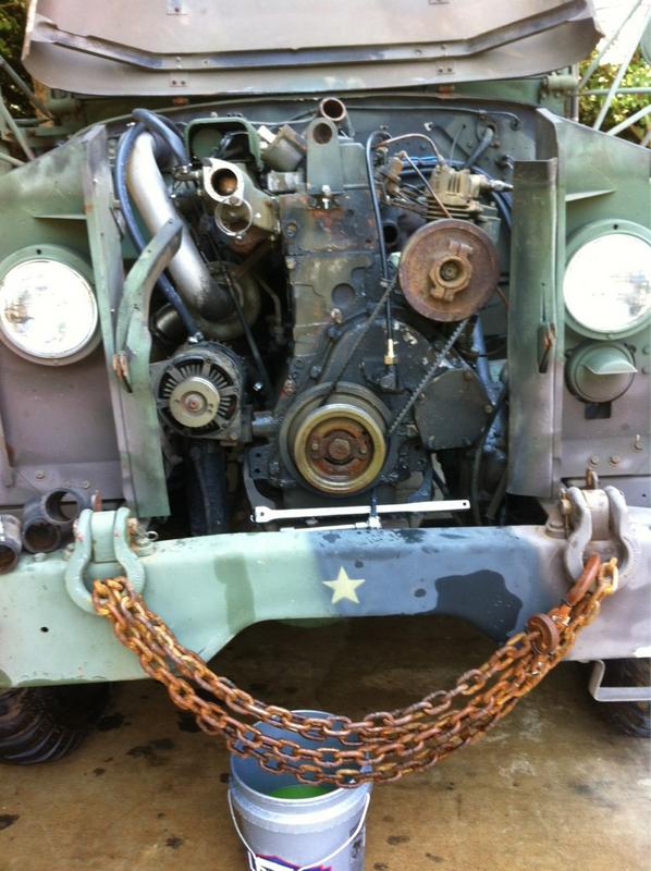

I'm working on the coolant leak that showed up last week. Of course, that task has expanded into a major project. New water pump, new belts and hoses, new thermostat and gasket, reconditioning the radiator, and a good cleaning and paint. Oh, and since I spilled coolant into the oil filter bases, an oil change!

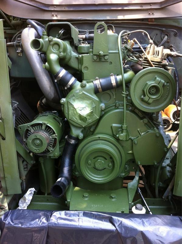

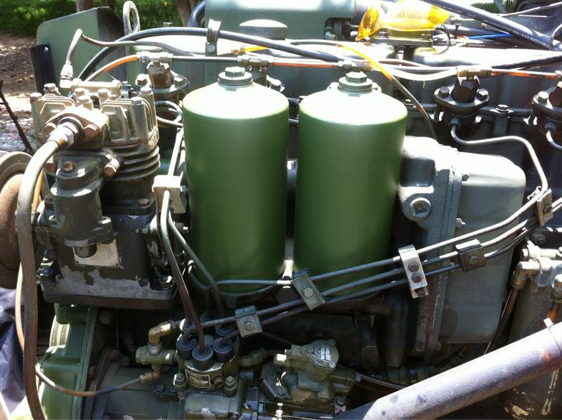

Making good progress. I got her cleaned up with Krud Cutter and a pressure washer. After using a small brush and a pick to get into the nooks and crannies, I washed it down with mineral spirits.
I used Naval Jelly on the rusty spots and then primed it with Rustoleum engine primer. The top coat is Rapco 383 green.
The new water pump, hoses and belts are ordered and hopefully I'll have them by next weekend. The radiator is going to Marietta Radiator on Tuesday. I've got the coolant, distilled water and fresh 15-40 ready to go in as soon as I get her reassembled.
I've got all the nuts and bolts soaking in phosphoric acid and they'll be good as new in a few hours.
It's not a complete rebuild, but I'll feel confident in the cooling system, belts and hoses when this is done.

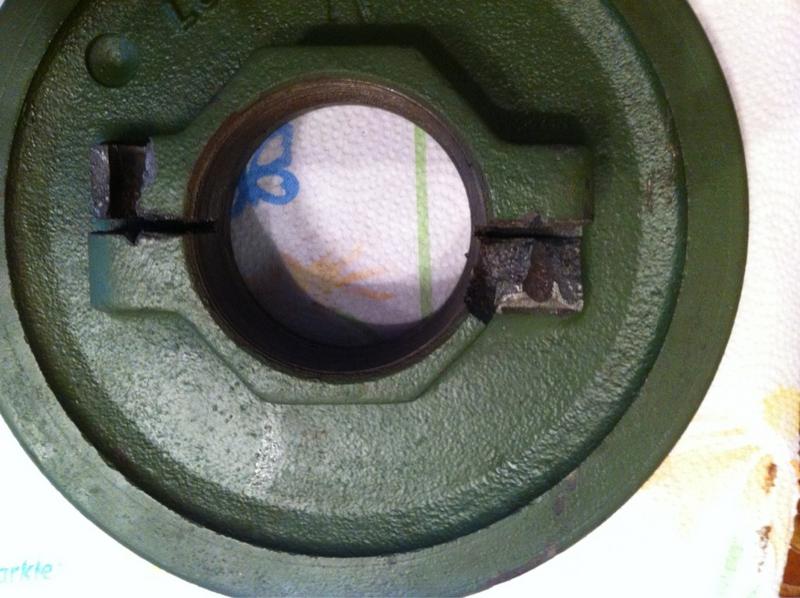

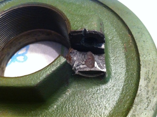

So I thought I would go ahead and break the compressor pulley loose with my new compressor wrenches from C&C. The wrenches work great and they withstand quite a lot of abuse. The pulley on the other hand, doesn't like abuse much at all.
One of the bolt bosses cracked while trying to get the pulley freed up. After that, I used an air hammer on it to get it loose and broke it some more. I finally got it off but now I need a new one.

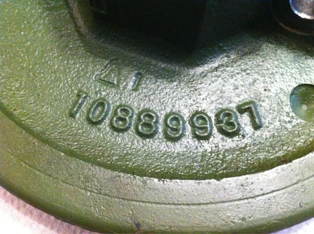

Here's a couple more photos of the damage. The chunk of the threaded portion thats missing was seized to the compressor arbor. There's some minor damage to the threads on the compressor, but it cleaned up pretty well. I applied a bit of anti-sieze and the outer pulley will now easily spin on and off. I have to find a new outer pulley though.

I saw an NOS pulley on Ebay for $55. I found and purchased one from Saturn for $22.50. It looks like next week will involve several late nights of reassembling as the parts arrive.
