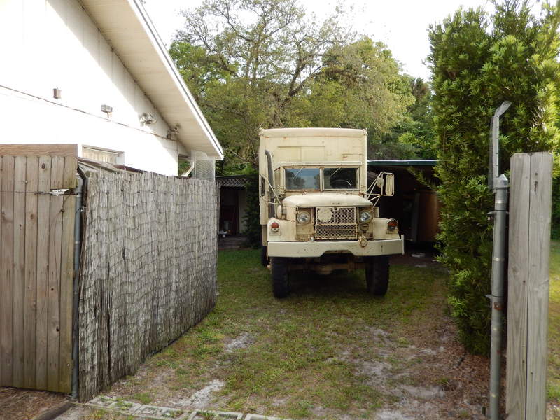

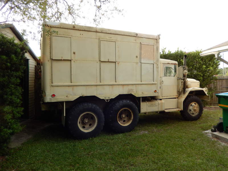

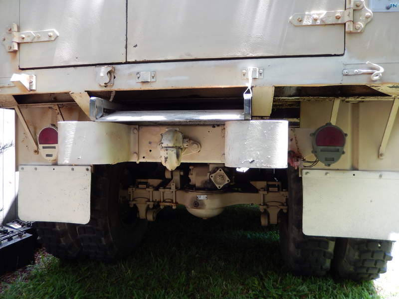

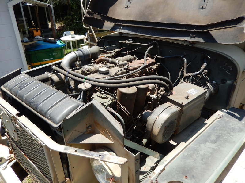

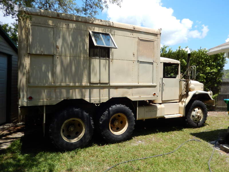

Well I've had my new truck for a little over a week now, starting to get to know it. In pretty good shape I think, has a few kinks. Mainly no brakes! Drove it home 146 miles from High Springs, FL to the Orlando area. Sure got good at downshifting. Runs very well on the highway, the 11 new radial 44' tires sure helped that. The rearmost axle brake line is disconnected/capped off, and I have no boost from the airpack. Have taken the airpack apart twice now, I see nothing wrong with it. Master seems good as well. Have a hard pedal with what I'd say is at best 20% braking ability. Picked up a rear brake line from RAYZER ( Ray ) yesterday, planning on installing it this week. But will still have the airpack issue. Any idea's, please advise. Overall, I am pleased with the truck and I feel like I will enjoy it for a good while. Have learned a lot from the posts on this site, THANKS GUYS!

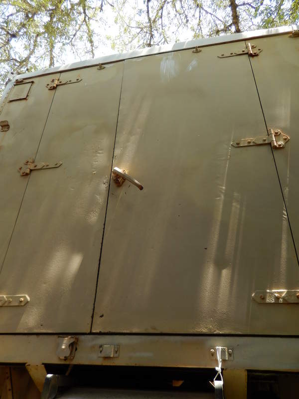

Looks good Scott, and looks like someone has already started rehabbing the box for you too! I had my heart set on an M109 for my first MV, but opted instead for the M35 so I could crew cab her then build a custom camper.
As for the braking, does it get any better if you pump the pedal at all? Have you bled everything using a power bleeder? If not, I'd get that rear line replaced, bleed everything out really good and go from there. I'd be looking on the back side of the tires to see if a wheel cylinder is possibly leaking, or maybe even breaking down one wheel at a time too to check the condition of each. It's a simple system really, but can certainly cause lots of heartache.

I'll be getting into the brakes in a few weeks. Have pulled the airpack twice now and checked, NPF. Bled out well, pumping makes no difference. Have no boost. No leaks found. Will be repairing rear line soon. Also rebuilding wheel cyls. so I know their condition and to clean out the DOT 3.
