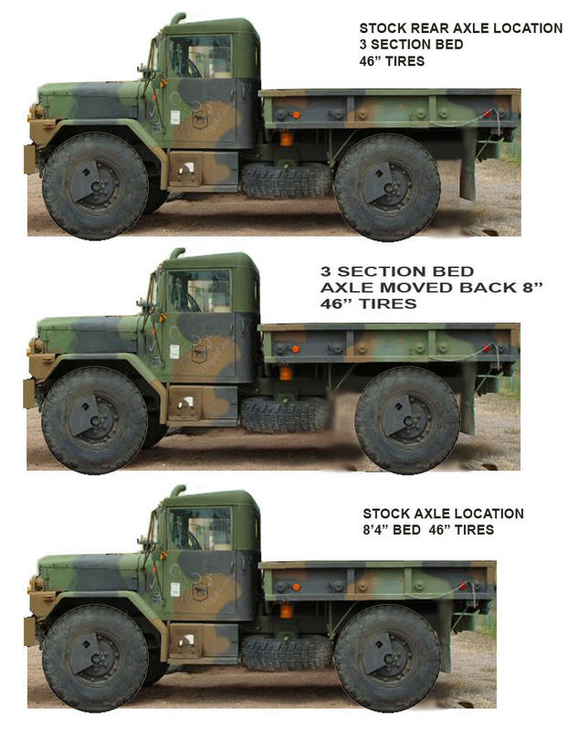

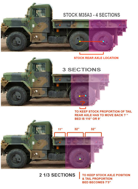

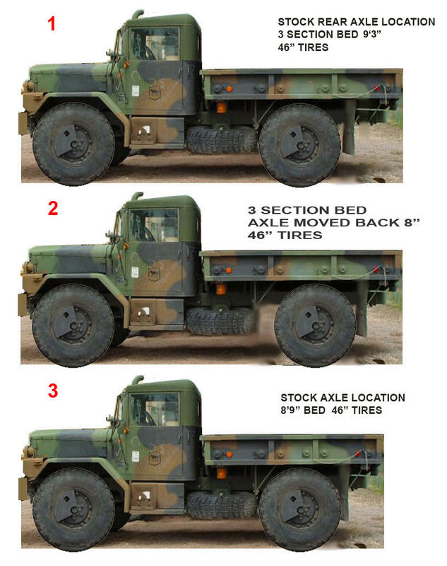

LOOKING FOR OPINIONS:
alright guys, check out this mock-up. the question is... keep the 1st rear axle in it's stock location and shorten the bed to roughly 7'... or move the remaining rear axle back about 8" and proportionally section the bed which is about 9' ?? i'm not going the m105 route, because i need the flat cargo space which the m105 wheel wells cut into.
if you make a 3 section bed from the stock A3 bed, and use the stock remaining wheel placement, you end up with too much frame and bed overhang past the wheel in my opinion. if you shorten the bed to 7' which helps retain the original tail approach angle, you obviously lose 2' of very useful cargo space. on los angeles streets, 2' makes a huge difference in traffic and narrow alleys.
this one is a tough call !!! right now i'm leaning toward the 9' bed, moving the rear axle back about 8", dealing with the added issue & cost of lengthening the drive shaft, having just a slightly longer truck. longer truck would be more stable. shorter truck would give better off road performance.
decisions decisions....

FINAL DECISION TIME:
3 OPTIONS:
1. 3 section bed, 46" tires, 1st rear axle in stock position
2. 3 section bed, 46" tires, 1st rear axle moved back 8"
3. 2.75 section bed is 8'4", 46" tires, 1st rear axle in stock position
the reason for moving the 1st rear axle back would be for maintaining the rear approach angles and tail proportion. longer wheelbase should also make the truck more stable.
with the 8'9" bed the rear axle doesn't have to move in order to keep the stock tail proportions.
but cargo wise, the difference between 9' and 8'4" is huge when loading things like plywood sheets.

Hey Exitnoone, I must say that I'm swaying more towards option #2 myself. I think with the axle pushed back the 8" makes a world of difference. I found these two Red Dot systems. I talk to the guy in the first one and he was pretty cool. He explained to me how it would mount on the M35 and with us having the M35A3 we would need the serpentine belt one, which he has. He stated that it's the complete system ready to be bolted up and go, with all the hoses and stuff needed. Anyways, let me know when the drive is going to happen.

can you tell me why you're liking the moved axle better ? my issue with moving the axle is that the stock bed at 3 sections becomes off center to the axle. also, it's an extra $400 for the longer drive shaft... however, moving the axle back allows the stock rear approach and tail proportions to be kept correct. i'm wondering if the truck would handle sloppy in the back with the shorter wheelbase. i doubt the additional 8" or so of bed and frame past the stock axle position are enough weight to make the rear of the truck sloppy. it would take about 2,000 pounds past the rear axle before you could really feel anything (experience from driving a stake bed for work)
here is one more comparison. all i did was move the mudflap closer to the wheel in the top rendering... much different look.

Few things. I think the 9' bed look more proportionate. Each section of bed is 3' so natually it looks well balanced when done at 9'. Cargo capacity. You would have a better balanced truck for hauling cargo if the rear axle centerline is behind the centerline of the bed. Even stock deuce have the trunion axle behind the center of the bed. If your bed was completely full of stuff that was of uniform densiity, the more you load it the more weight (incrementally) you would put on the front axle. If the axle was forward of the bed centerline, the more weight you added would actually decrease weight on the front axle negatively affecting control. Bed length should determine axle placement.

RECOVRY- thank you for the tips and hints. i was still going back and forth between the full 3 section bed, and the 2.5 section bed. the difference is approximately 1 foot. all your assessments are what i was coming up with as well. load stability, utility, etc. first of all i have to say i don't want to cut it down at all, because it is practically a perfect A3. but in los angeles, it's just not going to work on city streets. and with that in mind, i ended up going with the stock wheel position and the 2.5 section bed. i instructed the guys at eastern surplus to cut the bed down to 3 sections, and then cut the center section right in the middle. this way when it is welded back together, the bed will still look perfectly symmetrical, retain it's 2 tie down hooks per section, and be centered over the rear axle. the biggest advantage is turning radius and handling. weight and shorter over all length are obvious advantages also. being able to register it with a lower gvwr and one less axle will make a huge cost difference in this pansie ruled state too.
something else i was highly considering with the longer wheelbase- when moving the rear axle back, was the greater potential to high center the truck while offroading. when the rears are moved back, usually by about 10", the 46" tires should offset the longer wheelbase and make the proportions almost like stock. it's about 1:1... but moving the rear axle back under the stock bed would just put more load on the font as you mentioned, and uncenter the axle to the bed, leaving more underbelly exposed.

CycleJay
1,433
Marietta, Ga
Hello,
With all due respect, No offense intended.
Do NOT bob the truck, respect the original design for its usefulness, and leave it
the orginial length.
I do not have one of those trucks yet.
But when I do, I am going to keep it stock and original.
I do not understand why some people are so obsessed with "bobbing" those trucks.
If you want something with that short of a bed, why not save your money,
and buy a pickup truck.
Or if you still want military, go with an M880, or M1008, etc.
Just my $0.02 cents.
Have a good night,
CJ

The A3 is hard to get and pretty rare. I would not bob it, but would have rebuilt and bobbed an A2. However, your truck and $$ to spend. Keep the pics coming, make it special, really special, if you do bob it, so it is not just another bobbed deuce, considering it is the A3. For an doing that with A3, it ought to be done so it's something that makes CXT owners cry.

CYCLE- no offense taken. in my thread, i've outlined some of the various reasons for why i need to bob the A3... however, in order to make everyone happy, including myself, and because i'd also like to have an unadulterated A3, i think i'll just buy another A3. you may be jealous-er now.
i already have an 18' gmc 6500 stake bed, but it's not an off road truck by any means. driving that thing through scrap yards on 4" uneven pavement with 10,000 pounds on the bed doesn't allow you to drive any faster than 5mph without tearing the truck apart. as strong as a 6500 is, once weight is on it, you have to drive like you're carrying a load of glass and eggs. the A3 is going to have a specific purpose in my business. 880's and 1008's in the COTS plan were discontinued why ?
because they didn't have the sack to match deuces. by removing one of the deuce axles, i don't consider it castrating a perfectly good truck. in the capacity that i'll be using it, it's more like circumcision. now it's holy and clean. with no negative effect. i conceed payload is reduced, but i'll be ****ed if i'm gonna let a fat chick ride my bob anyway !!! so payload isn't my main concern. shear offroad toughness in a compact space that can haul some weight and be practically stuck free is what i need. just a straight up, kick your teeth in machine that grabs attention.

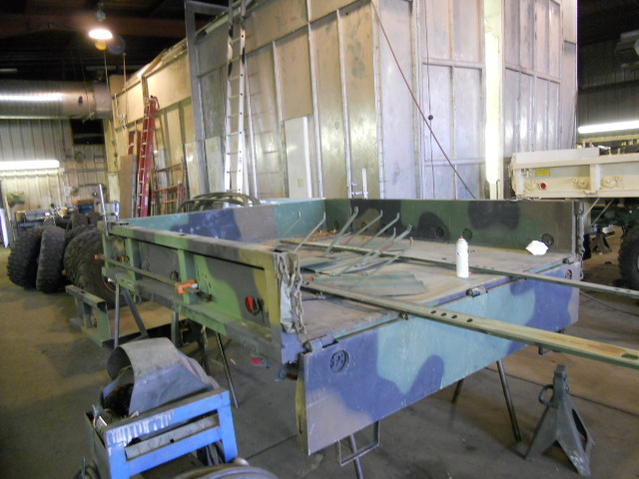

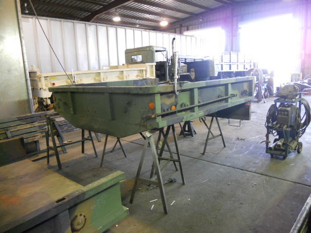

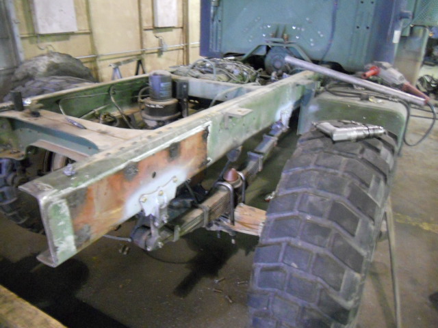

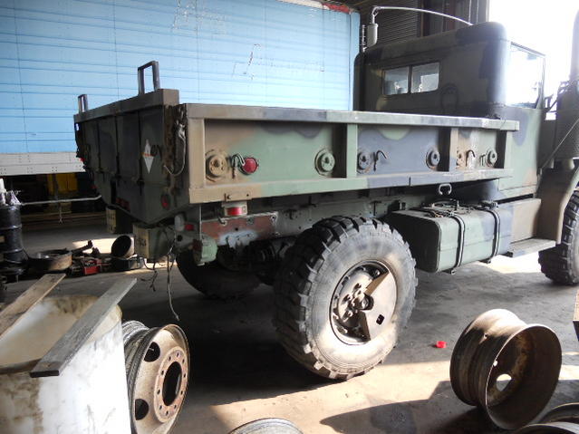

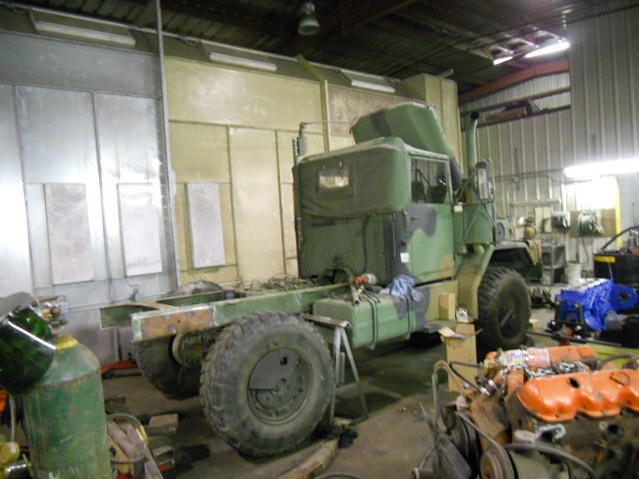

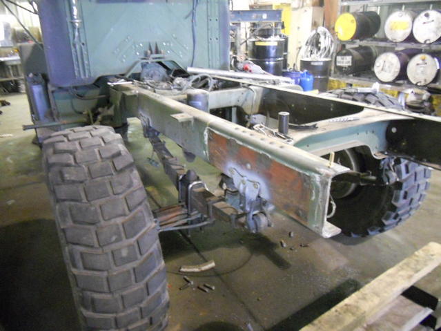

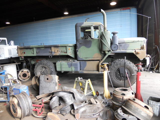

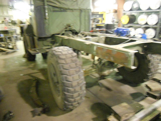

The latest photos of the bob. Sitting @ eastern surplus. Should have it home in 3 weeks. Will add the new 46" tires once home. Still can't make up my mind, michelin xl, xml, or xzl ?!?!?
