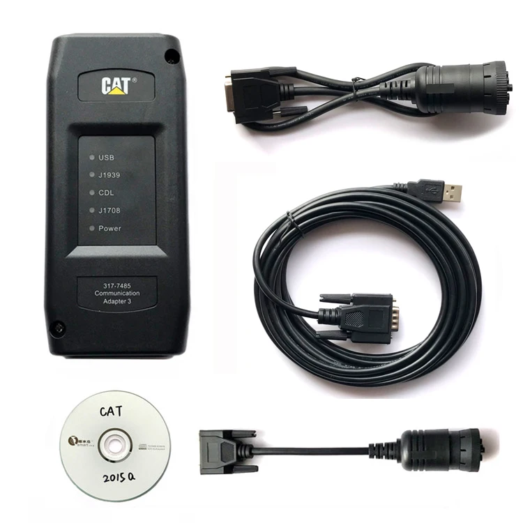

On the A1 trucks it's really easy to reprogram the CTIS controller and change only the High way setting for example. You can also reprogram the CTIS over-speed warning or turn it off completely. But you need to have the diagnostic tool for that.CTIS.jpg
What plug/cable are you using? Any pics?
