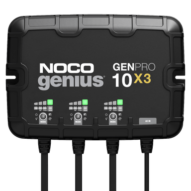

I've got a 24v system in my Bass Boat, and I have a Genius Batter Charger that charges all 3 batteries (starting battery and 24V (two 12s) trolling batteries) on a trickle charge. Probably one of the best purchases I made for that system, because those batteries aren't cheap., and that Genius battery charger can bring some batteries back from the dead.
I may do the same thing on this truck if I'm going to be letting it sit for long periods.
that thing is
Fully submersible.
and is 300 bucks.

I paid 170 on Amazon. Not sure why someone would charge (or pay) double.
Amazon.com: NOCO Genius GENM3, 3-Bank, 12-Amp (4-Amp Per Bank) Fully-Automatic Smart Marine Charger, 12V Onboard Battery Charger And Battery Maintainer : Sports & Outdoors
Squibbly
408
1,042
Alabama
I was looking at that exact one - kinda pricey for my “truck budget”, but I’ll probable get it. Have you had a chance to hook yours up? I would love a real world review before I spend the $’s.
I haven't had a chance to hook it up yet. I'll give a review once I've had a chance to use it.
My brother seems to like it, and he generally knows what's up with these things.
