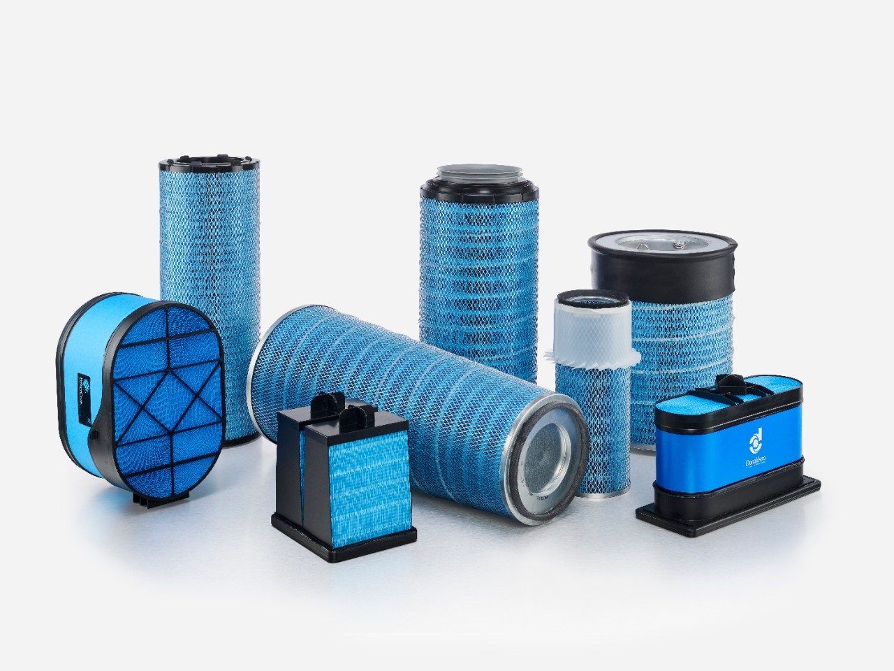

Does anyone have a way to look up donaldson filters by size? These look like they'd be worth a shot.
I'm going to try calling their customer service line to see if they can look them up by size.
I would think the 9" PDD filter would flow enough, but I'm not sure I want to gamble. The surface area on the 9" filter is roughly 70% of the stock deuce filter, so that has me concerned. Although, the 9" filter has 29% more surface area than the 7" filter... so maybe that's enough? Perhaps I just send it with the 9" performer filter and just hope for the best.
