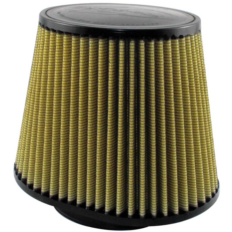

You guys have any thoughts on this one? Not really a fan of it requiring re-oiling eventually.
I'm having a heck of a time finding anything that matches the surface area of the stock filter.

I bought the PDD filter believing I was buying a modern product which just HAD to be better than a decades-old design... right? We've heard lotsa times that sometimes the old stuff is best. In hindsight, having no problems with the stock filter, being able to blow-out or wash the stock filter many times over, I've learned a lesson and I'll be sticking to the stock filter from now on, which, if I properly care for it, I might never need to replace. Big Mike's, Oshkosh, Eastern, Boyce, and Eriks Military Surplus all list the stock air filters as being currently in-inventory. From now on, anytime someone offers a whiz-bang air filter for my truck, I'm just gonna walk on by.

Yeah, i gotta say I'm a little shocked this "modern" filter meant for much much high HP trucks is inadequate compared to the old filter.. I mean PDD even told me it was rated for about 800 cfm which is twice the stock filter. Perhaps our trucks are just more sensitive to restriction. It would probably be wise of me to just go back to stock, but I did a number on the spring bottom in mine getting it out. I guess I'll have to see if i can repair it.

This is just a theory but the multi has a extremely inefficient turbo that is only there to add just enough air to clean the exhaust up a little bit. Where as most other engines have a efficient turbo that must be controlled by a waste gate or it would produce boost levels that would be catastrophic. This difference in turbo design is in my opinion the difference here on one hand you have a turbo that is giving all it has all the time and on the other you have a turbo that can make up for a slight inlet restriction by not bleeding as much exhaust out the waste gate.

I understand your point but I don’t totally agree.if these filters were the problem that they are being made out to be here then others applications would also have issues. Knowing how easy it is to have a turbo over boost in other applications I truly believe that it is the outlying factor in this situation. These turbos were designed to not have a waste gate which means the turbine housing is so oversized for the engine compared to the turbine wheel that it can not over boost within normal operating conditions.
but the truth is that we are all just speculating at this point because we don’t have enough information. We know that these filters are effective on other engines and we don’t have any data with a multi that had a appropriate turbo swap and this filter.

I'm going to guess that the old filters work because of the surface area, they have a lot more than the PDD. The extra surface area should allow it to catch a lot more particulate before it plugs up. At least that's all i can think of.. If i had to guess a PDD filter exactly the same size as the stocker would work. I do also think the turbo efficiency makes sense.. maybe this is a good excuse to try a modern turbo lol
The theory that a modern turbo is less affected by the restriction is pretty well backed up by jeepsinker using the 7" on his cummins swap and not having any issues.
At any rate, I think we can at least conclude that these filters do not play well with the stock engine. Hopefully i can find a way to use it on something different.

I just got out of the diesel performance industry after 20 year of running my own shop and I can tell you first hand that aftermarket air filter are one of the most overrated products out there. On the other hand stock paper elements are one of the most underrated.
The only way to properly compare air filters is to know at what resistance level (inH20) that they were tested at. Take the factory Donaldson P117551 in our truck. 410 cfm rated but at what inch H20? Without that piece of information you can't make a fair comparison. Below are the spec's on a random Donaldson that I grabbed as an example...

I took a ride in a friends M35A2 this weekend that was equipped with a clean Donaldson filter and gauges. I had some of the Fleetguard AF826's on the shelf for my truck so we swapped filters and ran the same route. Results? Zero discernable difference that I could see on his gauges but the Fleetguard is supposedly only rated at 284 cfm. The problem is that I don't know what inH20 spec was used to obtain these ratings. I do know from experience that Fleetguard underrates most of their filters. I'm guessing that many of the other manufacturers (Donaldson, Wix, Baldwin) most likely do too.
AFE, S&B, and Banks are all known for grossly overrating the flow of their filter when compared to real world applications.
