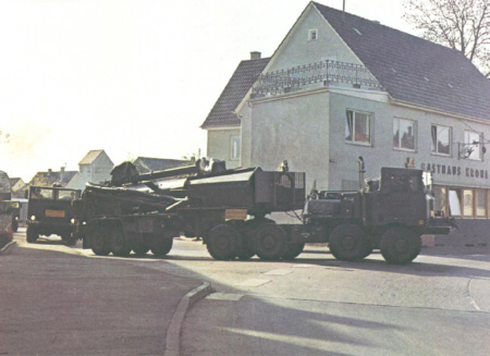

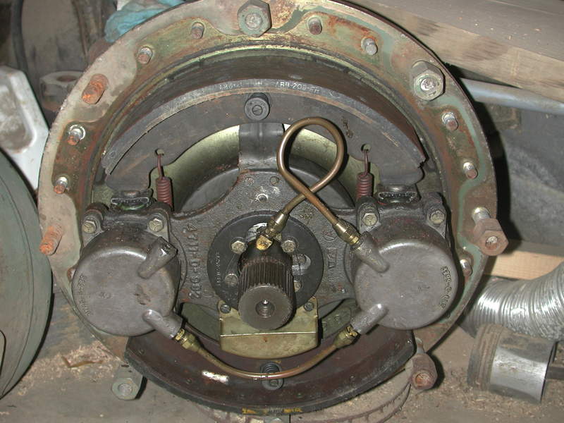

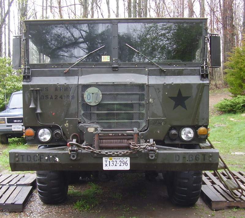

Ford wanted to make a military truck that met all possible requirements and hoped to replace the 2-1/2 and 5-tonners in that era.
It became too expensive and came with too many features, rarely needed, so only a token 500 very ordered and assigned to the "hi tech" oriented people with the Pershing 1A battalions in Germany.

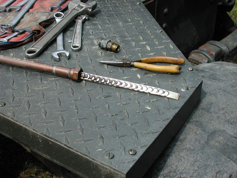

The xm757 was a variant of the m656, which also could "swim" (the xm757 doesn't have the buoyancy in the rear for swimming), but can pressurize all components, including sealed brake drums for fording about 5 ft of water without preparations. The engine can run totally submerged.
Brakes are 100% air.
I'll describe other features as we go along.

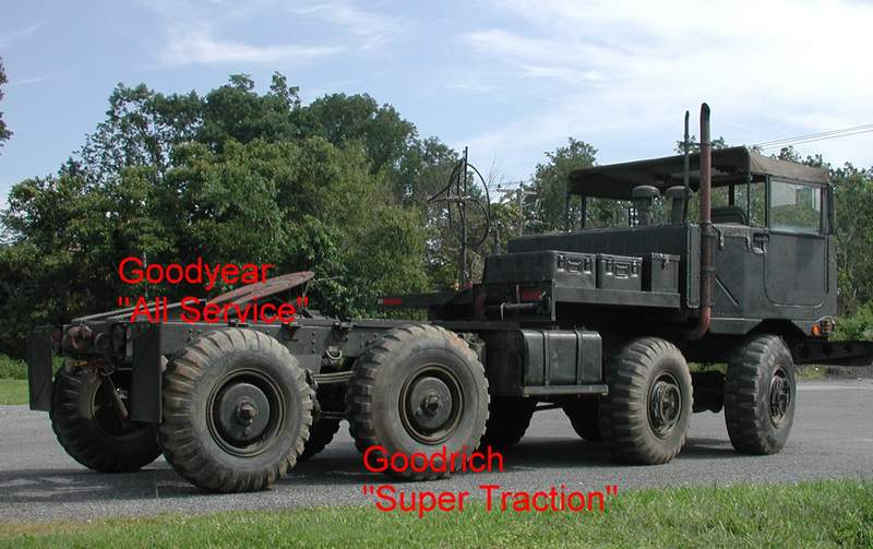

Because of lack of parts, my truck is still very much a project with substitute fuel tanks, soft top and more.

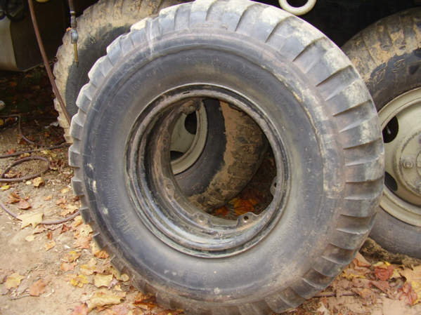

The tires were specifically designed for this series of trucks and contribute to the performance. They are hard to find and my 757 features separate brands of which only the Goodrich was assigned an FSN. Goodyear designed an "All Service" NDCC and Uniroyal even supplied a radial, low pressure, low profile tubeless super traction NDCC (extremely rare).

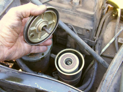

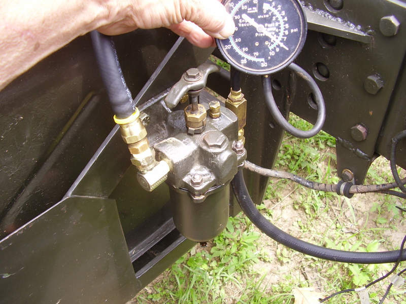

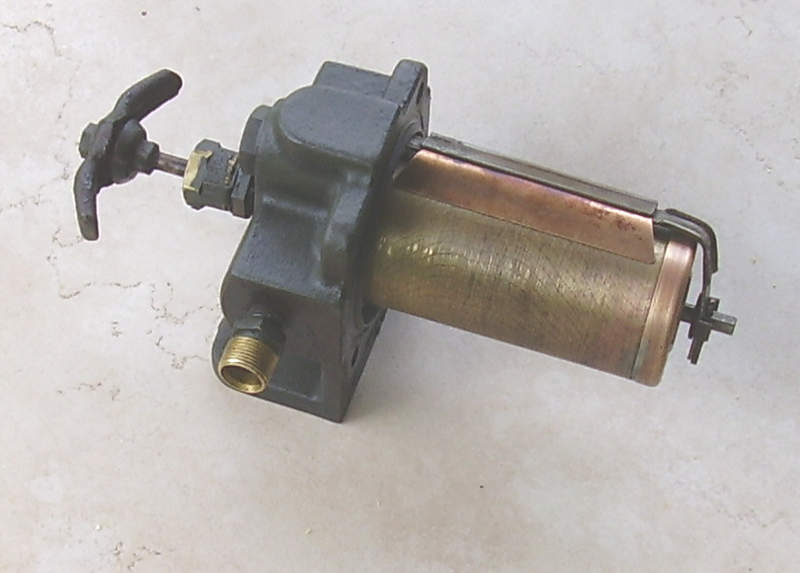

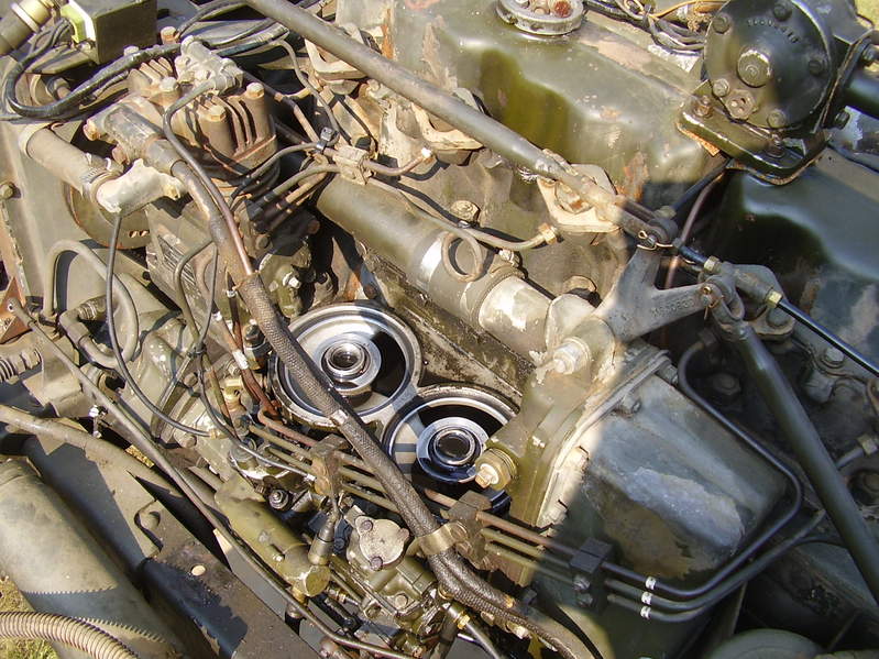

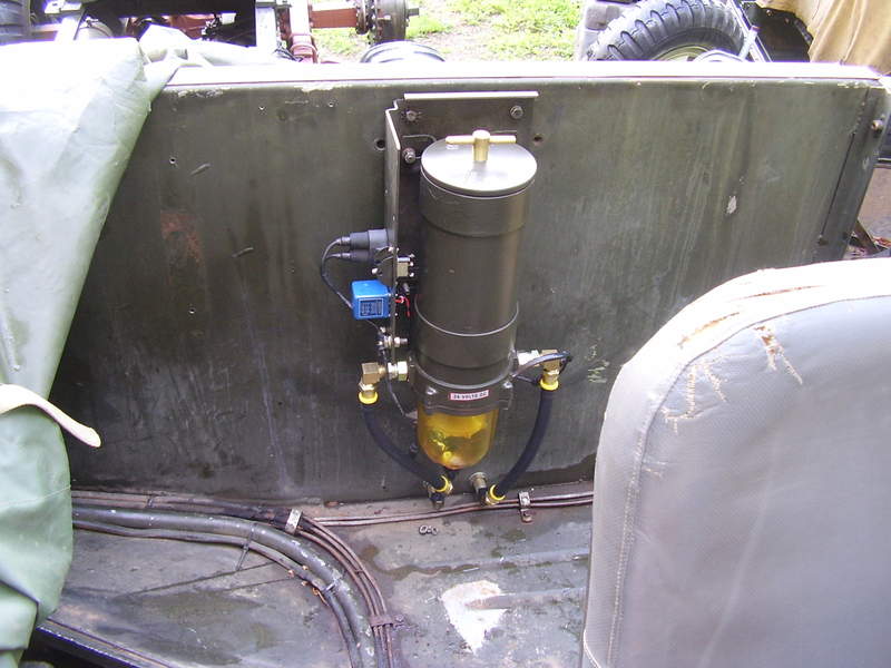

The xm757 (m656 series trucks) was designed with easy or no maintenance components, for example the LDS465-2 multifuel engine has top loaded fuel filters for easy replacement of filter elements and the primary fuel strainer is of the "scraper" kind and no filter element does ever have to be changed, just a turn of the lever does it.
2006 1030 lds465-2 top loaded secondary fuel filter, cartridge, 6 micron.jpg2008 0603 purolator fuel strainer, 50 micron.jpg2008 0620 xm757 fuel strainer output pressure, fuel pressure.jpg
I later replaced the scraper type strainer with a Racor top loaded primary filter/water separator, however. A magnetic fuel filter was also installed (of my own design).
2007 0601 racor primary fuel filter, 30 micron.jpg2013 0909 1309 hrs, Monday, clean magnetic fuel filter, particles trapped.jpg

LIGHT WEIGHT
The xm757 (m656 series) was designed for minimum weight to benefit cargo carrying capacity, floatation, air-dropability, transportability and ease of movement across off-road terrain. The total vehicle weight is 16,650 lb, with many parts made of heat treated 6061alloy aluminum.

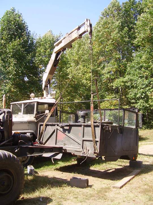

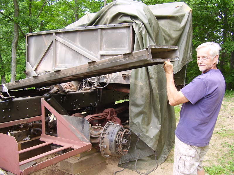

For example, the cab assembly is one single piece, welded in T4 and heat treated to T6 condition after completion. Weight of cab is just over 700 lb. It's boxy shape, of course, is to provide maximum buoyancy.

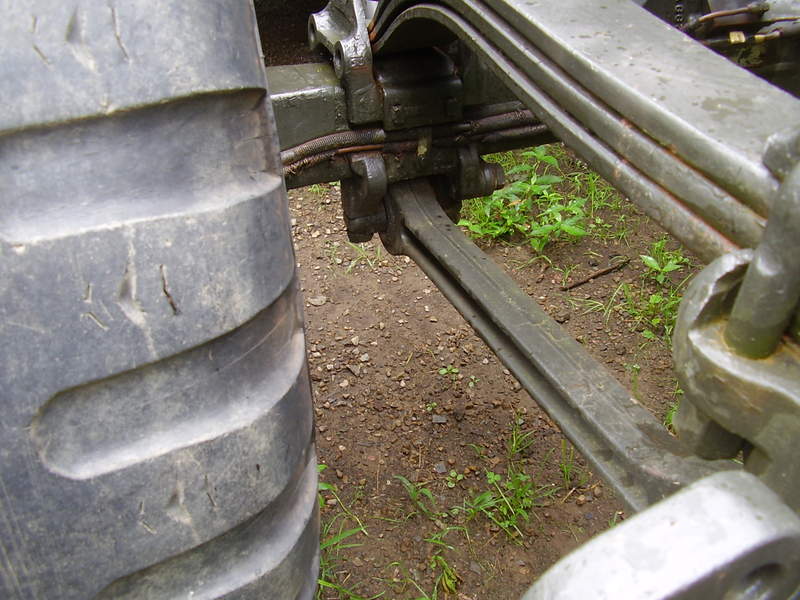

Smaller components are also made with weight as a consideration, the oil canister bracket on the multifuel engine is aluminum, the torque rods are forged 2014-T6 aluminum.
2010 0923 Thursday, cab lift, oil filter bracket.jpg2009 0803 0800 hrs, torque rod, aircraft aluminum, 2014-t6 alloy (2).jpg
The unsprung weight is reduced by light weight, each wheel plus tire weighs only 220 lb.

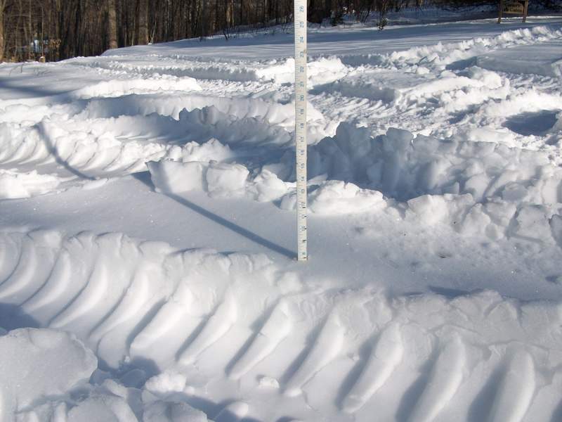

With tire pressure at 10 psi, the impression in fresh snow is not much deeper than my own foot print.
