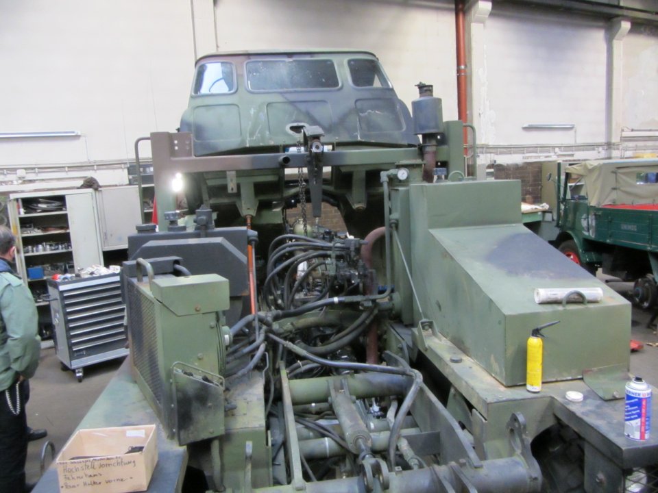

Hi Miggins
Enjoyed your pictures of getting down to the engine for major work. Made me think of what it takes to pull or install the engine on my C60S Pattern 13 truck aka BEAUTY
Actually this was part of a time motion study to identify all the steps necessary to pull the nose and engine.
If you watch the time in the corner you can see it was a lot quicker coming out than going in.

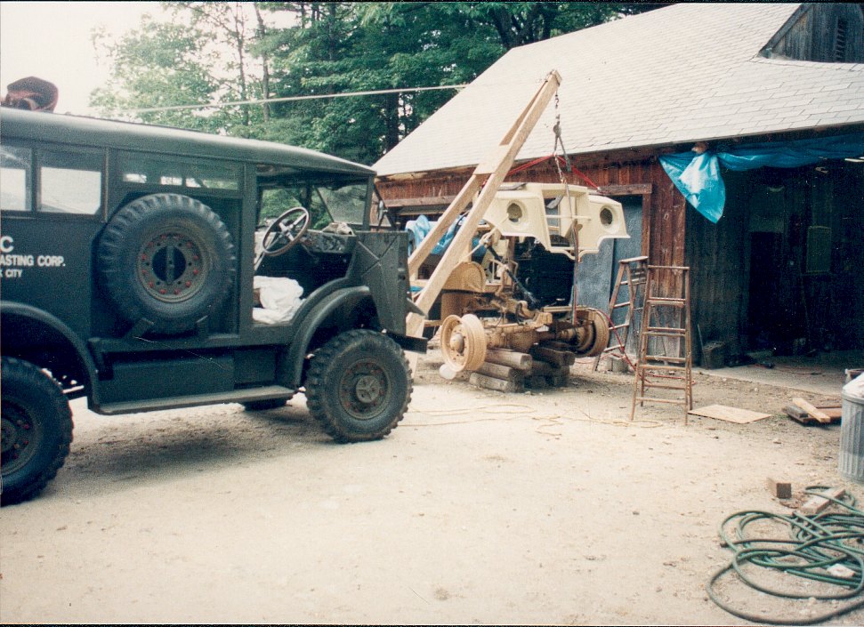

Hi All

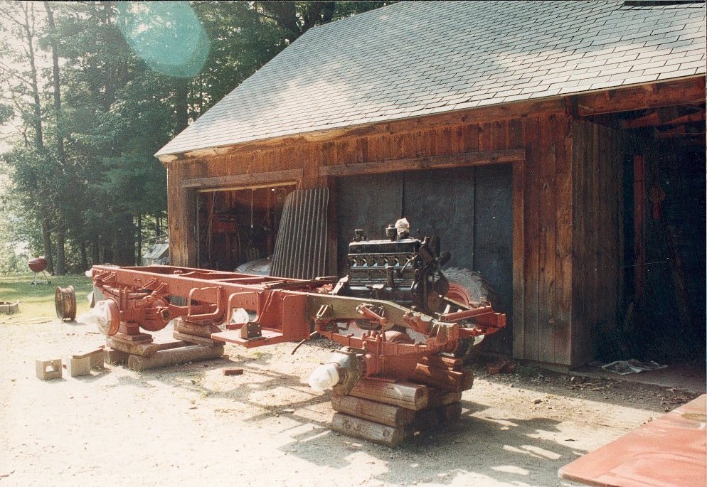

Glad you enjoyed the music. The videos were taken in 2009 Beauty got a new engine identical but it went from 216 cubic inches to 261 cubic inches that changed the Horse power from 84 to 160. Didn't really make the truck faster just means you go up a lot more hills in 4th gear.
The next two pictures are from 1990 as you see I'm making progress on shop space.
Yes in case you are wondering all three of my trucks have been down to bare frame. At one point I had pulling the engine out of these trucks down to under 3 hours, working by myself. But it was still taking 2 full days to put an engine in and get all connected again.
Cheers Phil
PS The reason for swapping the engine was two fold, first more power but the second was equally important. The remain had gotten to the point that I had to carry cat box with litter in it, because it leak so much oil. Was down at the Boston Navy Yard next to old Iron-sides for a display. Almost the moment I killed the engine the dock chief came running out with a big absorbent pad. By the time he got to the truck I was sliding kitty litter box under the trucks bell housing. As I stood up I said "doesn't need a diaper it's litter box trained." After that trip though I did put a fitting bell housing drain and connected a line to a vacuum scavenge tank which with less vacuum than the wipers would suck the oil out of the bell housing bottom.

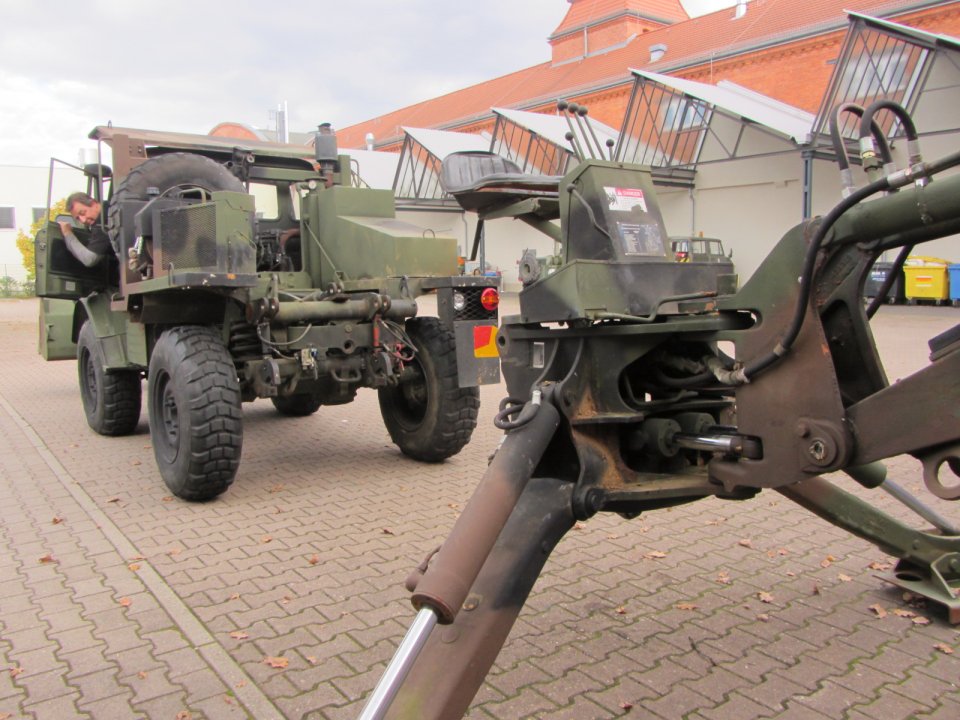

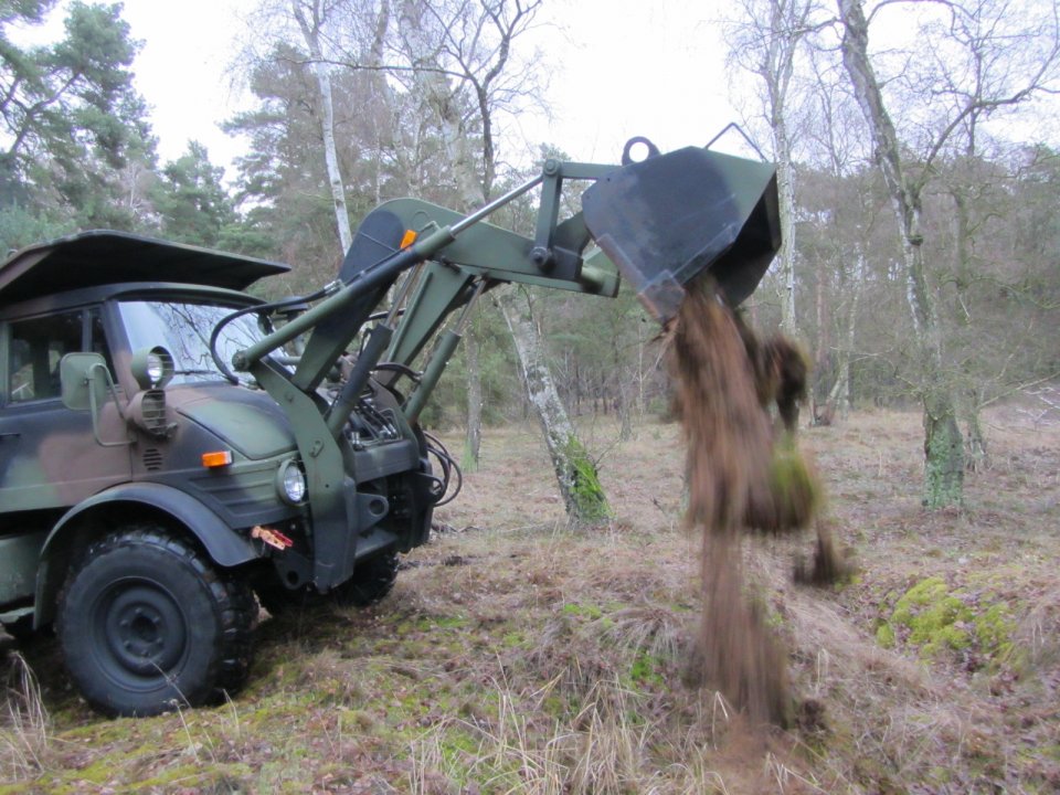

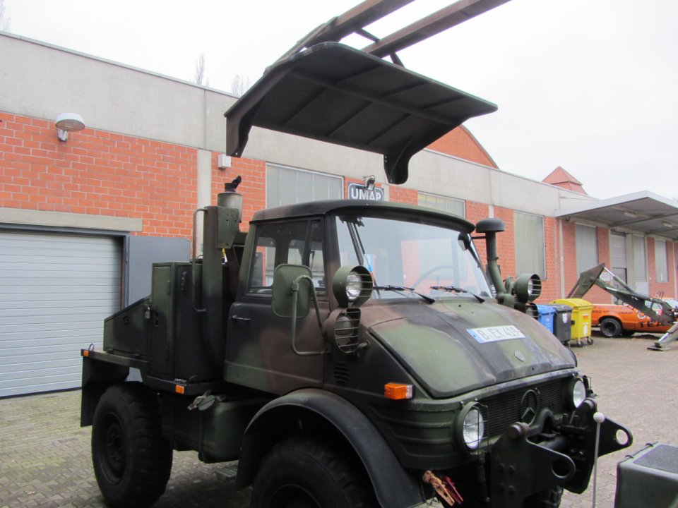

We don´t withhold the front page of the Freightliner add.
And if you think about " Compact, Lightweight and Versatile" ........

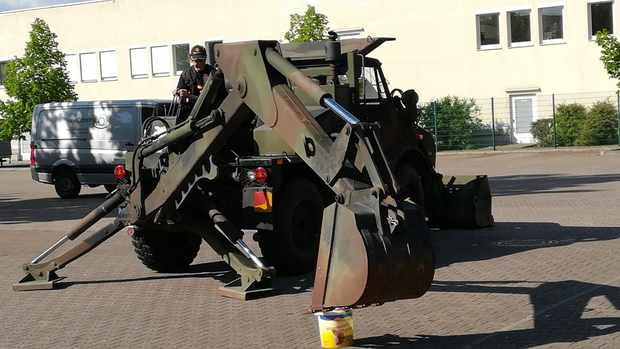

...................(most of you know this short vid) a SEE can fly ;)(y)

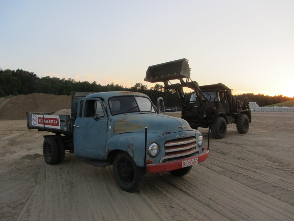

For counterbalance adjustment they put the spare tire into the bucket of the front end loader.
