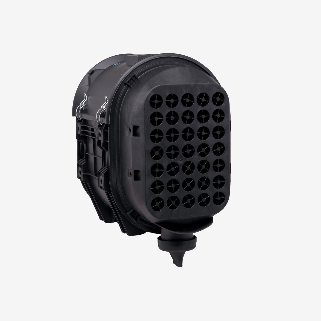

Use this air filter(s) to be able to get camper closer to cab: https://www.donaldson.com/en-us/engine/filters/products/air-intake/cleaners/psd/

Yeah, I think I'm just going to lower the stock air cleaner housing, don't plan on going into anything too deep......
I'm also planning on moving spares to the rear, eliminating the current hydro assembly and redoing the cab lift minus the spare and kneeling hydro/ shir system....
possibly a pass through incorporated in a future build, but for now, I literally plan on slapping a slide in bed camper backwards, so the overcab is off the rear. Bolt it down and go enjoy a few vacations just so the wife can enjoy it now then see the bigger picture and enjoy us building a real habitat in a couple years.....
