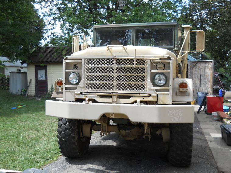

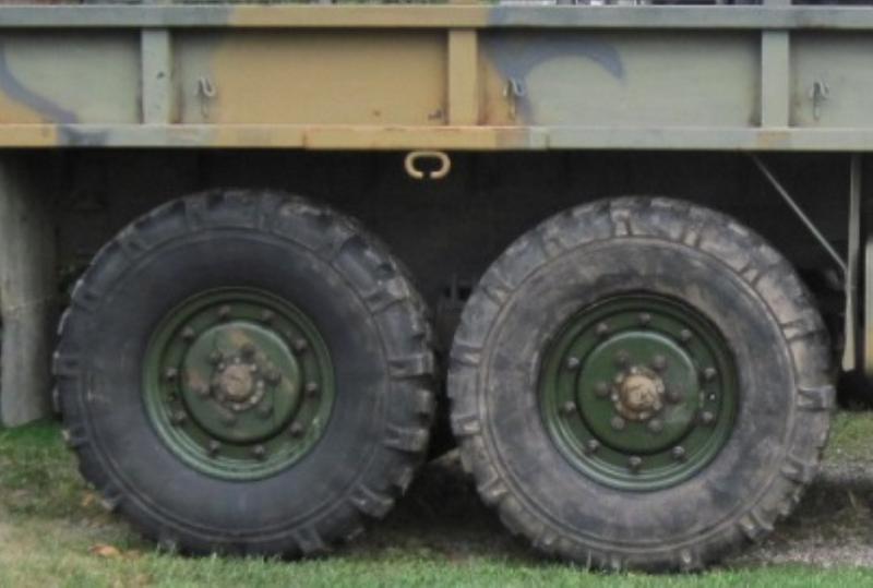

Standard 5 ton combat wheel with Michelin XZL's. Two of the tires are currently not XZL's, that's how I got it. But after this weekend they will all be XZL's.

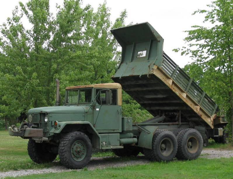

14.50R20's on the front and 1100R20's on the back
Any side pics of this one bob? Love the look!:drool:

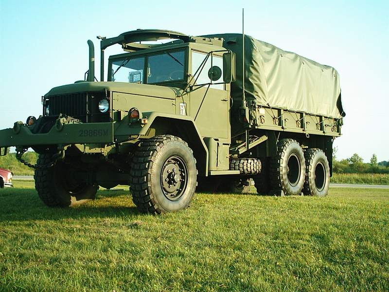

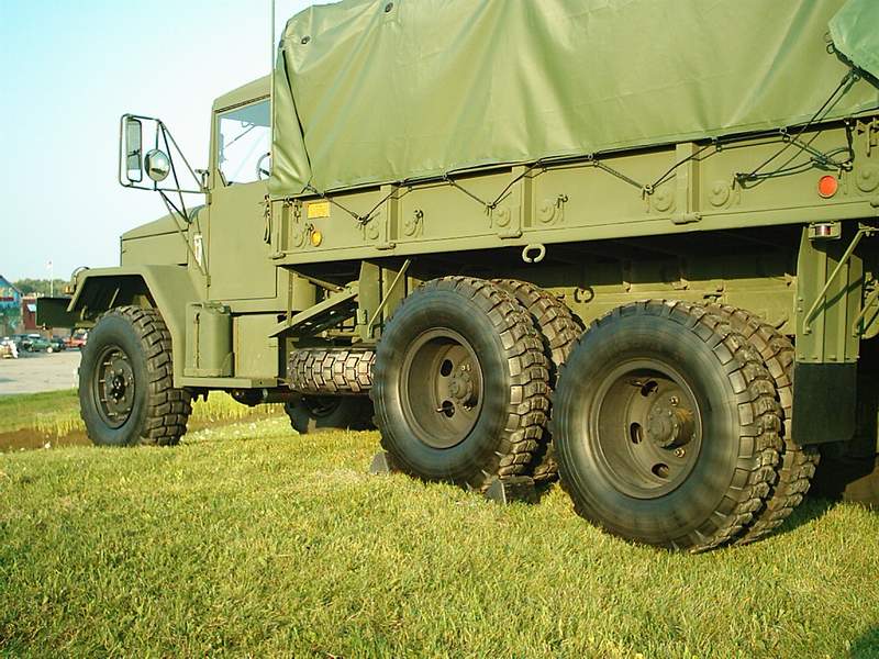

Not my truck, here's another angle.
The fronts are M35A3 wheels & tires.
Note that 14.50's are the same diameter as the 1100's (43")
as mentioned above the 395's are 46" same as the 15.50R20's
The 15.50's have a heavier load rating than the 395's

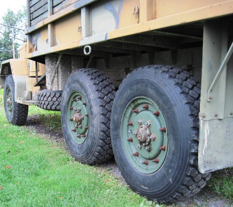

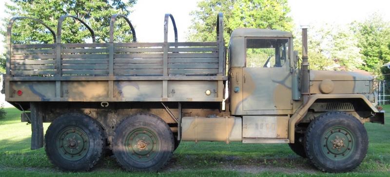

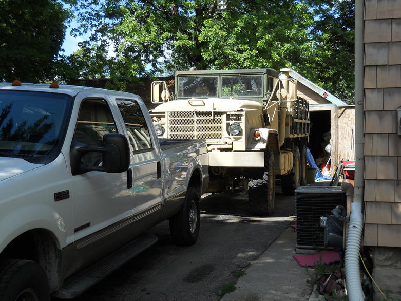

Just to really mess things up, here's what my 5 ton looks like with Goodyear MV/T 395's:) These tires are about 3" smaller in diameter (46" vs 49"). But have the about the same width as the 14.00's. Just something to think about. The 395's are in an abundant supply as they are the main tires on the FMTV type vehicles.
These fit a 2.5 ton stock wheels?
