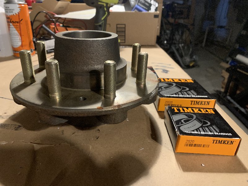

Working on fixing this on my M116A3:
Yes, the hub is cracked!
The parts have all arrived now.
Some photos of the new hardware.
Quick question: Should I paint that new hub because it will rust if I don’t?
Painting is unlikely to do anything to hurt it (as long as you don't paint the inside) but if the old one was unpainted then the new one likely doesn't really need painted either.
Thank you. The center part definitely had the military green, but I think it got sprayed when someone painted a wheel while it was on the trailer. It's sort of hard to tell on the rest of it.
