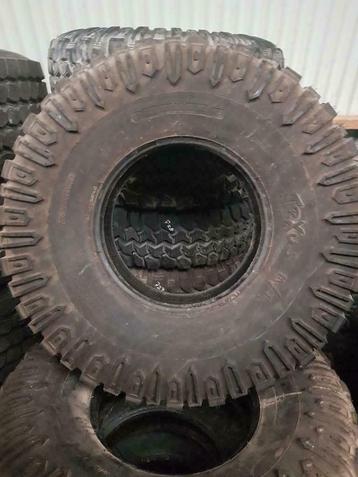

Hello together
I hope my question is not too stupid and has not already been asked 2000 times.
I am just about to fill the waiting time for my 1123 with shopping.
Besides the rims on which it will eventually arrive, I have ordered a set of 24bolt.
Since I also assume that the tires on which he rolls out of the depot are certainly ancient, I need two sets of tires.
I also have two different uses for my 1123.
Use off-road (field, sand, mud) and to the transporter for my race car; so light trailer pull on the highway.
I'm doing a little hard to find the tires and so I'm first off to my usual source.
So my current status
Road use
Goodyear Wrangler MT at 37x12.5
only link to a german shop found... but thats perfect for me
or
Super Swamper SAM-93 at 38x12.5
or
Super Swamper RXM-32 at 37x12.50
Use off road
Super Swamper ROX-22 at 37.12.5
or
Super Swamper SSR-45R at 37x12.5
or
Super Swamper SAM-96 at 38x12.5
Since I unfortunately know neither the vehicle nor the tire dimensions standh eich there currently something alone in the forest.
On my RAM and Jeep I also drive in light terrain and on the road with the BFG AT KO2. After all these years, I find this tire with the perfect balance between light off-road and road. And if it were available for 16.5" I would choose it as a street tire.
I hope now not that everyone claps the hand on the forehead and call out "oh no, not another newbie tire thread".
But I'm standing there right now completely in the forest.
thx,
Gerd

I’ve had experience with all of them except in smaller sizes.
The MT where a previous version, however where a good all around tire, but wore down fast.
The SSR where good off road, not great anywhere else, chunked, cracked, and split within a year of mounting. Warranted two that did the same thing. I think this was right after Interco moved their plant to Mexico, and guessing it was a bad rubber compound.
The SAM is one of the best mud tires I’ve ever had. Poor all around on road performance, very noisy, no good in slick snow, decent in deep snow.
The RXM are the best all around tire I have ever owned. I ran them on a fairly heavy truck and occasionally pushed snow, they where amazing in the snow for such an aggressive tire. They where fairly quiet, did good in the mud, wore very slowly, did good on wet pavement, and didn’t squirm around while pulling heavy trailers.

They often appear for sales, here in The Netherlands.
Hummer banden 37x12.5R16.5 gebruikt en nieuw! grote voorraad
Op aanvraag
Goodyear wrangler hummer dodge w 200 4x4 mud. 5 stuks
€ 600,00

For your stated use of the rig, my vote is the Goodyear MT b/c there are a few vendors who have large inventory of 100% tread take offs that have been mounted but zero miles. I sourced 4 for about $175/ea delivered in 2021. In my opinion you can’t beat the value at that price. I assume the govt is rotating them out due to age? For that price you could throw 8 in your container getting the rig across the big pond and might be good to go for a while.
IMHO tires are consumables so I would not get hung up on it. I’ve run allot of tread patterns and if you can get a thumb within the lug spacing she’ll eat. If not that’s a Mall Crawler AT tire that’s likely good for everything except mud. The only way the mud tire tread is going to last is not drive the rig. If you don’t drive it…they’ll still dry rot w/ time.

I would agree the stock wrangler MTRs will work. They are not the best in rain and snow on the highway but are a good all around tire on the stock wheels. The lack of sipping cuts just makes them slippery in rain so be careful.
has the truck been serviced by anyone before shipping. Making it 1000 miles out the gate from govplanet sounds challenging. I’d bring a complete set of all the fluids including gear oil for the hubs and diffs, a very complete tool set, spare hoses, belts, hose clamps. A breaker bar for tire changes, a 24v jumper if available, fuel filter, a high lifting Jack. Lots of duct tape. The list goes!

About tires: The Wrangler MT in its "Military OZ" variety isn´t officially exported, so all Military MTs in Europe are probably surplus.
However, I recently saw an ad from a tire dealer in Germany who offered new Wrangler MTs without the "Military OZ", kind of a civilian version it seems.
To me, the only obvious difference seems to be the missing ozone protection which the military wants for longer storage time.
