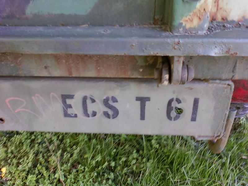

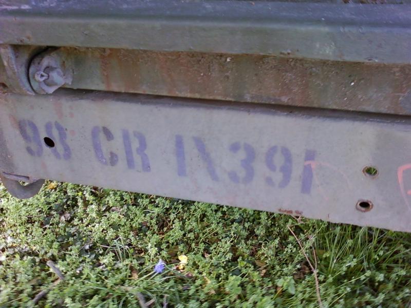

I bought 2 M105a2 trailers recently and only one has a data plate. So I'll give you the one with the data plate and what I can find on the other. I'm not sure on what to put on the titles for them. I figure I can just make it up if there are no records. This is really an amazing thread to read through. Thanks
Trailer 1 w/ data plate:
a. Serial Number (VIN number) 0649468
b. Registration Number
c. NSN without dashes 2330001418050
d. Where you bought it GL Ft. Meade March '09
e. Bumper numbers
Trailer 2
Here's the one with no data plate:
d. Where you bought it Ft. Meade March '09
e. Bumper numbers 98 CR 1\391 ECS T61
and on tailgate: 6S1560 T83 painted over AP2
e. Bumper numbers
Trailer 2
