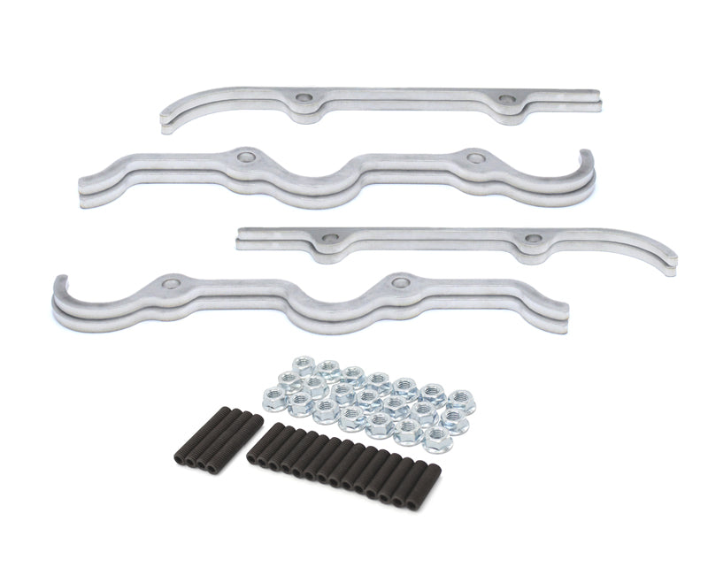

Do yourself a favor and throw those valve cover gaskets in the garbage before you get too far along. They'll screw you over in 3 ways. First, they'll take a set and start leaking. Next, you can't retorque them because the double ended studs have brackets on them. Finally, they'll lose torque due to the set which will cause the double ended studs to turn and bend the brackets when you try to take the nuts off.

I went with this. It was a bit pricey and only time will tell if it works. But it definitely feels like a firmer install vs just tightening double ended studs into the flimsy steel covers.

Well, it dang sure isn't cheap but those solve the problem of the thin metal being "dimpled" by the bolts if there are gaskets below the valve cover...

Thanks for the info. I’ll for sure invest in those brackets sometime after the trip next week. Speaking of which, here’s photos of gear I always take with me.
