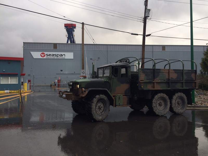

With the Deuce clutch on the fritz, I've kept driving it to a minimum (Just around town)

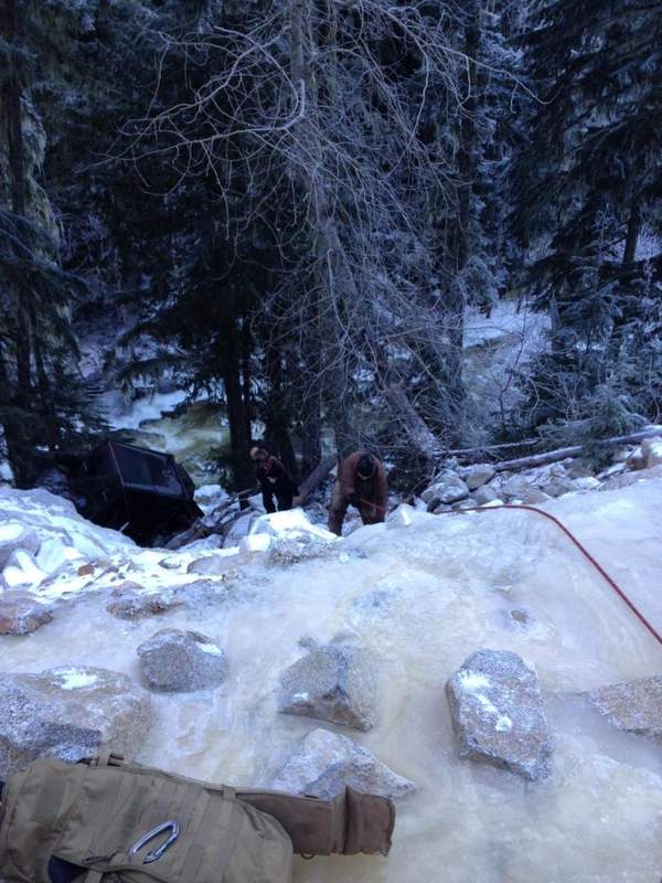

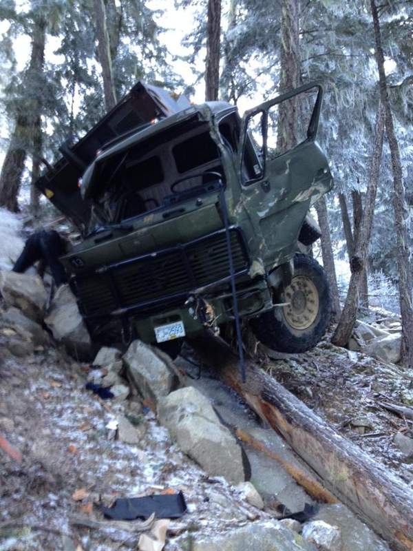

My friend with the 5-ton Mercedes has been active. Traveling out mountains alone. Operating these big rigs in real world conditions can be hazardous. Let your guard down for just one second, or make one poor decision and the sh*t gets real in a hurry.
The extra weight and size changes how the game is played off road.

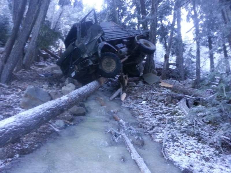

RIP Mercedes-Benz 1017A.
The driver of the truck got caught on a really sh*tty road as night closed in. Trying to get home he encountered a frozen section of road. He told his passenger to get out of the truck and attempted to cross the frozen section. The truck slide off the side of the mountain. Rolled 300ft and came to a rest against a tree. He was wearing a seat belt and survived the crash. He was able to climb back to the road and meet his passenger. Bloodied and bruised they both walked 11 miles in -20c (-4F). That's pacific north west cold, not that wussy dry stuff they get east of us.
They were being tracked by wolves for the last 4 miles and encountered Mountain Lion tracks. Luckily He gave the portable VHF radio to the passenger before the crash or they would be dead.
At 4am a Logging truck operator relayed their Mayday to emergency services.
The truck still sits where it stopped. I suspect late spring with be the earliest it can be recovered.
Reminder to all who push the limits.

Holy Crap! The Lord was watching out for that guy! Trucks can be fixed or replaced. people not so much. Glad they made it out...ALIVE!

The Crashed Mercedes still lies where she fell. There has been one failed recovery attempt with a D9 CAT with winch and a logging skidder. Today there was a second attempt and the truck was removed from the mountain successfully.

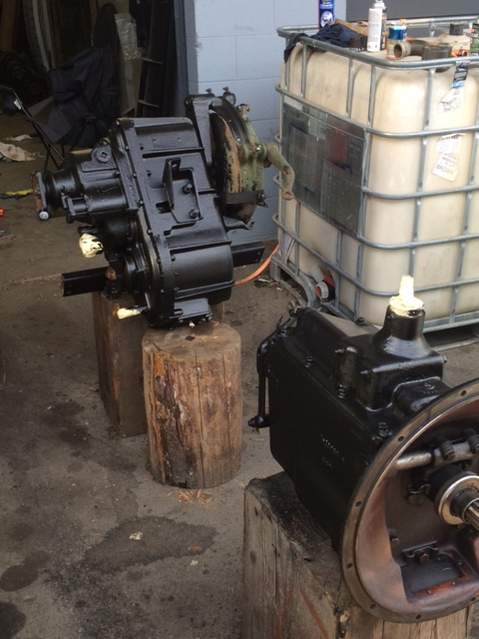

Stage 2 is Air shift Tcase, Clutch repair, and engine repair/upgrades.

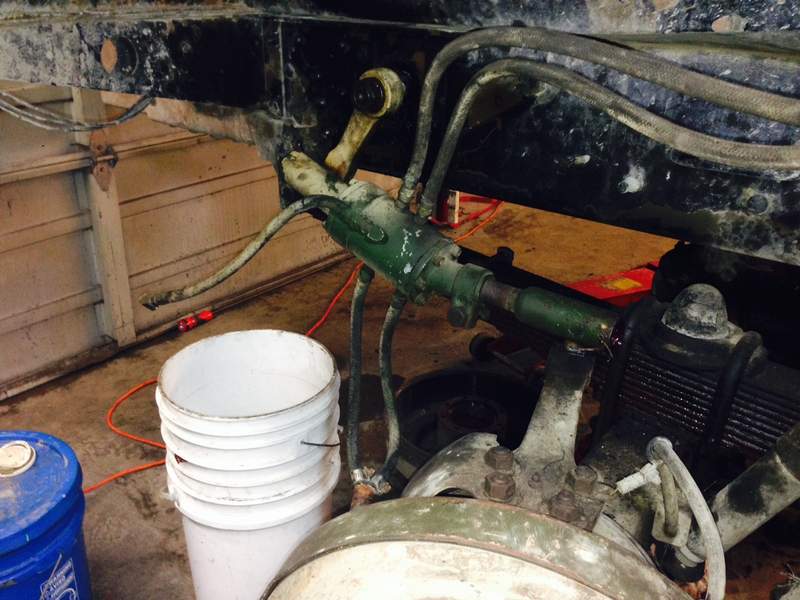

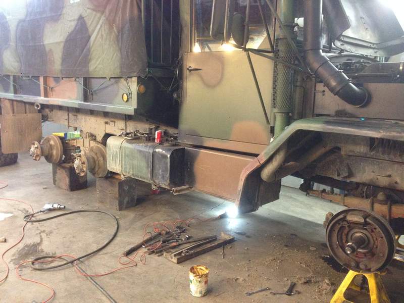

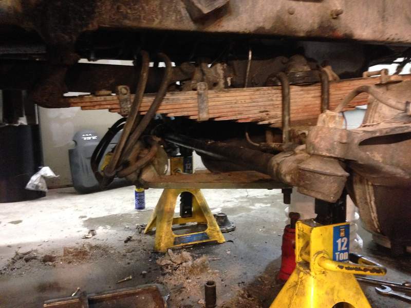

I have all the outer axles torn apart. Ordered and installed 4 new wheel bearings lol.
Partially due to all the mud and water they have been drenched in.

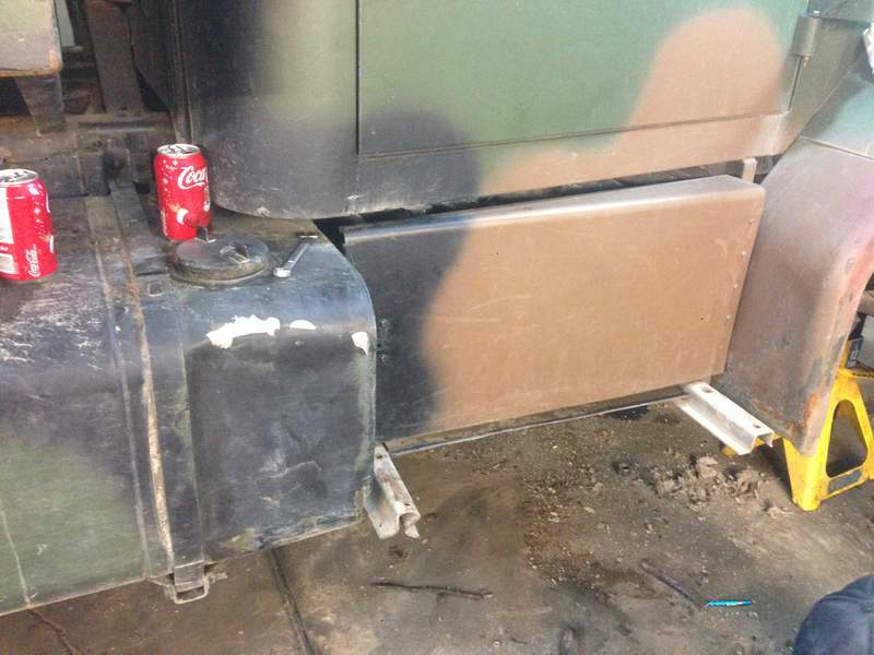

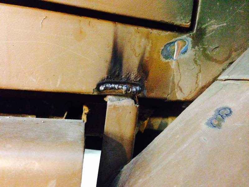

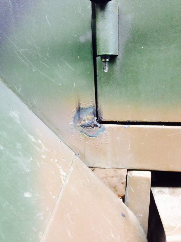

I have repaired and welded the body damage. Moved the rear axle vents above the frame, New king pins again which I find strange, Fluid change in the axles, installed valve stem extensions on my HEMTT rims.
The best news is I have all the components installed for the air on matic. Just need to finish the pluming. I'd say Stage 1 is 75% complete. I just need to get the clutch replacement parts ordered, then I can get started on stage 2 right away.

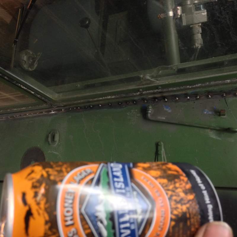

Welded more than a few spots with damage to the body. Repacked and replaced 4 wheel bearings, Brake maintenance and adjustment, Air o matic assisted steering, and added the air dryer.
Stage one is almost complete.

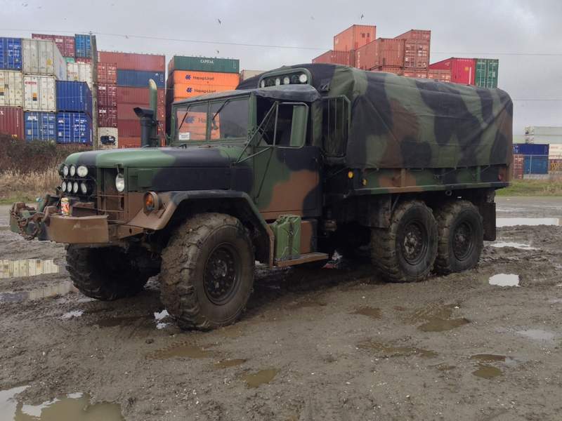

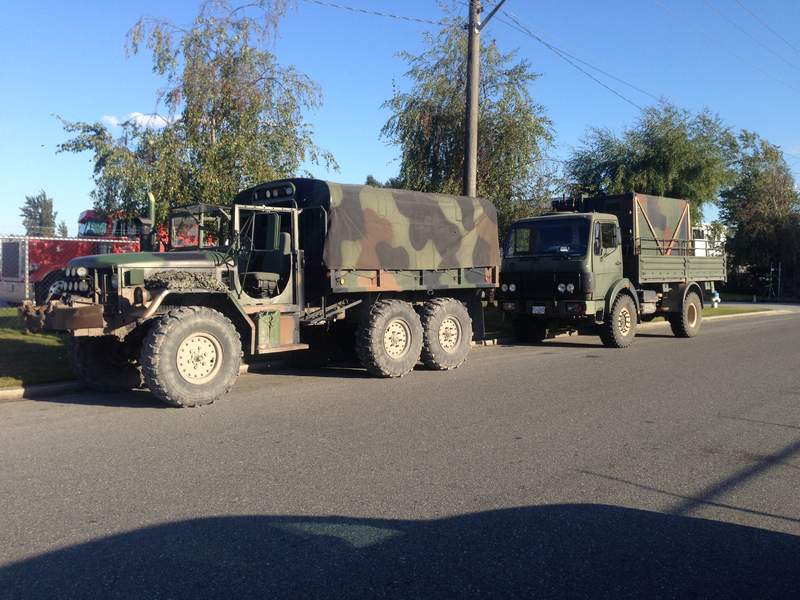

Also my farmer buddy picked up this M923A2. Mint condition other than some slime from sitting. 3500 original miles
49" tires. It could use my truck as a chew toy

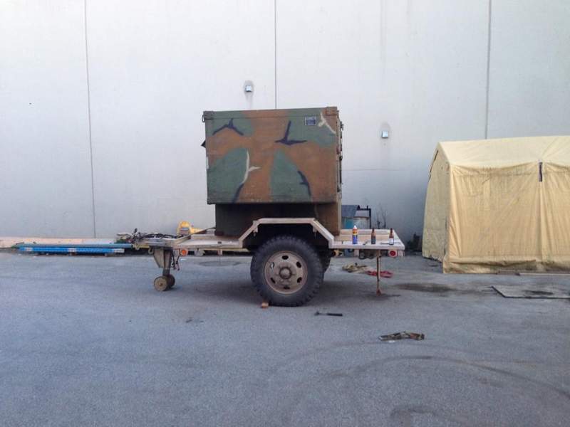

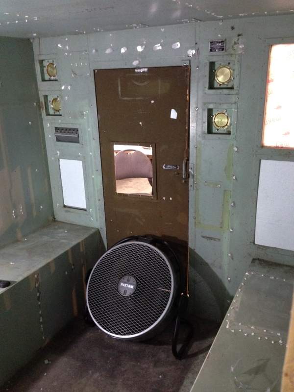

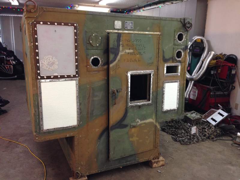

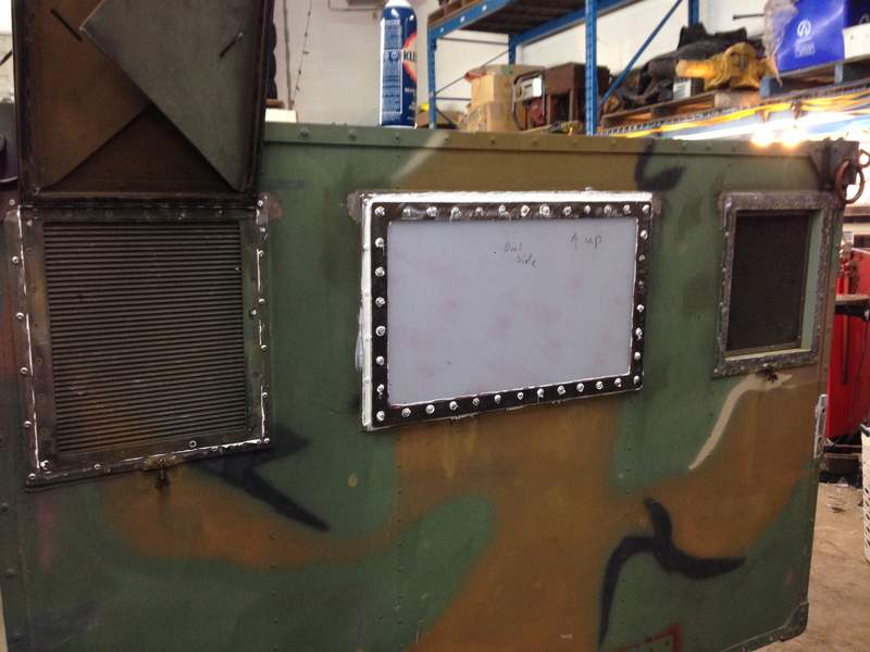

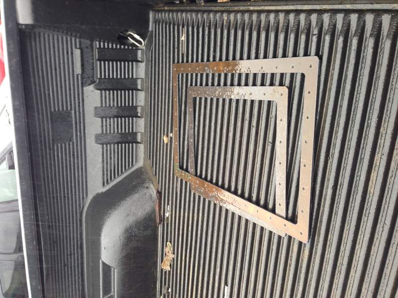

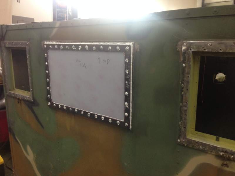

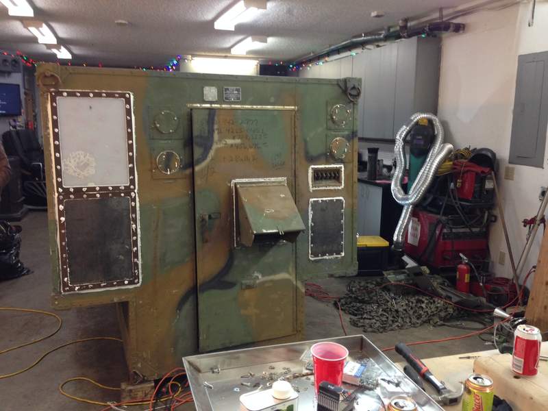

I took a break from working on the truck to put a few hours into my S-250 camper conversion. I will be dropping it on an old Generator trailer. I'm going to fab an Exo-cage around the shelter to protect it while I drag it around the trees. Propane cage, fresh water tank, solar panels and deep cycle batteries.
I started by cleaning her up and removing all the old vents to clean and reseal them. I cut some steel window trim on the CNC to match the existing screw holes. I used shatter resistant plexiglass. I removed a lot of the switch and plug panels and filled them in with Styrofoam insulation and plate steel. Then filled all the rivet holes inside and painted the interior.

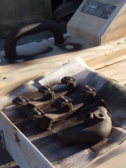

IMG_1621.jpg The power of beer is propelling this project forward. As standard SOP when beer is involved, all bolts must be triple checked for torque. House rules.

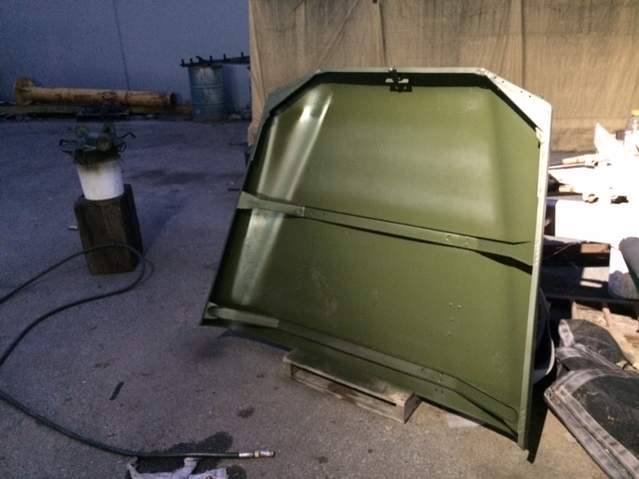

IMG_1624.jpgPainted sprayed the underside of the hood. It needed it, I also painted the firewall and inner fenders. Just brushed it

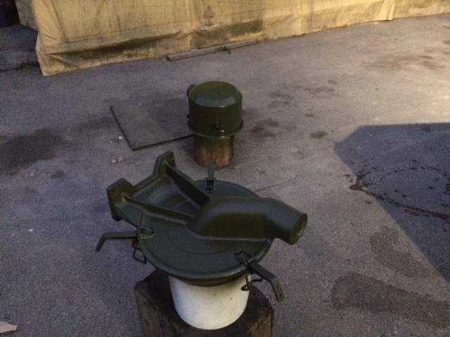

IMG_1625.jpgAir filter housing.....painted up!

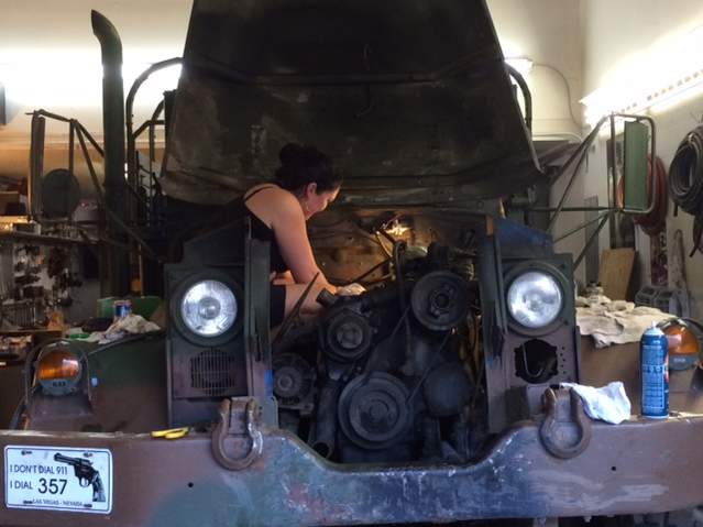

IMG_1485.jpgThis is my girl Lisa, she's a real trooper. Likes working on the deuce and she makes good sandwiches.

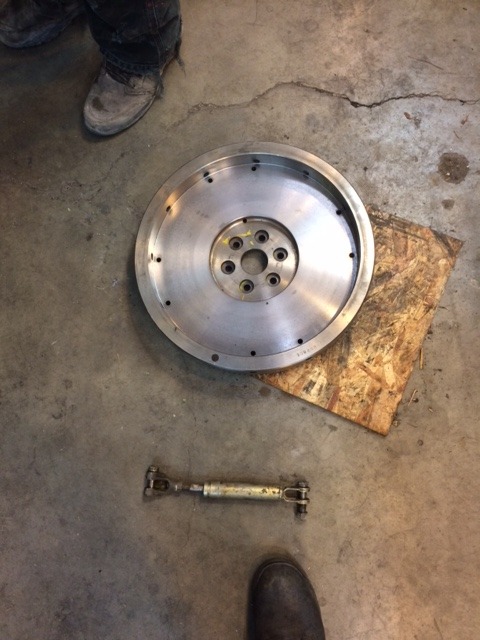

IMG_1663.JPGHere's my old flywheel after the resurface. Money well spent.

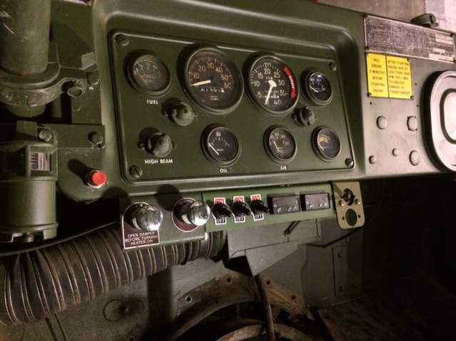

IMG_1608.jpgMocked up my EGT, boost gauges, and the front engagement switch.
IMG_1583.jpgpainted my turbo piping brown.
IMG_1582.jpg Painted my air shift and transmission black
-Air shift t-case install: Done

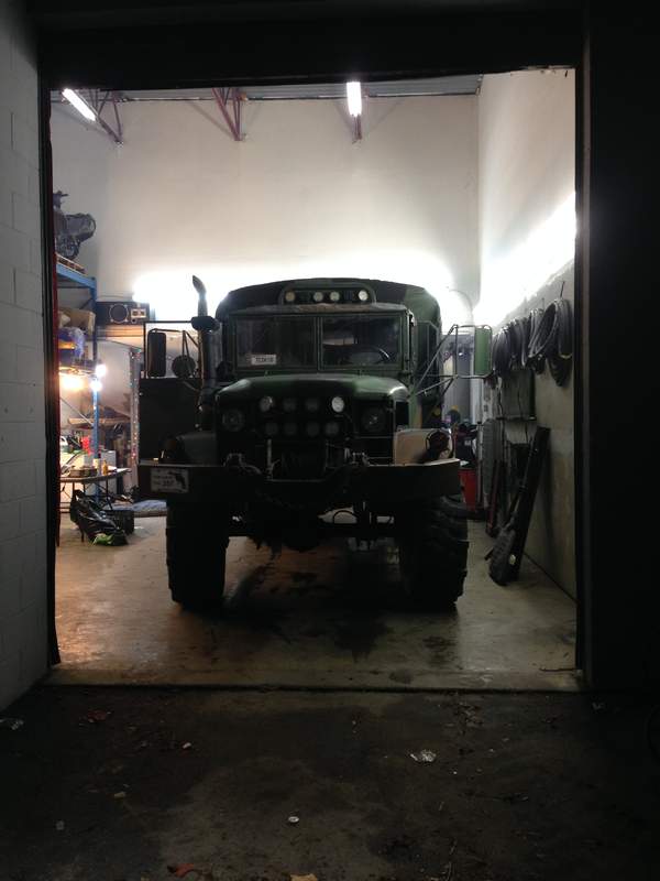

So the truck is running great, tons of power for my liking. The air shift, and clutch feel good . Nice clean injectors, new filters, valve lash adjustment, FDC bypass, and new head gaskets. I don't think it can run any better, on top of that there is very little blow by, I think I have a solid running motor.

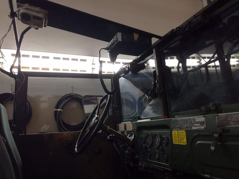

I added my overhead console and EGT/boost gauges are full functional. I peak out at about 12lbs boost when I hot dog the throttle and have noticed a max EGT temp 1057 deg. pulling up a steep hill unloaded. I average at about 250-300 at idle.
The first run after putting her back together I notice a pronounced vibration in the drive line, after some investigation I found a sloppy pinion bearing in the front axle. I pulled the drive and have ordered some hub lock outs. I intend on dropping a locker in the front axle this coming fall so I'll just deal with it as is until then.

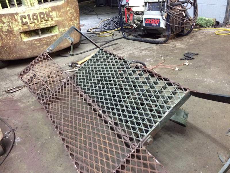

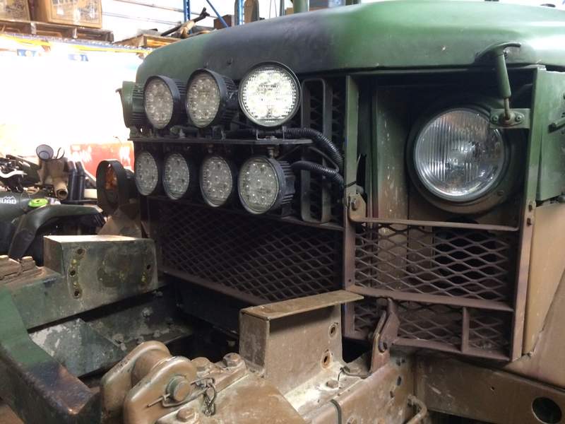

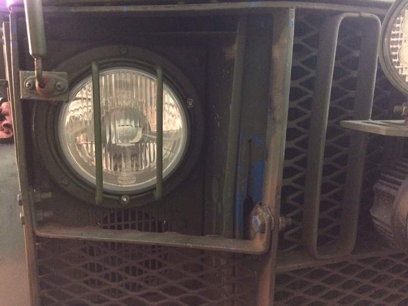

I added some minor protection to the front grill and radiator of the truck, just some headlight guards and some expanded meta mesh over the front grill. I was always paranoid about a branch or stick damaging the rad and The cable from the winch did some damage to the rad so this modification should prevent that from happening again.
Took the truck to work for the first time.....always a hit with the guys. Then ran into a few of our Canadian boys in Green at the fuel station.
