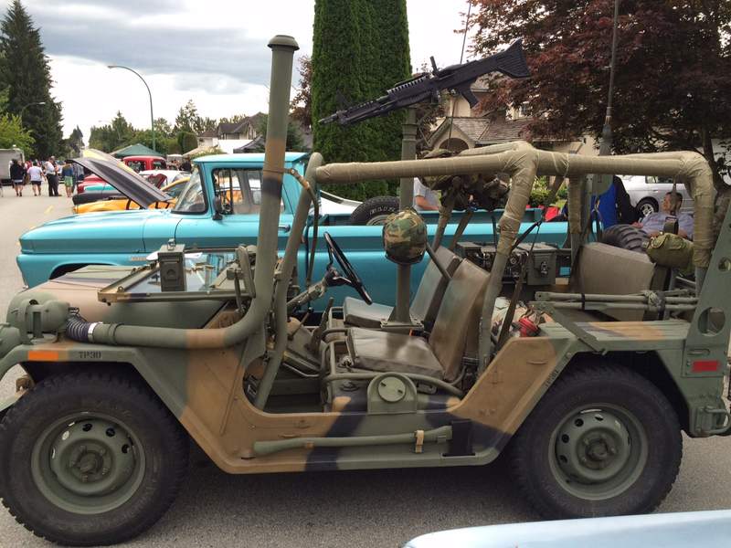

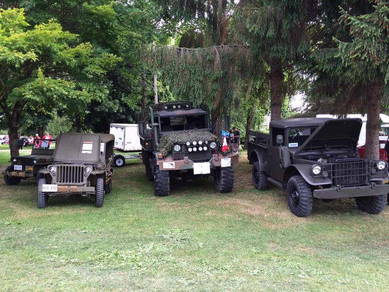

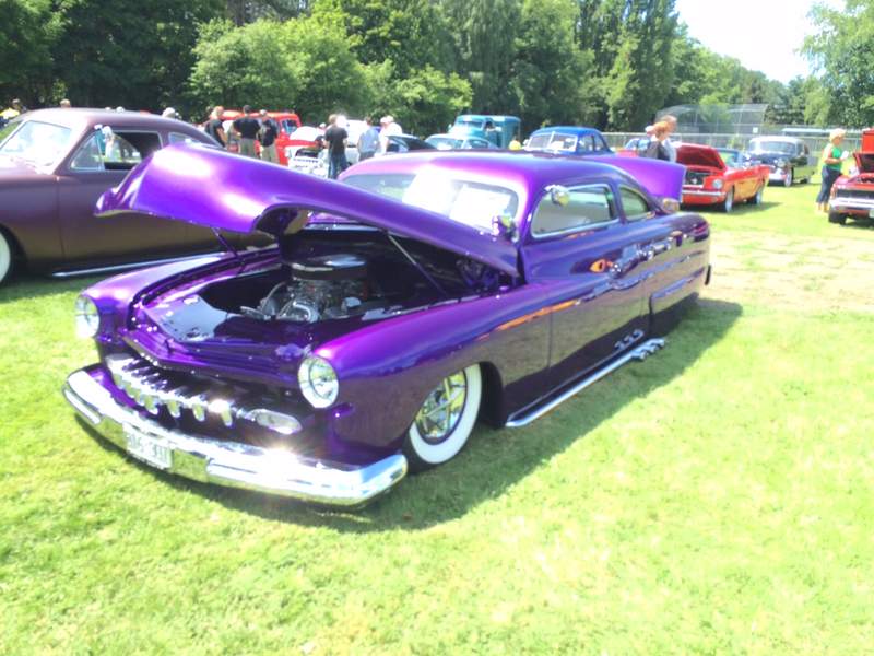

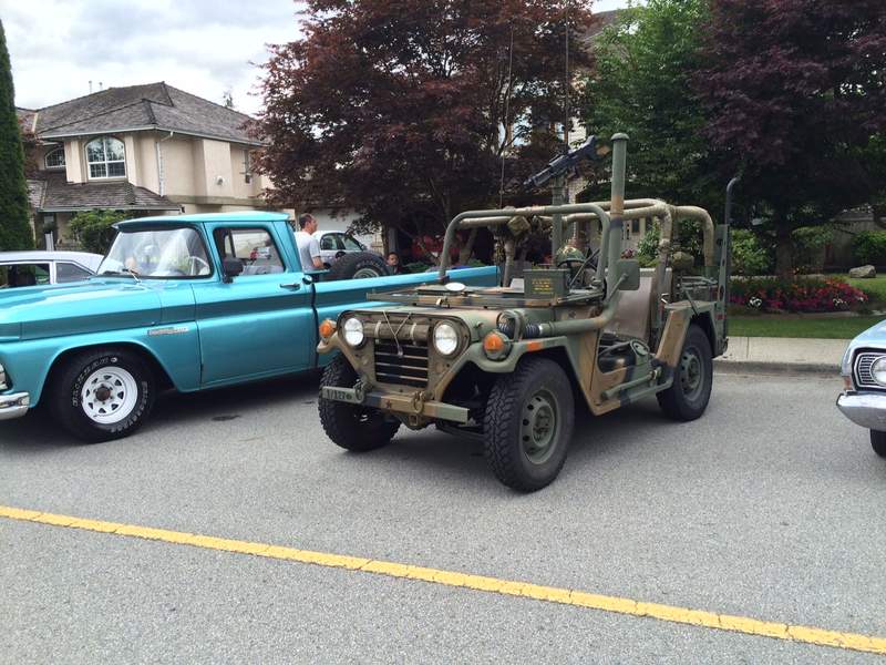

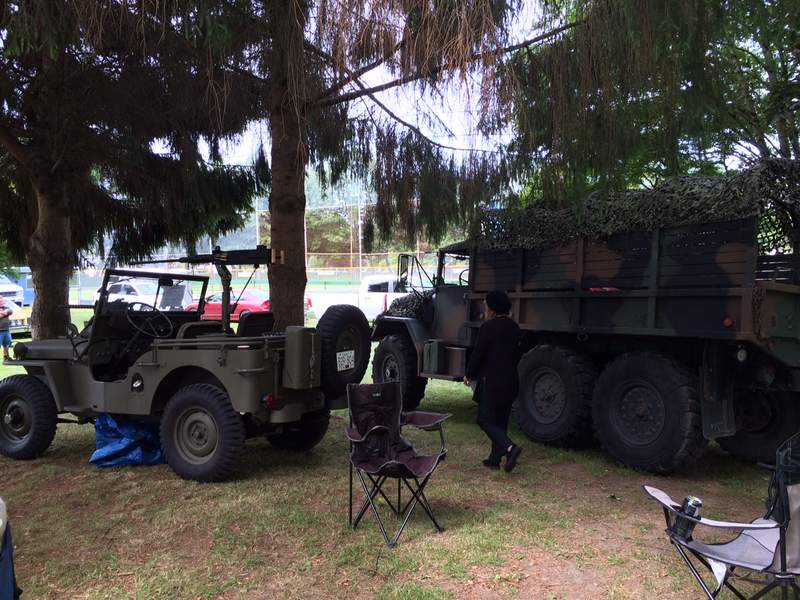

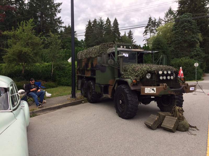

I've been pretty active this year. It's really the first time I've been involved with car shows. It turns out to be really fun. You get to meet all kinds of great people.
Now I would like a gun ring, Combat ready mannequins , and an artillery piece to tow behind the deuce.

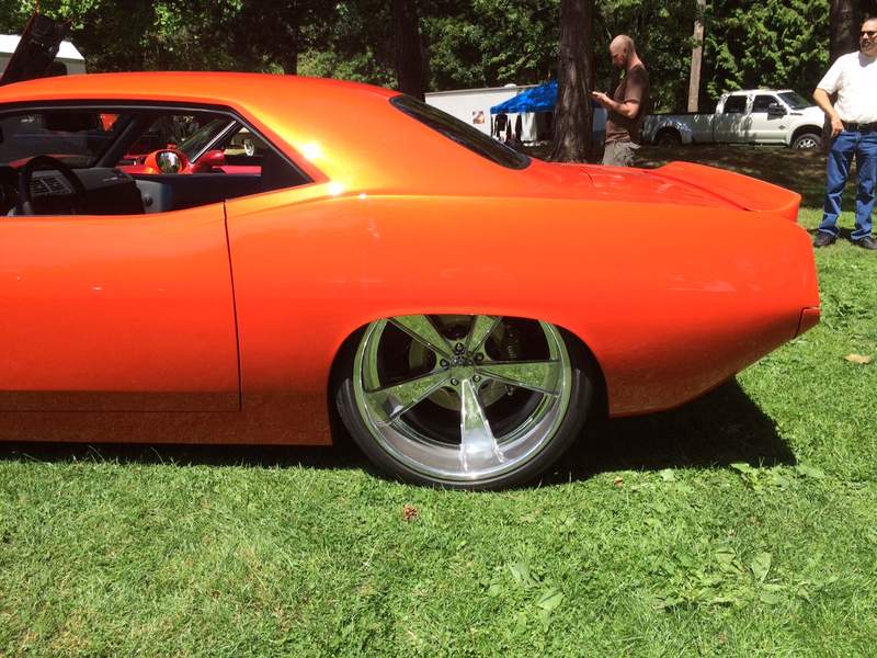

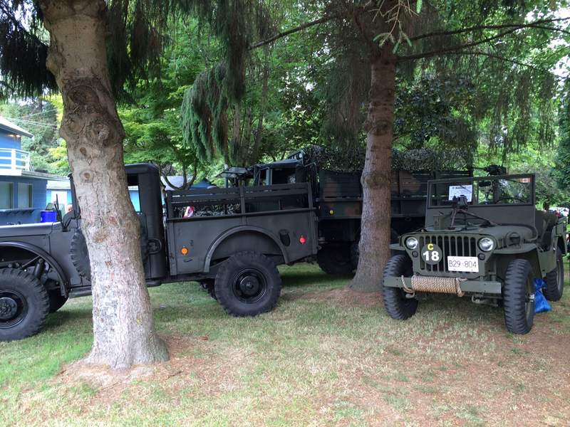

My new best friend ODNorth brought his wrecker out to a charity show. That truck is a beauty, looked brand new. I was even granted permission to operate the boom. That was fun! I only got to experience operation for a short time but I could see how capable that truck is.
Thanks Rob.

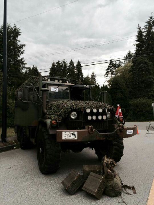

Loose Deuce

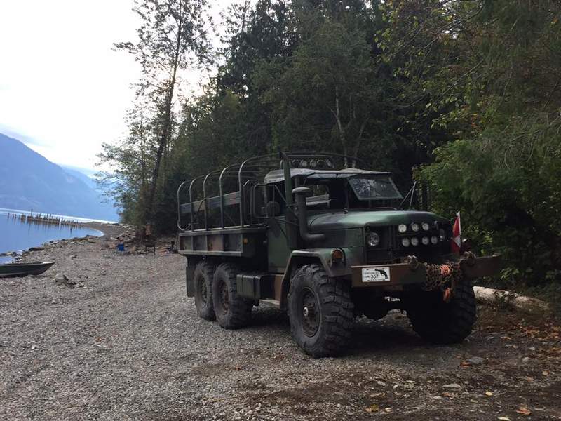

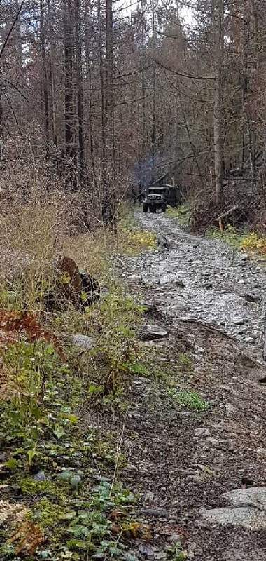

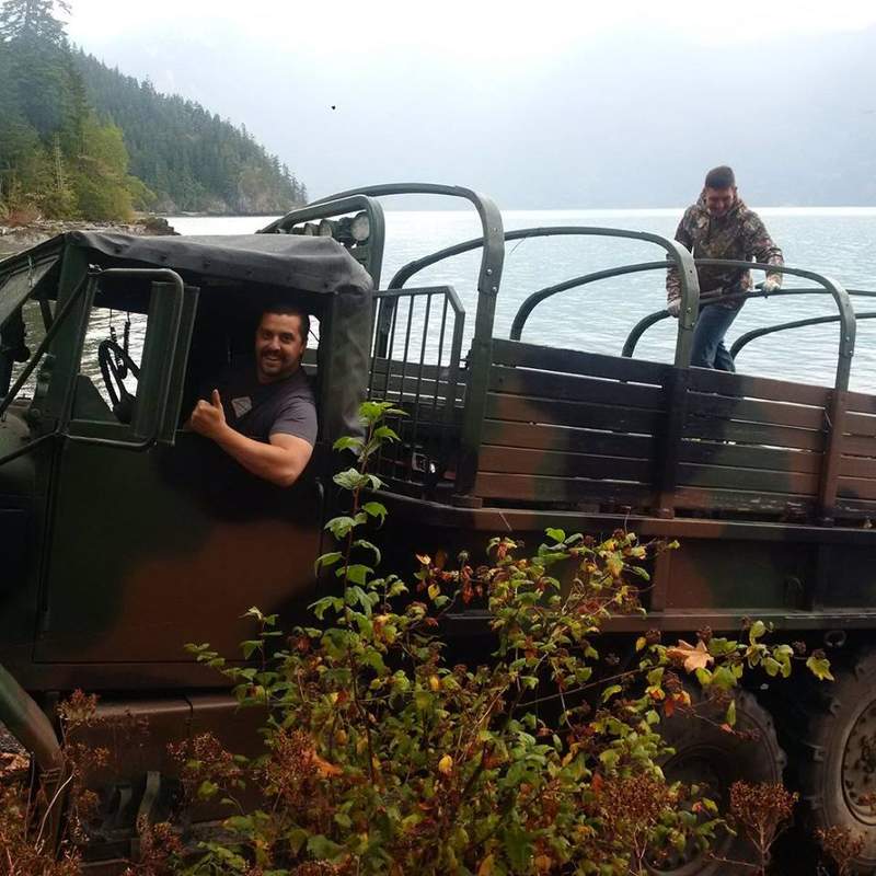

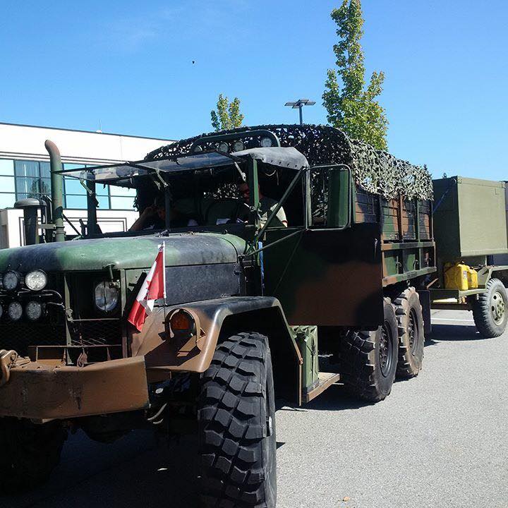

She's being used this summer that is for sure. A few 100 km on forest service road, several car shows, and wonderful memories.

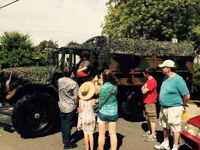

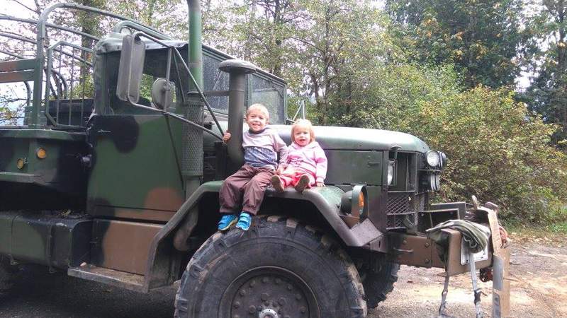

I entered her in her 3rd car show a couple weeks back. I really enjoy watching the kids climb all over it, big smiles as always. A couple young boys were so overwhelmed with fact they were able to sit behind the wheel.....they went into full emotional overload with melt down. They must have returned back to the truck 3 or 4 more times over the course of the day. Really make sit all worth it.

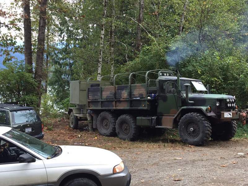

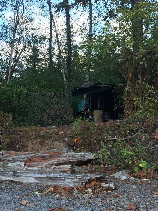

A week later she was back in the remote Canadian wilderness for a 7 day camping trip, no cell phones, no Bullstuff, Just me, my Deuce, and nature. Packed the trailer with gear, loaded the boat, and all the rest of it.
A few friends joined me for the last 3 days. We had a great time. Fishing, eating, drinking, and Shot some rifles too............melting stress with high velocity ammo one shot at a time!

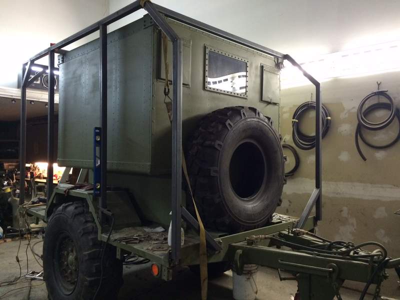

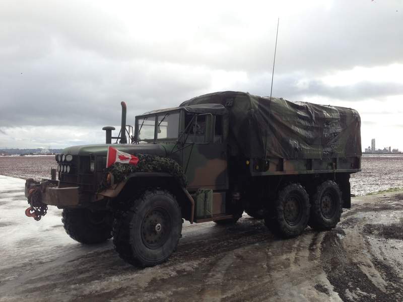

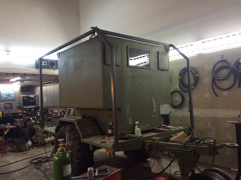

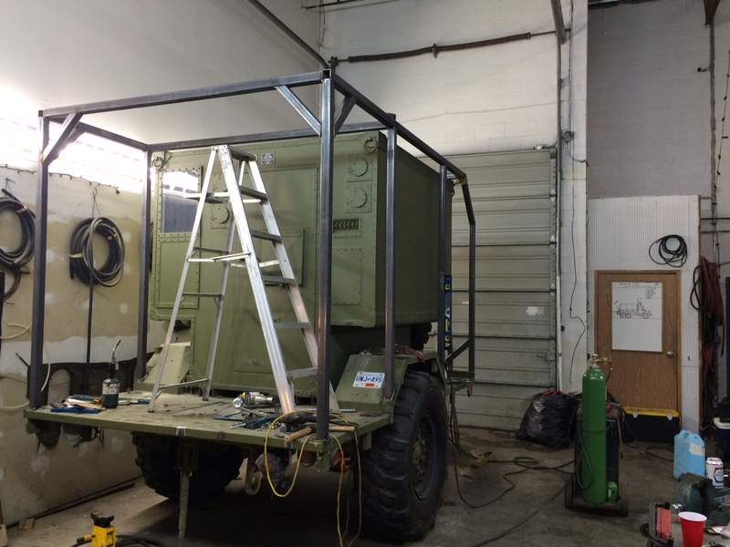

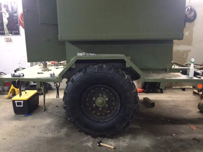

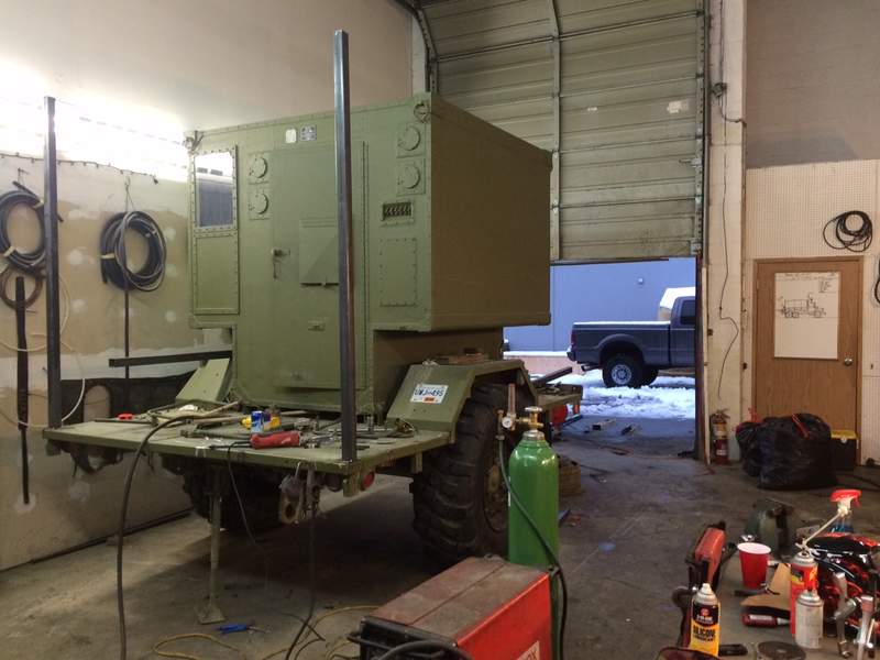

Nov.11 of last year I took the trailer and truck out for one last camping trip before winter. Had a great time and thought of a few ways to improve the trailer.
So to start I bought 4 more HEMTT wheels. Then I mounted a couple of my spare 395's on them. Finally I tossed them babies right on that trailer. They fit nice, I may install some fender flares because the tires stick out about 2 inches.
From there I decided to fabricate my exo-cage. This cage will offer a secure platform to add accessories to the trailer aside from its primary goal for deflecting/bashing trees and debris. The truck will receive an exo cage in the future also.
Plans for this trailer will include an battery bank and solar panels. Storage for propane, small genset, nice bed, heater, hot water, stereo/VHF, and various plugs to run my mobile camping freezer and other electronics.
I also plan to fabricate a 5.5 ft tall Aluminum loading ramp for the back of the trailer. The ramp will also serve as an extension of the deck when lowered half way down. I'll fabricate Some adjustable legs.
Decided to use 2"x2"x 1/8 wall HSS tube. I wanted to keep it as light as possible. Not too top heavy.
I drilled the deck for bolted connections. So I can remove the cage if needed.
I have a few more pcs to tack in to help stiffen the cage up then I should be ready for weld and paint. I also installed my Antenna and CB in the Deuce. I'm looking for a VHF antenna to add now.
