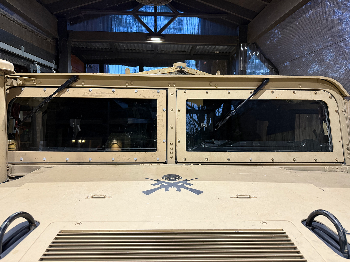

Finally got pictures. The white stuff is the gel layer that melted/oozed out when cutting the edges. If it ever warms up here for a couple days I'll get that stuff cleaned off, it looks like it'd be easy to pick off but it's hard as a rock!

well, I figured out by just removing the plastic layer from the inside is easy but time consuming and the window turned out really nice and I'm working on the second window. I will be posting all my work on my G503 account as I progress with a link to my YouTube videos to share how to do it.

here is my posting working on the IBIS Knockout windows on my G503 account where I post my progress on removing the inner layers of the IBIS knockout windows, there turned out really nice. No more driving with them beer goggles :clinto::driver::usafss:Thanks to everyones inputs and ideas I could not have done this without :tank:.
