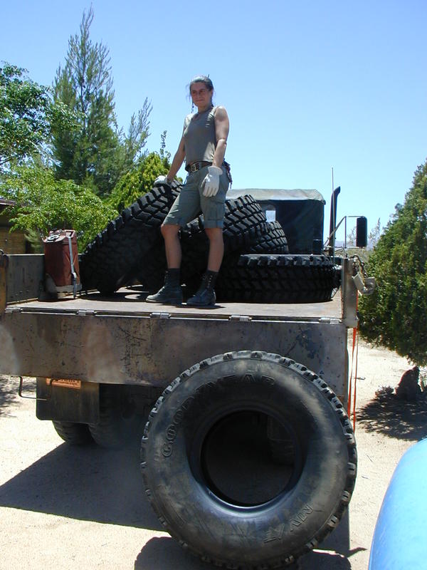

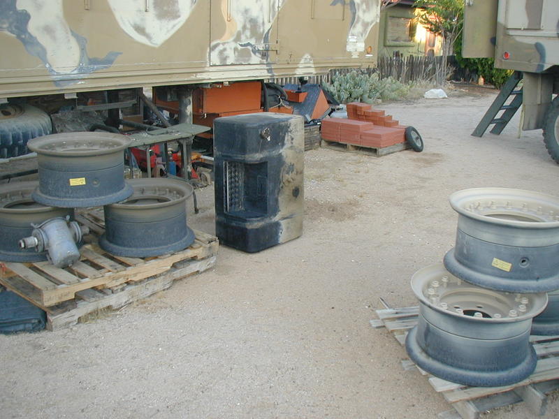

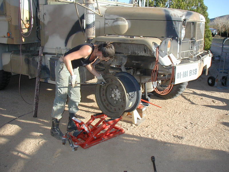

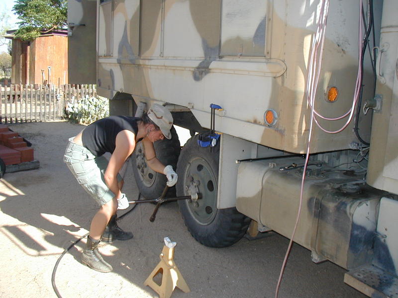

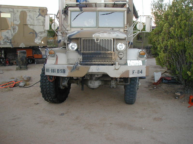

Part of why we bought these rims was the concept that we/ she would be able to change a tire w/o changing the rim . . . for those rare tire shredding situations ;)

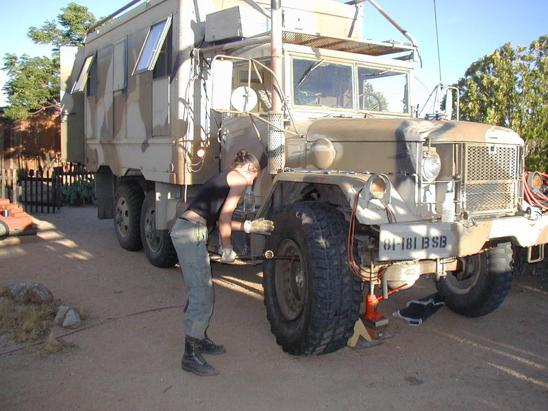

So we mounted the first one w/ that in mind. First we had to mount the rim so that it would stay still while we loosened the nuts holding it together. Started w/ one person in the truck holding the brake while the other did the loosening. We ended up using a m`cycle jack to hold the rim from turning. We know that this will not be an issue when it already has a tire mounted.
After splitting the two pieces apart we mounted the valve stem, soaped the rim w/ soapy water and shoved on the tire. We then added the O-ring.
It took a bit of work to get the other part of the rim to line up right . . . but when it did we were able to get a couple of nuts on the bolts. We tightened a few of them in a star pattern just enough to pull the rims pieces together straight. Then it was tighten them all, fire up the truck, and hook up the air line.

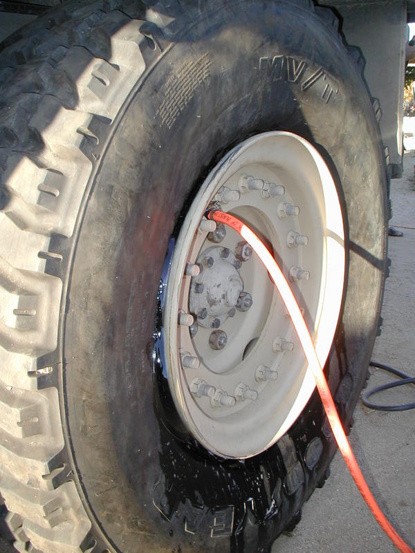

We watched as the tire moved against the rim, all the while spaying soapy water around it on both sides.

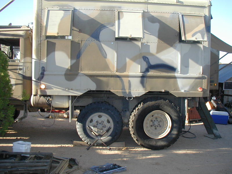

70 PSI and two days later it's still the same.
Now it looks like this, and we know that we can do it in the field.
Only 5 more to go :)

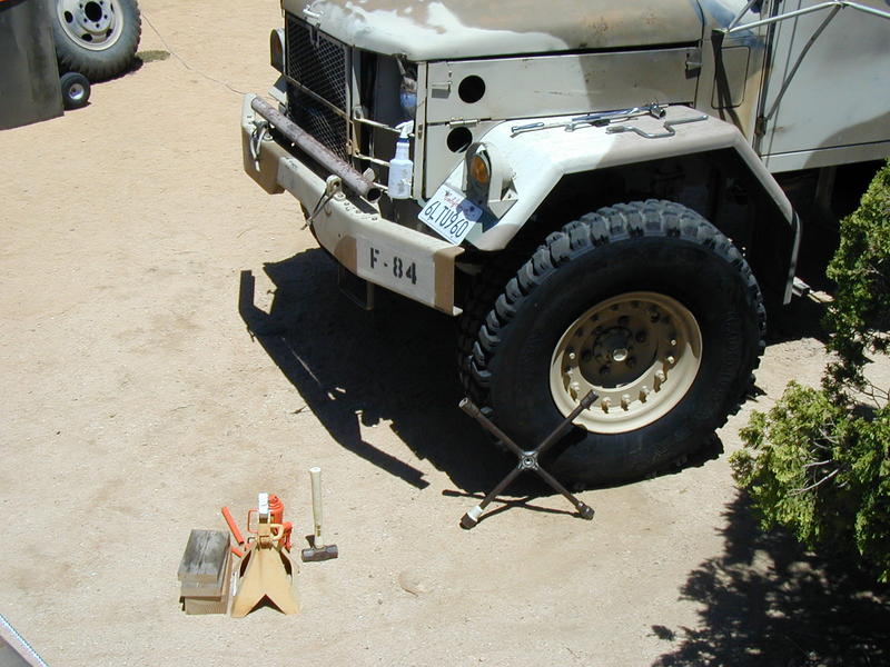

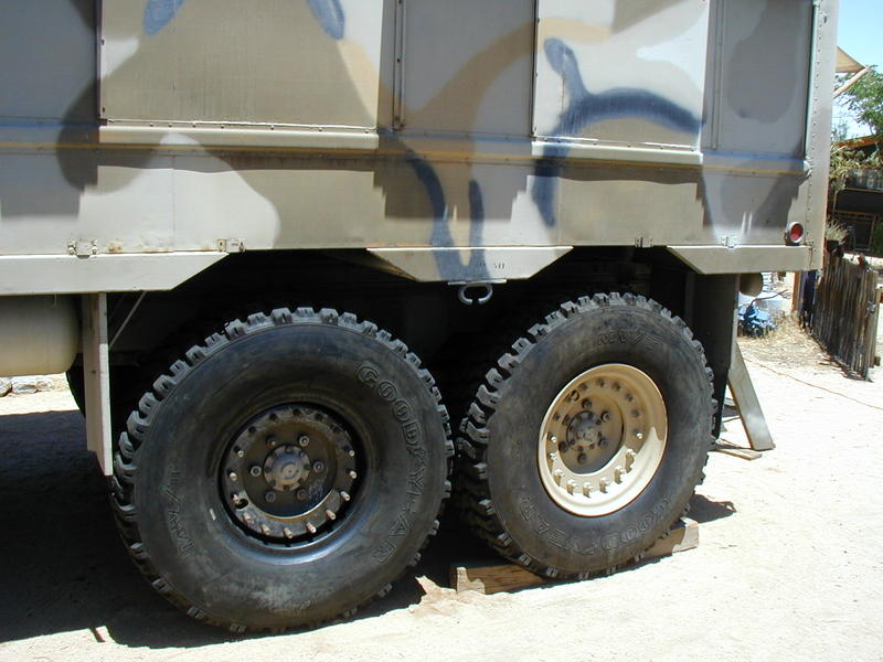

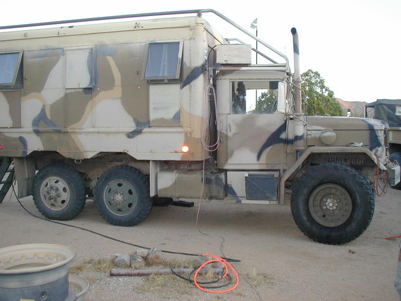

We did one more wheel/ tire mounting on a rear axle, much easier because we didn't have to stop the wheel from turning as we removed the 16 nuts holding it together.
That weekend we had a bit of a party and some friends helped us mount all the rest in one afternoon.
This is how it looked inflating. We did NOT pull the valve core because it would have taken way too long to get it back in w/ the angle and position of the valve stem.
On a couple of the wheels/ tires I used a hand sledge on the middle of the tread (while inflating) to get the sides to move out enough to stop leaking air faster than we could get it in.
The wheel w/o the outer half in place, and the tools that we used (including a spray bottle w/ soapy water & "helper" pipe that lives on the front bumper).

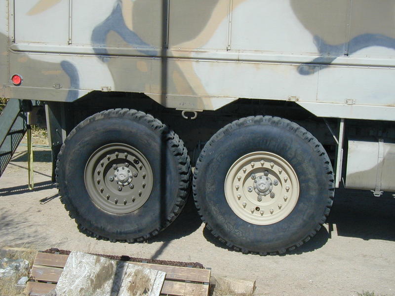

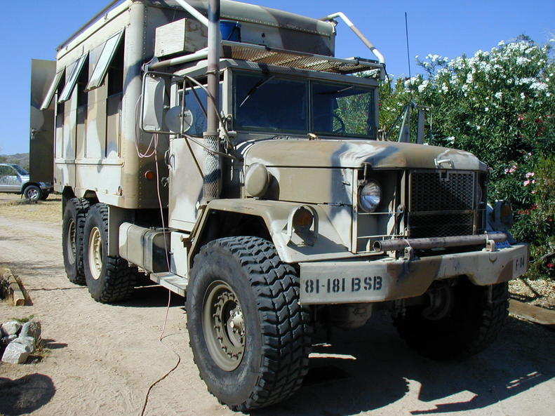

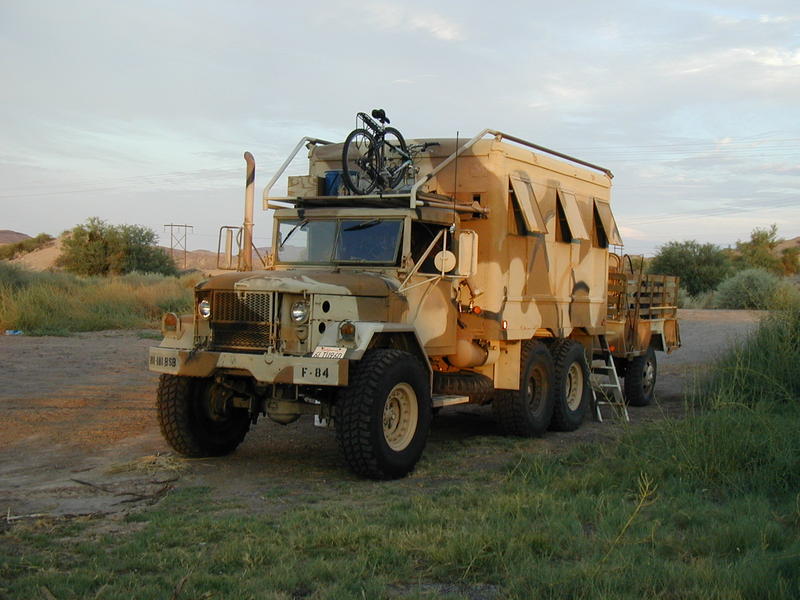

How she looks now.

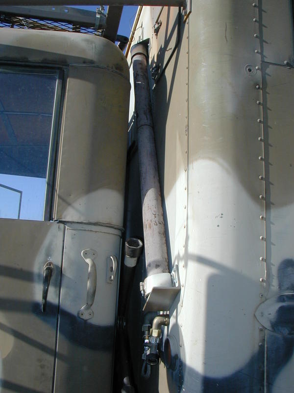

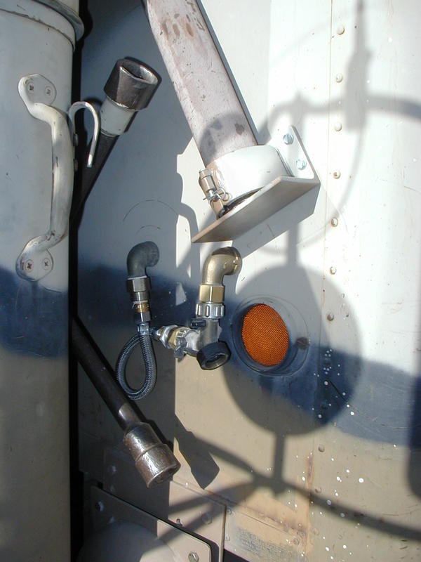

Some of the last mods before the trip,
Added another fill, w/ valves, to the potable water tanks. Now each tank has it's own fill and vent line.

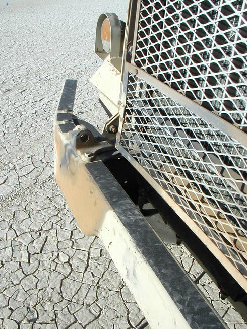

We also moved the "cheater bar", it was getting in the way of walking on the bumper to check fluids.

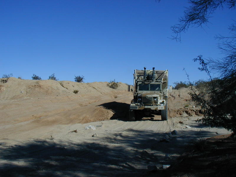

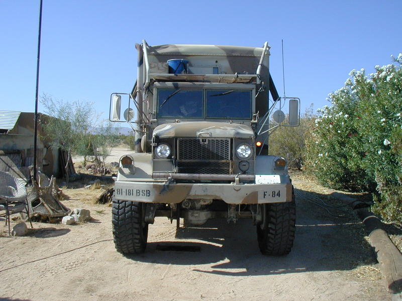

Been a while since I've done any real work on the "She Beast", but that is because we use it so much :) All that usage is in "Dirt Track Travels"
There are somethings in the works though ;)
Here's some of where we've been this past winter,
