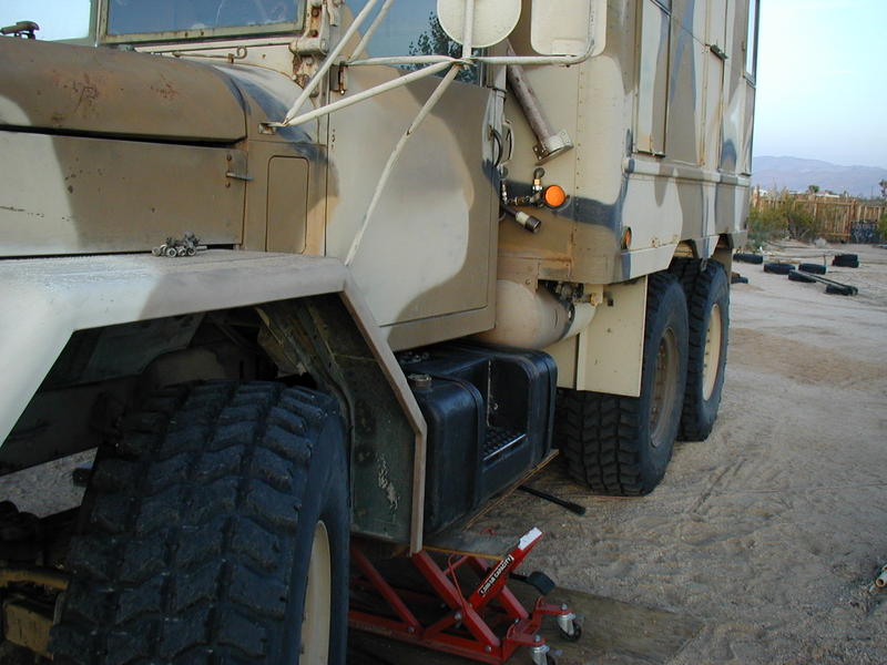

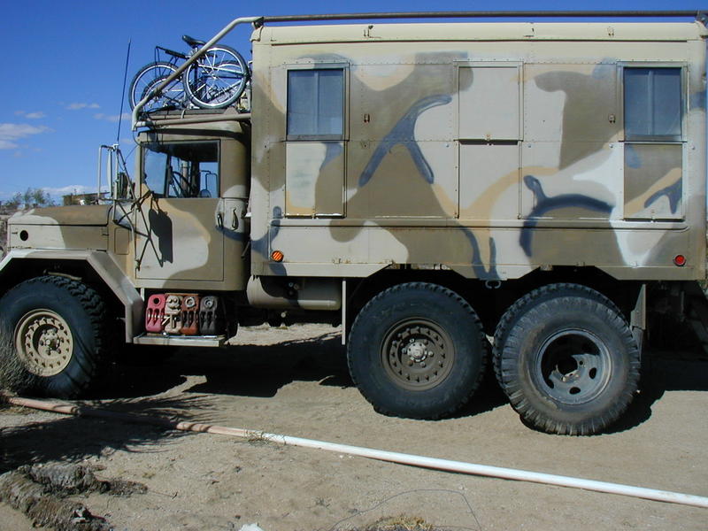

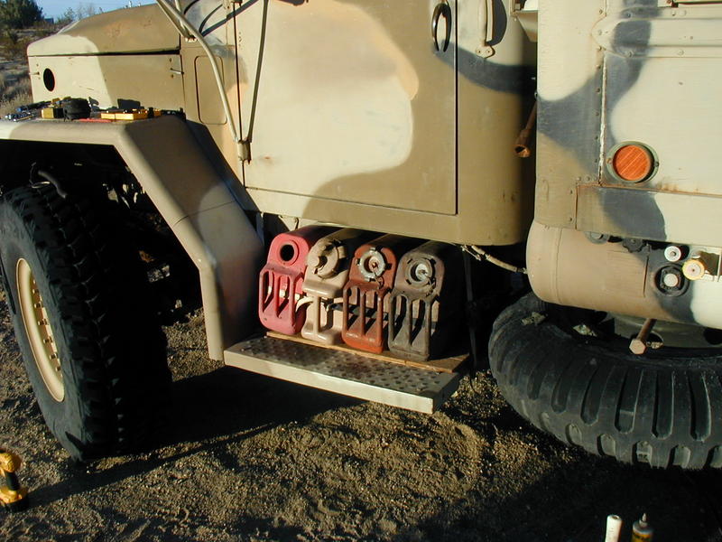

So after a few long trips in the last couple years, we decided that we needed another fuel tank on the trucks . . . of course the She Beast gets her's first.

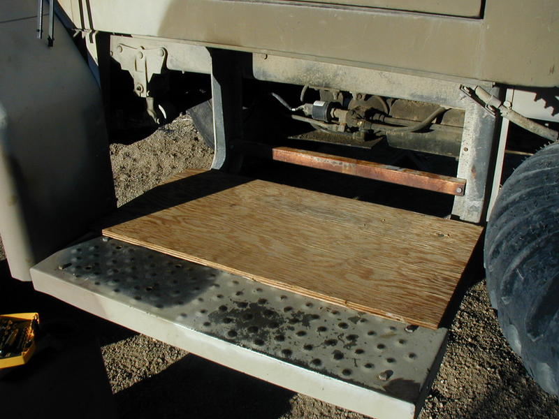

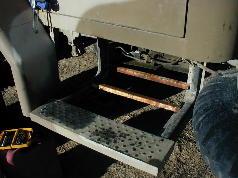

We started by taking off the tool box, we kept the step because we knew that it would take some time (in between trips out) before we would get it finished.
After having it off for a while (getting tank and parts ready) we decided that we were going to a gathering in Anza B . . . which is near the edge of our 50gal limit. So I did this quick mod to hold some jerry cans. If I was going to do this permanent I would add some sides for strength.

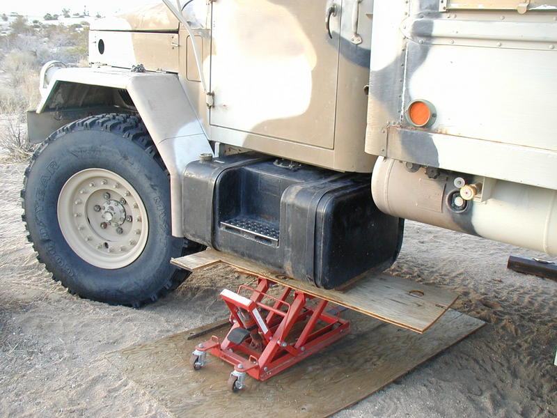

The Tank going in was another 50gal, and a step tank, which I first found was possible from Uncle Mickey (Thank you!)

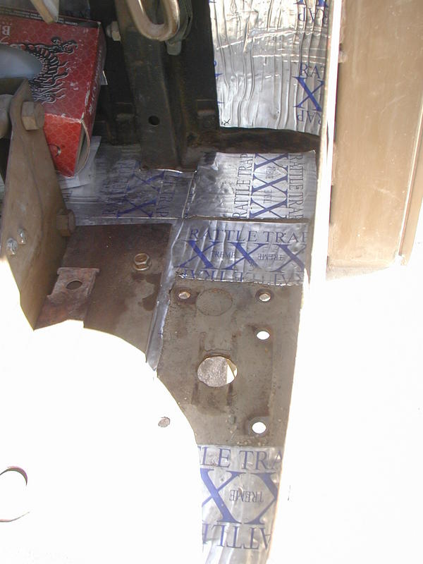

We also know that we will not be able to fit the new tank w/ the spare in it stock space. So we pulled that and the mount. This may end up on the roof rack on top of the box.

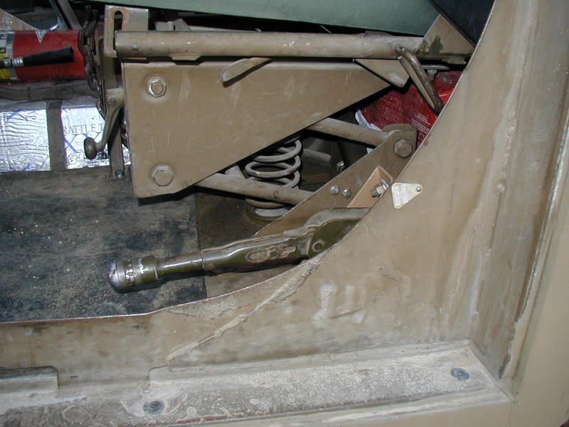

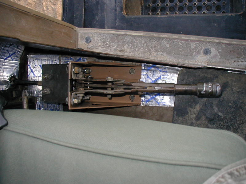

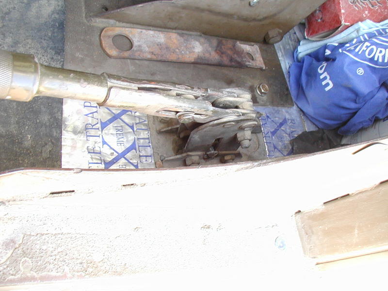

The next thing was that the parking brake cable was routed so that it was in the way. Time to mod :)
I removed the handle from the floor mounting and, w/ the help of a friend, fab'd a new mount. I then added a plate on the floor to cover the hole, to raise it enough to clear some welds on the edge of the floor, and routed the cable through the back of the cab. This of course makes it work in reverse . . . but we can deal w/ that.

Very interested in details about that tank too. Dimensions, capacity, application, etc. Have been looking at step-tanks, trying to find something that looks like pretty much exactly what you seem to have found. Looks like would work with a stock tank behind it?

Nice tank. GMC?
I'm not sure what it came off . . . other than it was a friend's dump truck. I can check.
It's a 50 gal tank @ 95% full. 36" long, 23 1/2" deep, 16 1/2" high, not counting holding brackets. That leaves 36" back to the mudflap and the stock tank measures at 40". It would take some real stuffin' to make them both fit.

I would like to come down to the show with my truck, even though some of the people there might be a bit "different". Seen a few programs on tv about it and it looks pretty cool. But sadly it would be one h ell of a ride for me down there in the M109. Though I might come down one day in one of the other expedition trucks w/trailers I have.
For the fuel tank, are you going to use the original brackets that held the storage box, or fab up some new ones? I picked up some fuel tank mounts off a scrapped M35 a while ago to do a dual fuel tank mod on my truck but never got around to it.
Yeah, Bring down a tricked out ambulance w/ a M416 (or the like) and we could have a "No-Tech" Expo camp :)
The brackets from the step / tool box are not strong enough IMHO. W/o sides on it, it will flex from standing on it (and I'm only 150#). The tank came w/ the brackets and they are much heavier than the ones under the step, w/ straps already as part o them . . . no fab'ing there. Just need to do some drilling.
