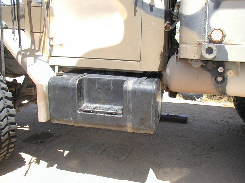

First the step-tank as mounted (noticed that I didn't have any posted that were post install)

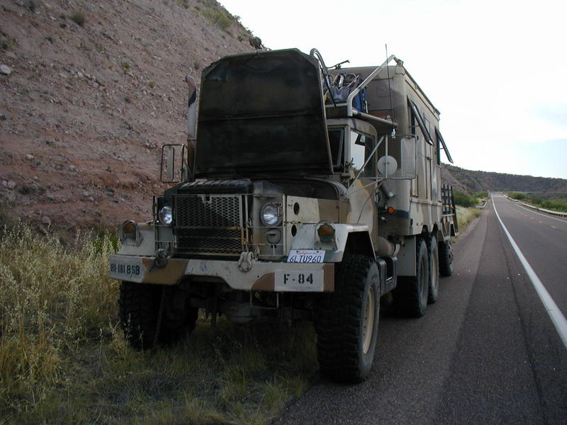

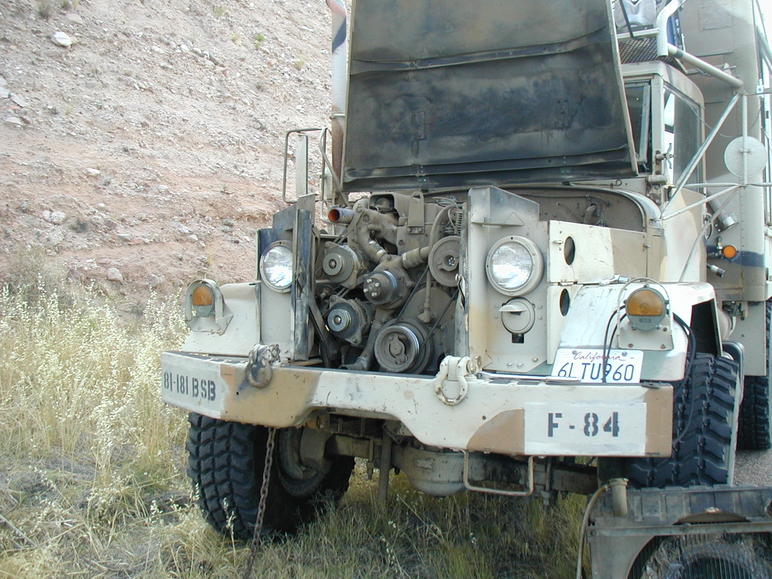

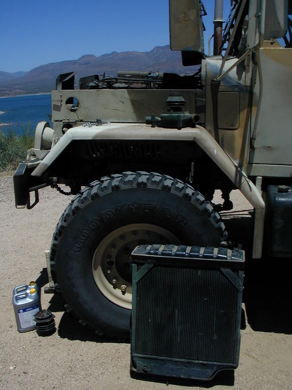

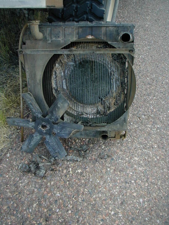

Then I took a roadside rest, on my `Zona Solo" trip, so that I could "upgrade" the Rad & Waterpump. Now She has a Rad that doesn't leak, and a Waterpump w/ bearings, . . . He!! of an "Upgrade" they work so much better now ;)

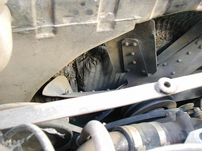

Hearing a drive-train paced thumping as vital fluids sprayed back onto the cab's view-port left me w/ a sick feeling.Once stopped I could tell that it was a gutted heat-exchanger, . . . the Rad was dumping the last of it's fluid on the ground.
Quick, I grabbed 5 gal off the rack and caught the last couple gals by opening the petcock. Never waste liquid out here in the dez.

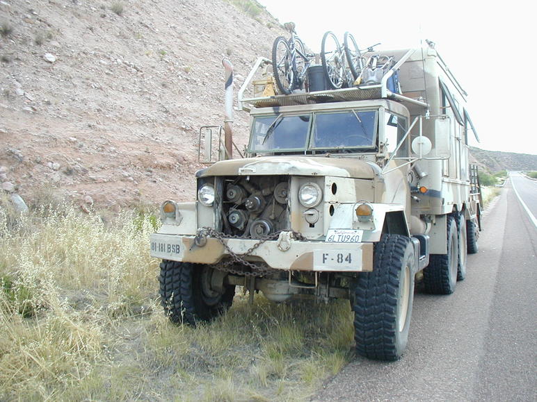

Waiting hours, till that burning day-star moved behind the ridge, I pulled the affected parts.
Now to move her, as short a distance as poss. I like to choose my "multi-day" breakdown spots ;)

Now safely encamped above the lake, among the blooming saguaro, I install her upgrades (Thank you Castle Bravo!)

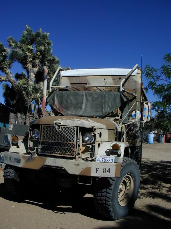

Hey, Wolf is that the truck you guys brought to dirt bag? Thats some nice work! Was in your hood a few weeks ago 29 Palms. next time ill stop and check out your set up.

BarneysZ - yes it is, Thanks :)
If you're going to drive by that close, . . . you do need to stop.

That looks like the fuel tank on my 88 International. I'm putting duel tanks on all my trucks, to add range. I run them all on WVO. 100 gallons will get me far without costing $ !

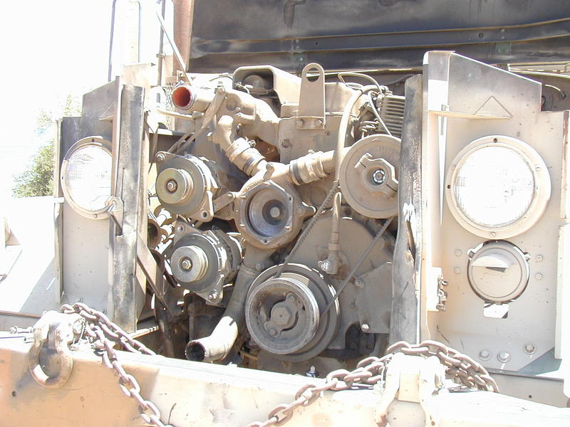

What'z up with the second alternator or ac compressor?
It's a dual-alt set-up, 24v & 12v. The 12volt supplies power to batts for the living space. No dead starting batts after an extended stay somewhere, even when we have the music & lights on all night, . . . for days ;)

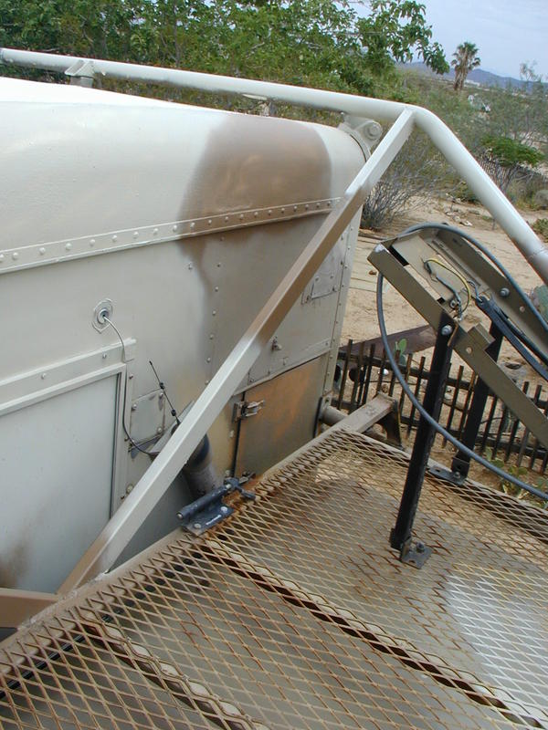

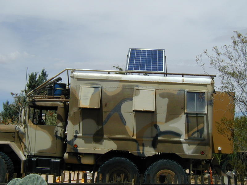

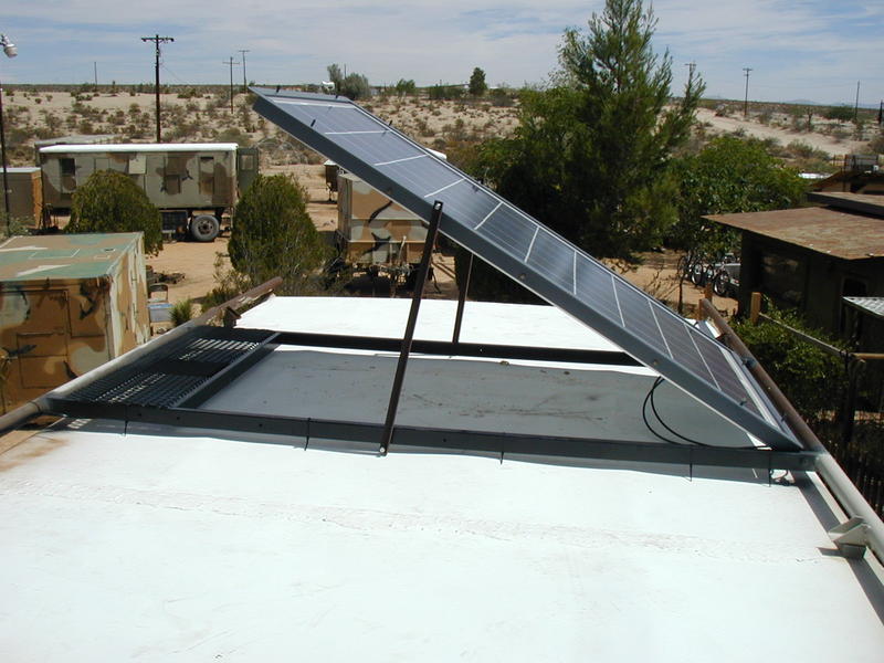

Now some of the latest Upgrades,

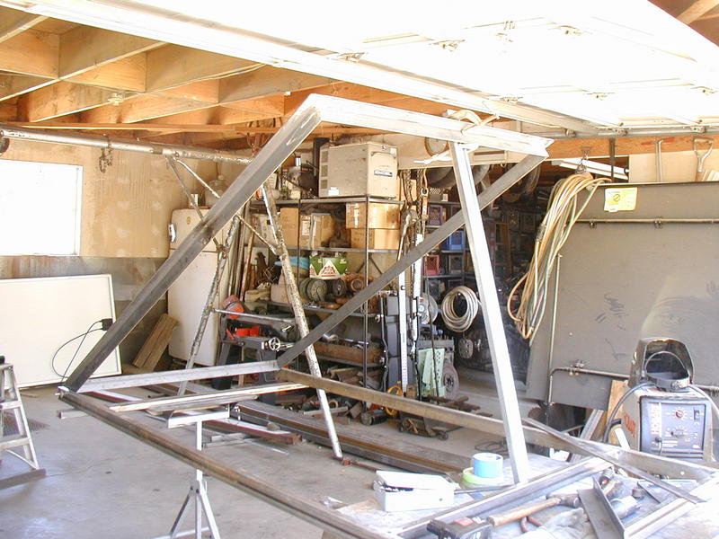

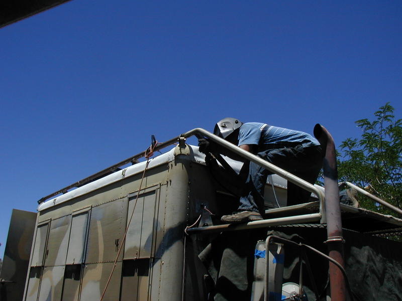

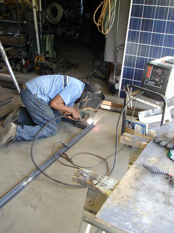

We had been having some probs w/ the cab-over rack, mostly that we did NOT have enough clearance between the hardtop and the framing of the rack. It was also starting to sag some in the middle, adding to prob #1.
This was the perfect time to do some of those changes, we were going to be adding framing for a solar panel anyway.

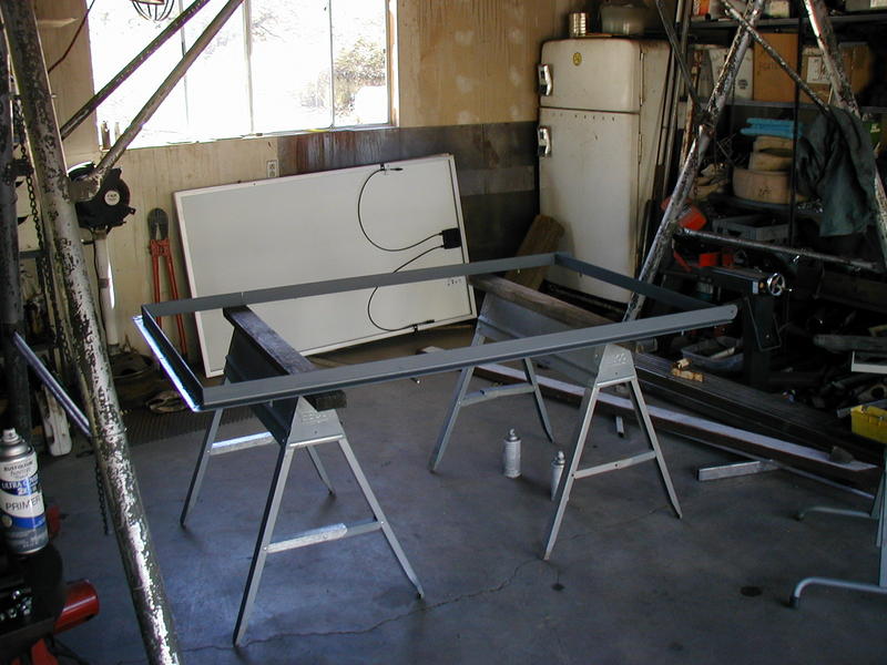

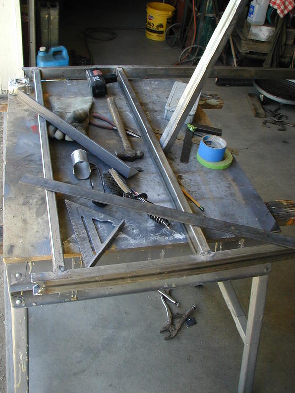

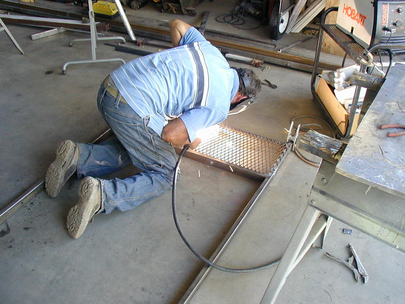

We started by making a frame to hold the panel itself,
then the framing that would hold the "panel frame" between the rails.

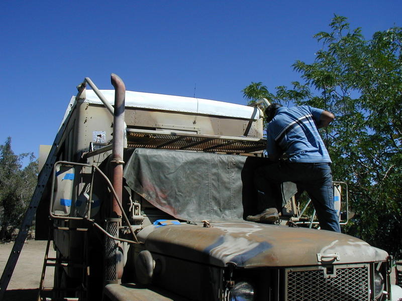

As you can see we had also "roof coated" the top w/ some mobile home roof-coat. Between the roof-coat, and the long term plans to rack most of the space between the rails as a "tropical roof", we would cut down on our "solar gain" through the ceiling.

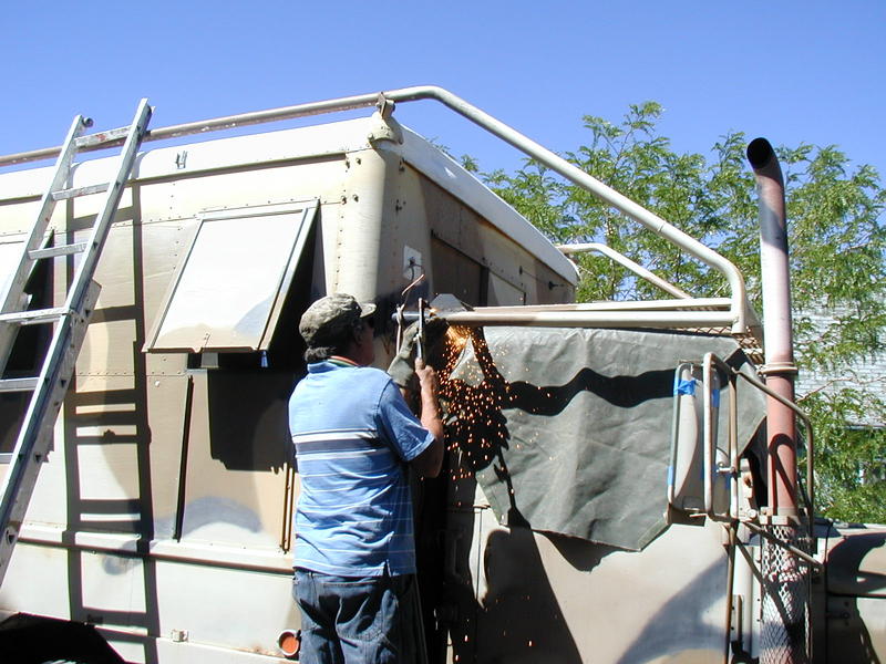

(note: that's not me in the photos, that's our buddy up on the mountain . . . metal worker, instrument builder, MV extraordinaire, collector of old things ;)

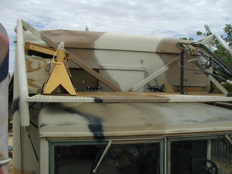

While we were up there we cut out the cab-over part of the rack. We moved it up about 4" and welded it back in place. We then added supports between the rear of the floor in the center, and the rails on the sides.
Now it looks like this, and it's way more rigid when we walk on it :)

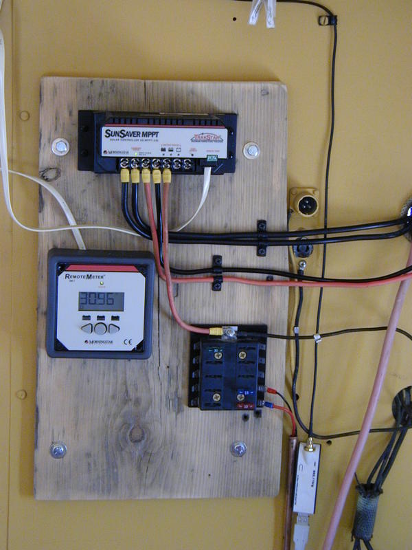

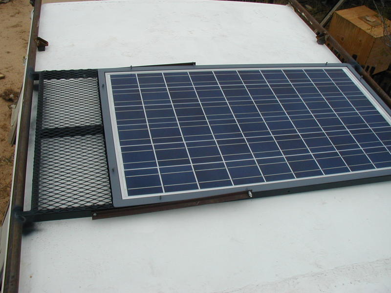

The finished solar set-up,
A little bit of wiring and we are almost shore-power free.

What's the battery plan..? Are the solar battery's separate from the truck battery..? My plan is to cut a hole in the floor dead center between the frame and lower a 24v gell cell forklift battery and mount it. The charge controller would keep that battery charged and when its fully charged to 28.5 constant the diverter load would be a block heater to keep Mr. Multi-fuel warm. Then run a 24v inverter to all the 120/240v power requirements.

Looking good, how much dc charge do you get from the panel?
The panel has been maxing at just over 32v.
They are separate and we already have been using them from back when we first added the duel alts. Unlike the kick a$$, high tech / high cost (at least for us) stuff that you do ;), we just have a couple 6v interstates wired as a 12v. Right now they are on the rack, but they will get moved down behind the LP tank (where the spare used to be) at some point :roll:
We're keeping the living area 12v for ease of parts. There's not much that we need power for, lights, music, fans, charging the laptops & phones, a fridge (coming), and almost nothing that we need 120v for. We do have a small inverter if needed.
A life time of off-grid living has kept me from getting things that need such power, . . . I hardly know when the power goes out ;)
