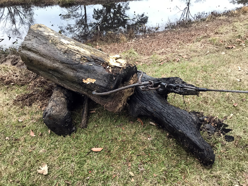

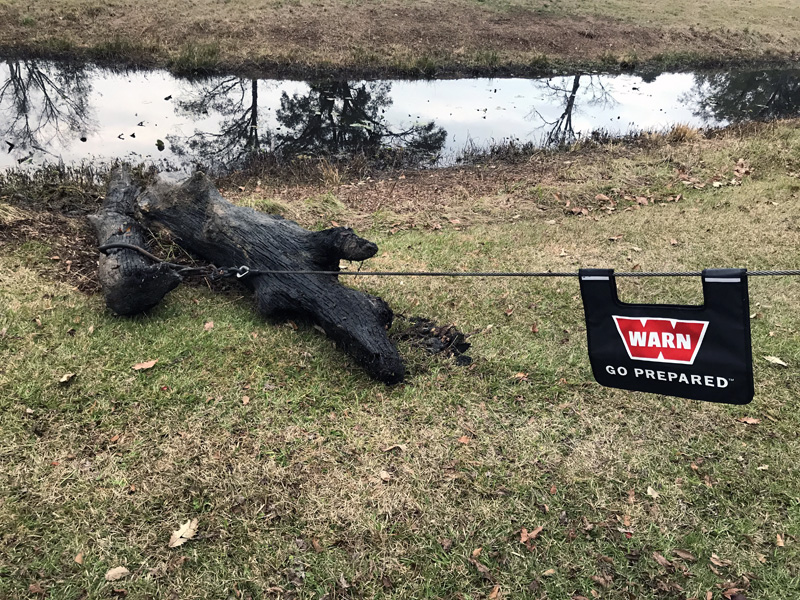

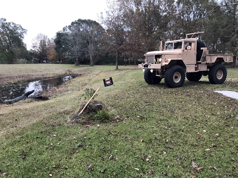

Used the Warn 18k winch on my bobbed deuce for some landscaping duty. Pulled a sago palm and a (?) tree out. I used the spare tire from my daily driver as a fulcrum. Apologize for the vertical video from Soldier B.
Geez Hank, I've always wanted one of those Warn 18K 24v winches myself. Too rich for my pocketbook. I'd need the bumper extension kit too. C&C Equipment sells them both as a kit or separately. Glad to know you're well and to see that Ahab is here too.
