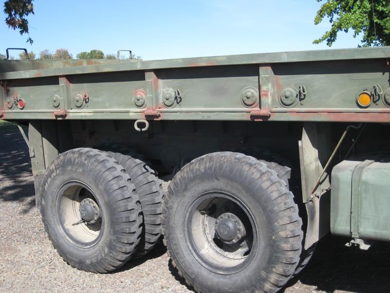

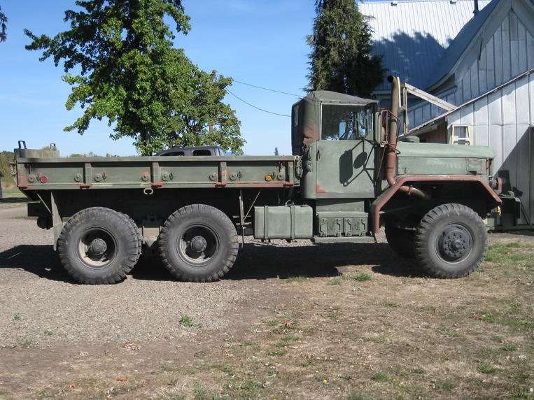

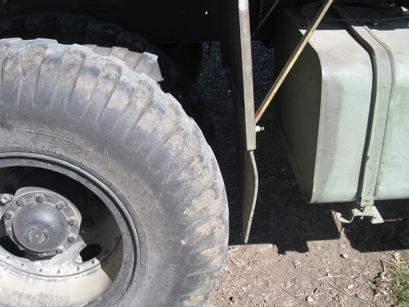

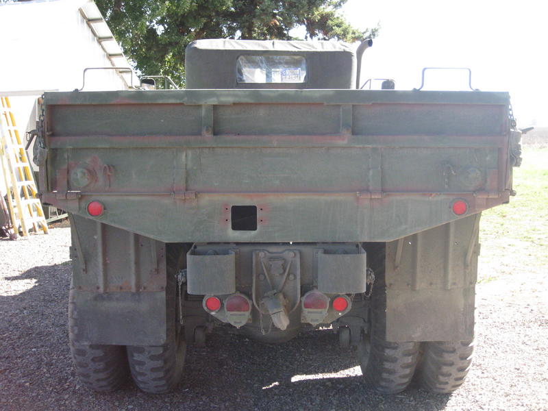

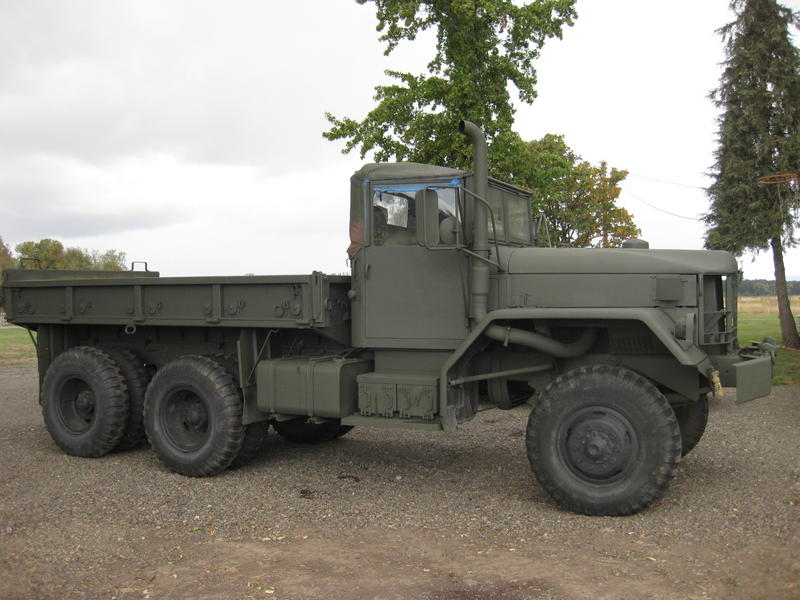

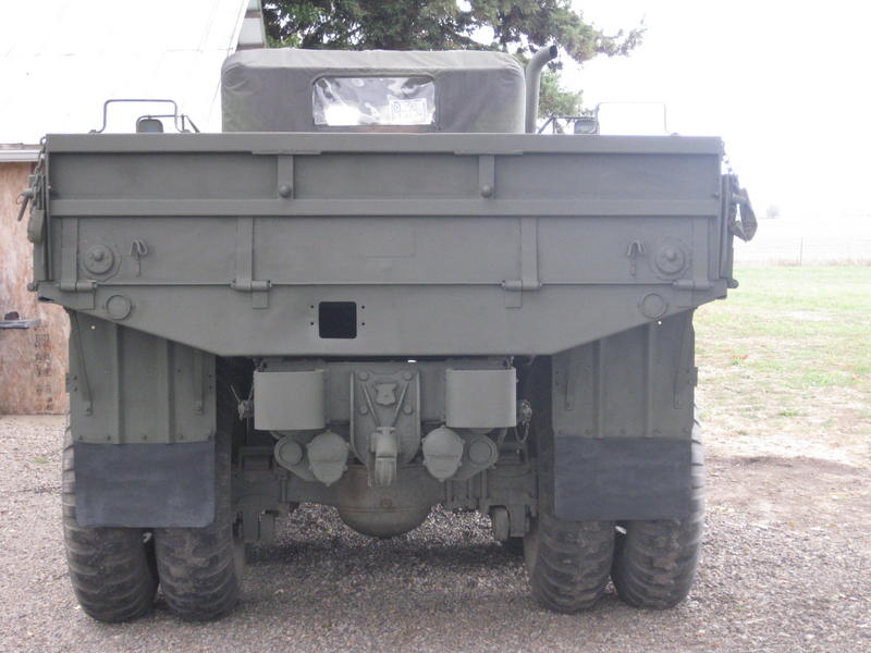

Here are the pics with the doors back on and the mud flaps back on too. At the time I did not have a welder and the front flaps are off of an M813, so the legs were too long. I played around with the torch some and bent them to work. (ie when fueling the drivers side tank) kinda different and strange I know, but they work and look good.

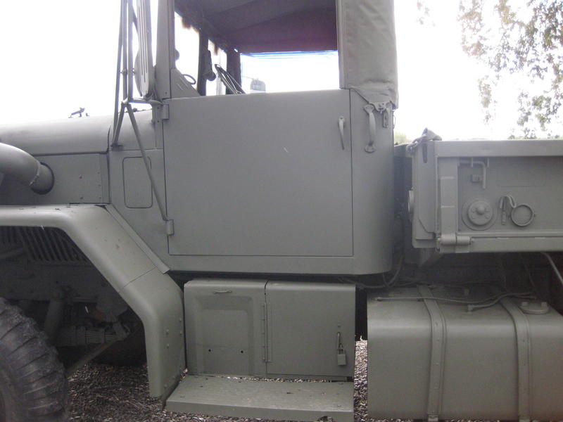

I got my pickup fixed today, so I will get this old girl washed and masked off to start the paint this week. You can see where I got rid of any surface rust where two pieces of metal came together on the bed. Thats why there are little sprays of primer all over her. I will post pics of the paint job when I am done.
I am using Rapco current issue olive drab. (lusterless)

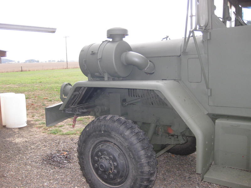

Is that a muffler on the stack ? If so what kind is it and does it knock down some of the noise?
Cherry Bomb Glasspack Muffler 5” BODY, 12” OAL 4” IN / 4” OUT
P/N 87528
I have the stock muffler off and added flex pipe to connect back to the stack. It sounds WICKED AWESOME, but boy it has an ear piercing bark to it. I had that muffler laying around, so I threw it on there and it make it tolerable at low speeds. It is ok to use around my farm without ear plugs, but get it out of 2nd gear and you better have something.

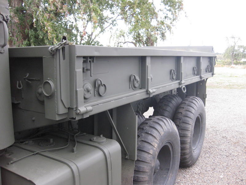

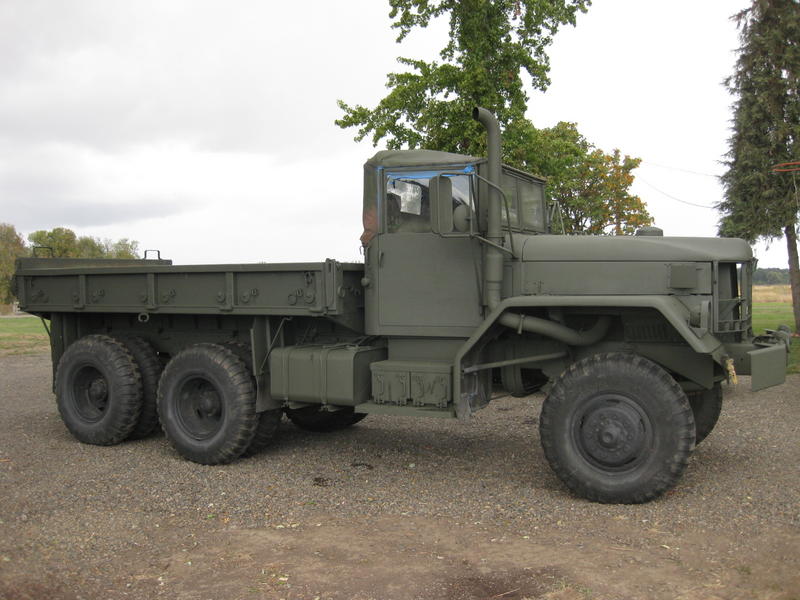

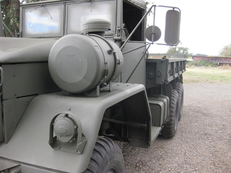

Yes I did the paint my self, just before the rain came too!! I am working on getting pics up right now so check back in about an hour or so.
Painting it was easy. Used Rapco current issue OD. Mixed it around 20% with xylene. used a detail gun on some of the little things and a big gun on the rest. Painted outside with wind at times and it came out great. The hood needs another coat, but the rest is done!
bigelk50
932
13
albany, Or

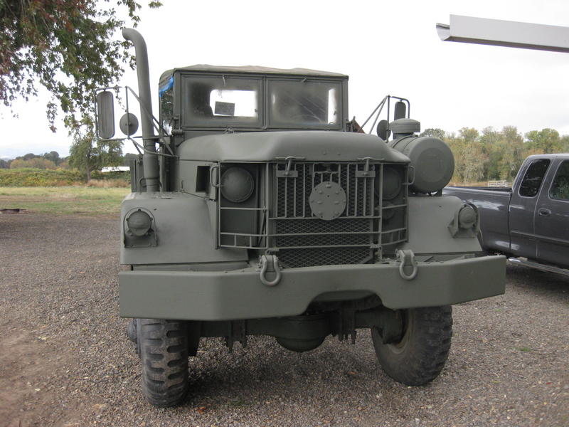

Ok here are the pics. I need to actually paint the inside of the bed, the hood and a little touch up on the passenger side. I also need to take all of the masking tape off and de fog the windows. I was cutting it very close on the rain so I just put a 1" strip around the frame of the glass and decided to take off the over spray paint off later.
Now I need to order a bunch of stickers and do some stenciling. Then I will get my winch rebuilt and installed. Then it is on to making a center console and jump seat like we did in the deuce.
One questions I have for anyone is...
Can I paint my soft top? I was thinking of making the truck all one color. Right now it is a 3 color camo soft top.
