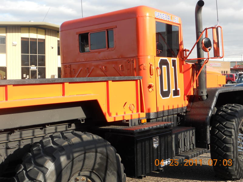

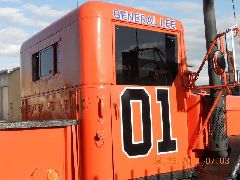

Build is almost complete, We have checked all the fluid levels, changed engine oil and filters, greased everything, we allready packed all the wheel bearings when we flipped the hubs, Belts sqeeled(sp) so we tightend them up, We drained the coolant and seemed to have a some oil in it, we have been running it with water so we still need to drain and install antifreeze and change the fuel filter.[thumbzup] Below are the latest pics, Oh and I think we will install a dixie horn just for grins.:lol:.
Ladies and Gentleman Meet The General Lee

I don't know enogh about it, but is the rear slider stok or custom? And will you be installing a bullet muffler or something so people (and you) can hear the Dixie horn?
It looks great btw. Do I spy a spray or roll-in bedliner?

The rear sliding window is stock, The truck is relitively quite compared to the duece. We used rollon bedliner (I think Hercules) from the local auto store, We used it on the bed, the fenders, side steps and the top of the bumper. We used the same stuff on our duece and it is great, tuff and does not come off. We used spray on bedliner on the front of the bumper and the aircleaner housing, its a lot smoother and not as tuff, looked real good when we first applied it, just driving around the chain on the bumper has worn some of it off.

very nice job !---mean looking and well executed
like the look of the lights on the rear of bed....but -dont you get hassled for no rear fenders and non DOT marker light spacing ?.....local PO-LICE here would write up both
We have put about 150 miles on locally with no problem. Not sure what the DOT marker lighting spacing is but we do have 3 yellow marker lights and 1 red marker light, one yellow one is at the front of the bed, the other two are mounted inside the fender well as is the red one, probaly not DOT but you can definetly see it at night, This truck is going to be primarily used off road, we have about a 2-3 mile stretch of 35MPH road to get the beach.

I like your spacing of the oblong lites better than DOT standard (three in center---one on each corner)....looks like a HD version of something on a hot rod....was just wonder'in is why I asked
With your obvious skills - was surprised that you didnt fab up some fenders for the bed to match the front .....but since your using it off road - guess the rooster tails will just go a bit higher now....:-D

My original thought was to build fenders wide so we could walk on them. Then we set the 101 bed on it looked cool being only as wide as the cab. We still used the diamond plate pieces on top of the tank so it's still easy to climb in the bed. We also were goig to put the running lights on the top rail of the bed but we got lazy and did it the easiest way to route the wiring.
