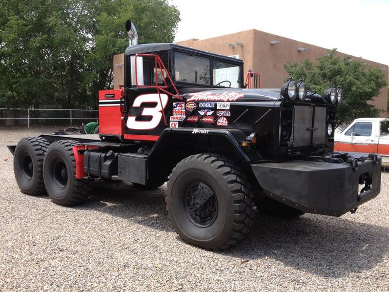

Great build and well done on the fab! You said you would be using it to pull boats and vehicles out of the water. Do you or will you being doing a bunch of this and what has been the reaction down at the lake? Vids of that would be wonderful. Again great build!

every once in a while you might get a lil crowd if your pullin out someone who has been stuck for a while. someone who has already had a few normal vehicles try and fail. as far as the putting the boats in and out of the water there isnt really a reaction. there are probly more than 20 other mvs and 6x6s at the lake already. lots of people use them for the same thing we do

Thanks. We took the truck out this weekend. Seemed to work good, after a coule days it got a little hot (205) so we starting checking a few things with the advise from a good friend. He was right about what to check we found water in the oil and lost some water from the cooling system. So I guess we either have some pin holes in the liners, bad head gaskets or a cracked head. Brought the truck back and will continue to work on it.

Truck turned out to be an oil cooler and not as difficult as we thought. My son took the truck to the lake and it worked real well. The winch worked well probably better than expected. I think we may install an ammeter in the cab because with the truck running you cant hear how loaded the winch is.[thumbzup]

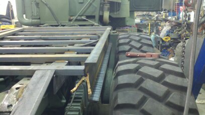

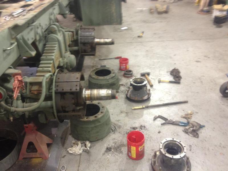

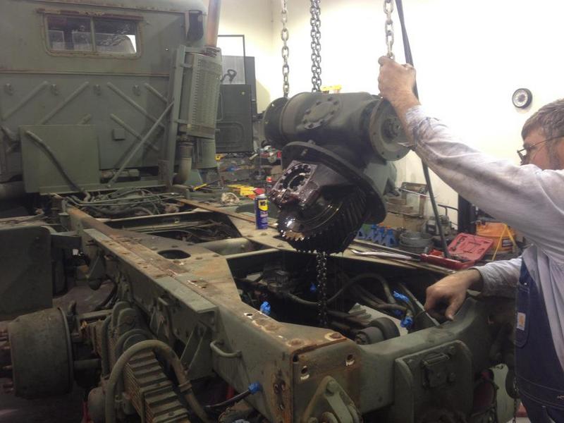

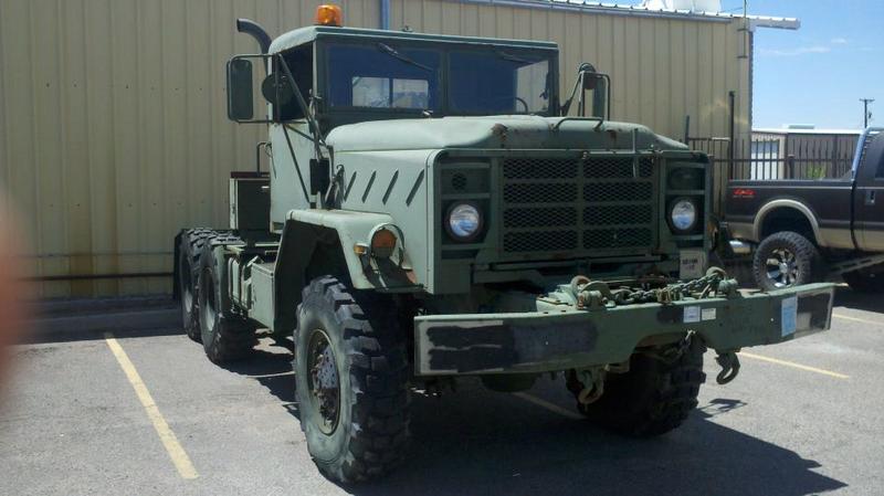

The build starts when we recover the truck from Gettysburg PA. Left Albuqeuque NM on a Thursday afternoon flew to Pittsburgh, picked up truck Friday morning, 1900 mile trip back, had a few issues but rolled into town early Sunday afternoon.
1- Installed lockers
2- Packed all the wheel bearings and changed all the fluids.

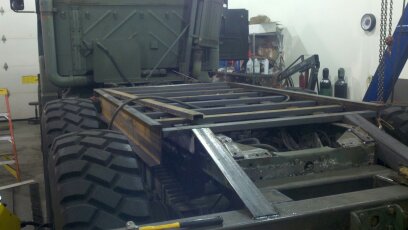

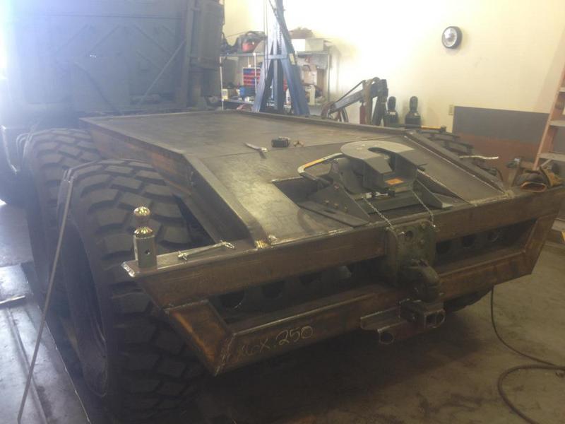

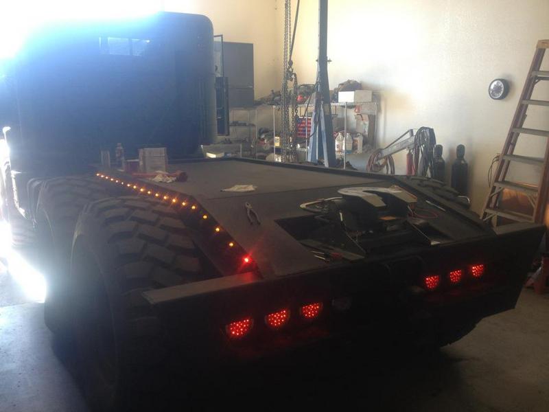

3- built new rear bumper and bed with dove tail and a lower 5th wheel to hual our trailers.
4- Installed a new 6" straghit exhaust
5- repaired transfer case shifter and disconnected lock out solenoid

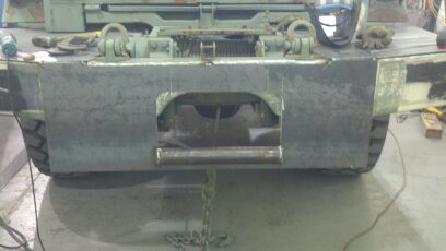

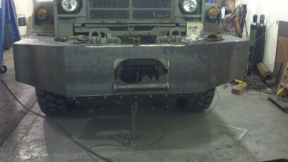

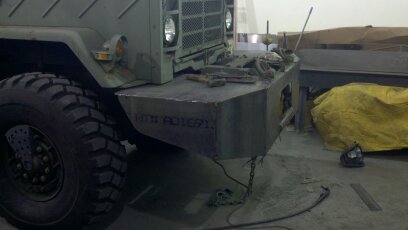

6- Modified front bumper
7-installed a few extra lights
8. paint inside and out
9- built a new grill over the existing grill
10- installed a 15KW whisper watt desiel generator( to run our campers when we go camping
11- installed some graphics
12-serviced transmission
13- installed CB
