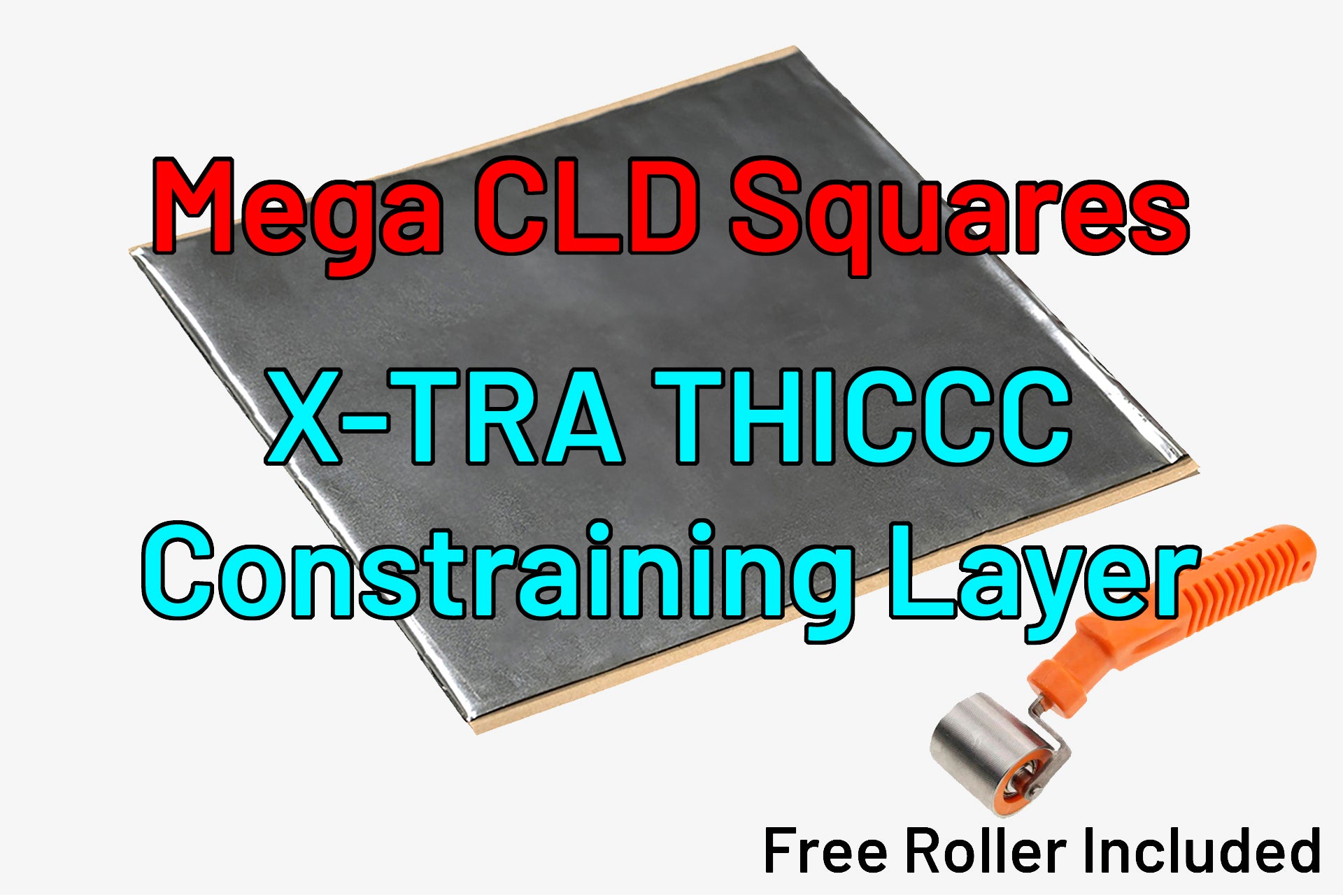

I wanted to add some input after I finished doing my sound deadening and interior install this summer. I used these products everywhere there was metal inside the cabin as well as the top.
1st layer I used sound resonix butyl sheets after throughly cleaning.
2nd layer I used a siless foam
3rd layer I used a foil line sheet of plywood for the hatch and tunnel cover and for the floor was a horse stall mat
4th layer for the horse mat and plywood was an all weather boat carpet
Some other things I did to sound deaden was seam seal every crack, weld every hole, rhino line the outside wheel wells and floor boards as well as added sound mat under the hood.
the results were astounding with idles as low as 60db and highways in the 70-75db
I added a sound system and it sounds pretty much like a normal diesel truck from the inside.
I spent overall around $1000 for this result and it was well well worth it!

To be honest I wasn’t expecting it to be that quiet either but the resonix is by far the best material I have ever used and that’s after dynamating the whole inside of my ls3 swapped rx7. The proof is in the pudding and like I said I am very very pleased with the results. Now there are factors that maybe you may not have or consider like the extra rhino lining underneath, full interior with leather seats including suede headliner and console, hood insulation, fan clutch and probably the most was the tires and wheels being changed.
Here are the test results for product being used as well as the decibel meter during idle which is kinda high as I see it in the low 60s

Well it’s too late for me to use resonix brand, unfortunately. but I wish I had known the cost difference, while significant, seems worth it. The Siless branded buttl liner I put down didn’t really seem to do much.
