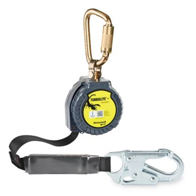

report back your success/failure. One thing those rams will NOT have is a safety check valve like the OEM ram does. Granted the safety check valve my well be what is the issue. They prevent sudden fall of the tire if hydraulic issue occurs.
I found a possible work around if one is safety conscious person. A seat belt (or system like it used for fall protection ive seen used ones...see link below) as in a seat belt that will belay out slowly but if it goes fast (like a fall) it snugs tight.... aka- how shoulder strap of a seat belt works.

you can buy inline velocity valves(hydraulic fuses, velocity fuses, velocity checks) that would perform the same function as the safety checks in the OEM cylinders, but they are not particularly common and not particularly inexpensive...
An even simpler workaround is to put the same sized restricted orifice as is found in the control valve into the port where the fitting is attached to the cylinder on the lowering side. Any failure in the plumbing and the descent won’t stop, but it will only continue to lower at the normal rate...
A slightly fancier option but very cost effective at $25, would be to add one of these at the same spot on the lowering(rod end) side of the spare tire cylinder. They are an adjustable restricted orifice(needle valve?) in one direction for lowering safety and control, but are unrestricted in the other(raising) direction...
