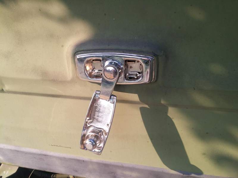

Yes for the short term, I ordered the missing wing vent latch last night and I'm changing out the lock cylinders to secure the truck (already have all of those parts in hand, that'll be today's project), and basic PM to keep the truck happy as it begins its role as my daily driver are on the immediate to-do list. No leaks to ground after it was parked for five hours after I drove it following delivery, but I do note that there is wetness around the wire harness by the Hydroboost, that'll need a rebuild and cleanup. I have all new light fixtures coming, the front fender lights are sun-bleached, front turn signals are crazing (cracked), and the rear light fixtures have over spray from the last Green 383 CARC application. Also whoever painted the bumpers black didn't mask the blackout lights - so I have to put my replacement fixtures in (they do work, I scratched the paint off the lenses and they were lit when turned on).

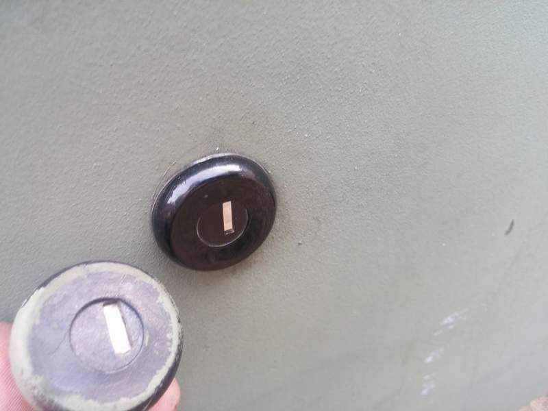

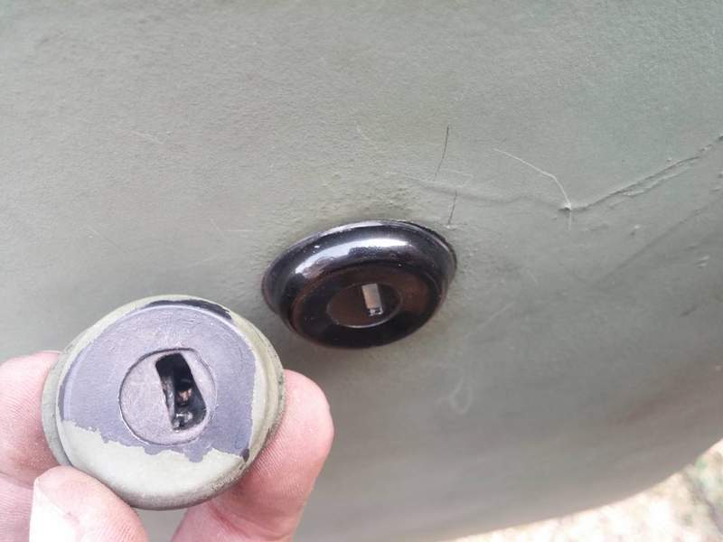

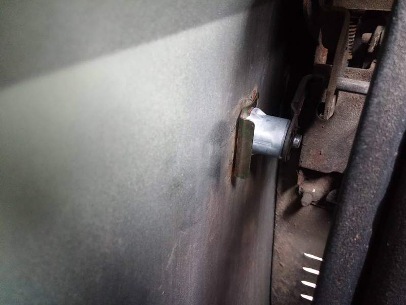

Got the tailgate crank and lock in, and lubed up the rear window regulator assembly:
This one has a unique key, not the common key:
Popped in new lock cylinders for the Driver's side (which was REALLY worn out):
And passenger's side:
I'm keeping the original cylinders should some future owner feel the need to make their truck easy to steal [thumbzup]. These locks are comically easy to change out, they are just held in with a single compression spring:
Well I didn't get to the ignition cylinder, as I do not have a steering wheel puller, I'll have to borrow one from Autozone this week to get that done.
ALL of the window gaskets and felt guide-ways are totally shot - they look original too.

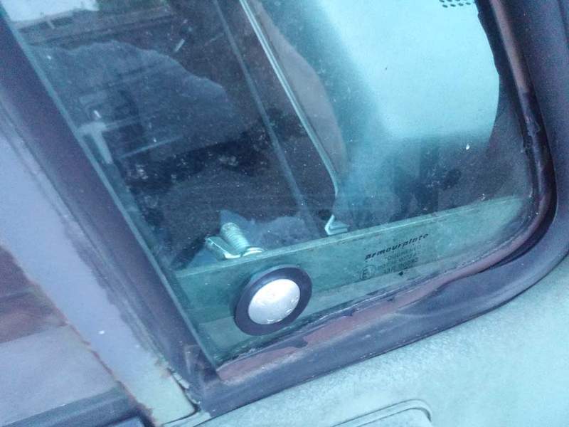

My dad couldn't help himself while I was working on the Blazer, so despite my professing that I had ordered a wing vent latch, he had an excuse to fire up the drill press and cut some steel to jamb a carriage bolt through the lock's hole.
None the less, I can now say it's more or less secure against honest people :beer: except for the fuel filler...

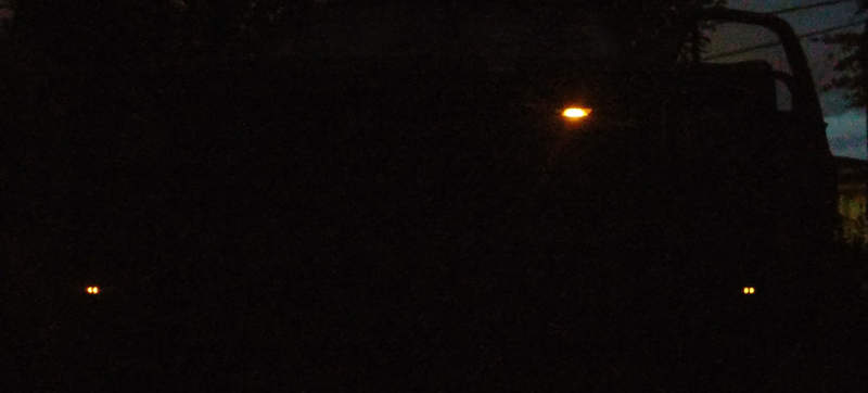

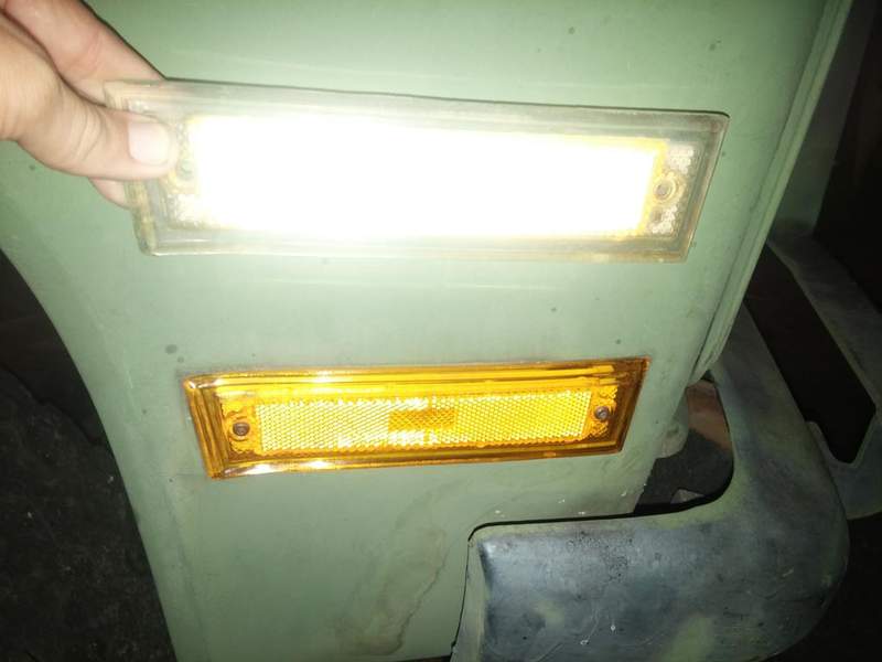

Didn't get much done today - got home from work and due to the cloud cover it got dark REALLY fast. Put in the new light fixture housings and LED bulbs in the front fenders and taillights, front fender fixtures were very bleached:
I'll have to take a picture of the rear fixtures when it's light again...
On that note, since it rapidly went pitch black and I wasn't about to dig out extension cords and flood lights to do 20 minutes of steering column work, I figured I'd tackle scraping, sanding and re-polishing the existing black out lights to see if they were salvageable. Used 1200grit to wet-sand the plastic lenses. Everything but the blackout drive should be able to be saved, the lens on the blackout drive light is cracked and mostly opaque around the bulb (little bit melted too).
Going to try to knock out the ignition switch in the morning...

Oh don't be fooled it's not "like new" but it's clear enough that the individual LEDs can be made out at the appropriate distances to be effective. This meets the requirements for the fixtures, and saves me putting $100 worth of NOS blackout lights on (and messing with more plugs and wiring). Kind of the "ain't broke don't fix it" thing.
The "trick" I use is water, a really flat sandpaper holder, and patience. I'll take a picture of them today so you can see how "not new" they still look.
If I wanted to go nuts, I could pull them and take them to a plastic buffing wheel to polish them glass clear, but removing them was specifically what I wanted to avoid doing last night.
The Blackout Drive light is not salvageable, it'll have to be replaced, but I have a box of 5 LED TrukLite Blackout Drive lights I can pull one from.

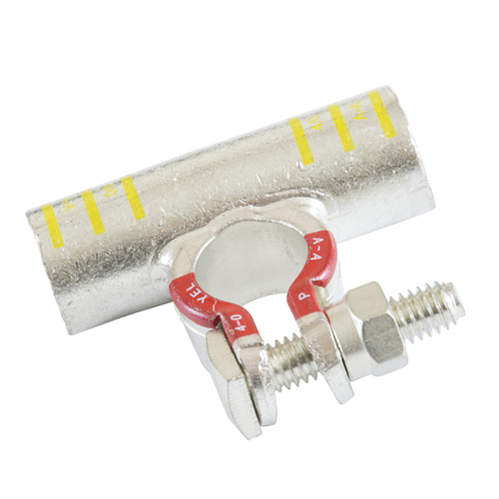

For the battery connections where it goes to two locations, I'm using pass-through flag connectors:
These are heavy gauge solid copper will be crimped to tinned copper marine cable in black insulation, and dressed-in to be pretty and heat shrunk with color-coded/labeled ends: Black=Ground, Yellow=+12V, Red=+24V.
