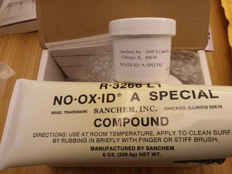

Clean, clean, clean!!! Then use a corrosion inhibitor spray near the battery to prevent future corrosion. I have heard the praises sung for No-Ox, I bought a few jars and a tube of it to play with for this purpose (conductive corrosion inhibiting grease), for battery terminal I've used a generic red protective spray, there are many various equivalents for this.

Yeah, make sure you read that it's 8oz not 8grams...
Tube is much bigger than a tube of toothpaste, small jars are about the size of a delicatessen jam. I wouldn't have ordered the jars had I noticed that at the time...

From positve directly to negative yes, No-ox is okay on large connectors, or in enclosed physically separated devicese
Where two pins are close together, there is a risk of shorting the device out...

Is no-ox-id A Special conductive?
Just remember no-ox is conductive and dielectric grease is not,I use no -ox on batt.cable ends and such.And dielectric on bulbs and fuses.
I don't think this is correct. As I understand it, no-ox-id A Special is dielectric grease with a corrosion-eating chemical added. That chemical destroys existing corrosion on your connector, leaving a cleaner connection buried under the grease.
Some conductors, like aluminum, oxidize quickly. You can clean them with an abrasive, and in the time it takes you to coat them with grease, they form a new oxide layer. No-Ox-Id is designed to eat that new oxide layer.
After reading this post, I took my best Ohmmeter and tested a bead of no-ox-id A Special. It does not conduct electricity. I use it on all my electrical contacts, without fear that any misplaced grease might conduct electricity.
Note that there is an "Electrical Grade" of no-ox-id A Special that I did not test. I suspect the results would be the same, but I encourage anyone using it to test for themselves.
The No-Ox-Id marketing materials call it a conductive grease, but I think this is misleading. It does help 2 connected conductors conduct electricity, by stripping away old corrosion and protecting them from new corrosion. It does not conduct electricity itself. I think it would more properly be called a contact grease.
There are conductive greases out there that do conduct electricity. Some have powdered metal mixed in, for instance (a real recipe for galvanic corrosion, IMHO). According to my best ohmmeter, no-ox-id A Special does not conduct electricity.
