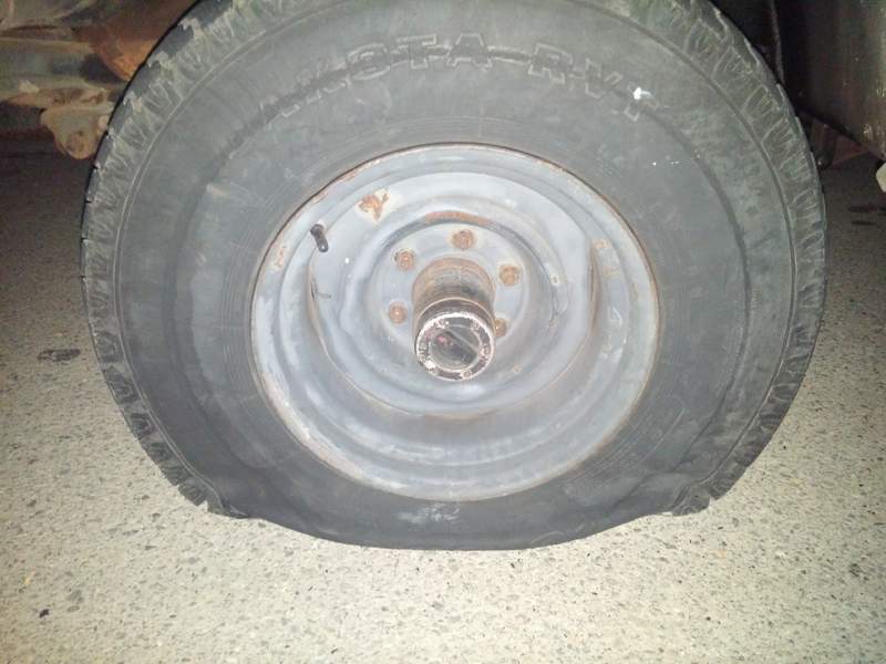

And then I took a closer look at the jack, awww... doesn't work :(.
And then I remembered I hadn't inventoried tools... tripple awww... No tools.
Well at least my phone is charged. Looks like this evening is going to be a bit longer than planned.

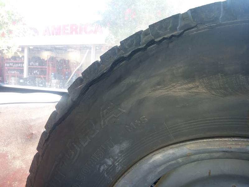

Tread separation, about 6-8"around the outside where the tread meets the sidewall. Nothing spectacular during the failure, just started shimmying a bit as I rolled to a stop at a light, really shook a bit when the light turned green and I started rolling again.
I was in a 45MPH zone with no traffic, and was able to pull off the main drag without incident or damage.
I knew I was going to be replaging tires soon when I received the truck, but this one let go a bit earlier than I forecast. The spare that I put on in its place, well it's ugly... bald, uneven wear, and lots of side wall cracking - it was also less than 5psi... so I'll be getting at least two tires tomorrow. The spare was enough to get me two blocks to a service station with a compressor, and now it'll get me to a tire shop tomorrow (first stop).
Lots of rubber stuff to replace. Wally, did this sit for like a year without being driven, or is this how you got it?

Nope, but they are all tire code "1904", which is 19th week of 2004. So they are 11 years old... It is definitely borrowed time, and they don't look like they were run often so the rubber got stiff (all this new driving is flexing stiff rubber parts - This is why replacing rubber that sat is important).
