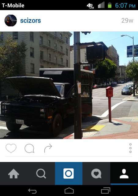

My truck sees some big hills, but so far this tank has been relatively flat and mostly city. I used to drive to the top of Nob Hill to drop my fiance off for work and pick her up all the time, one of the steepst grades in the city.
here's my truck out of fuel right after backing down Taylor with no power. My fuel gauge has since been repaired. It is one of the steepest hills in the city on the way to Nob Hill
