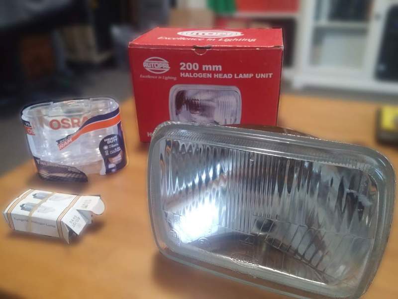

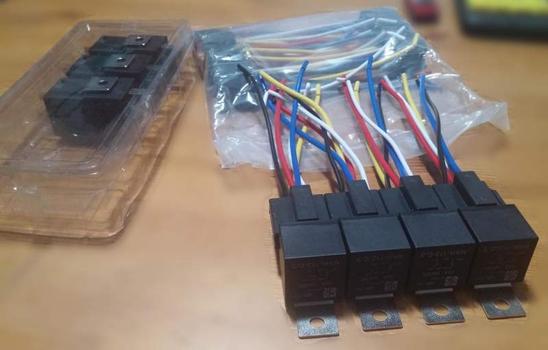

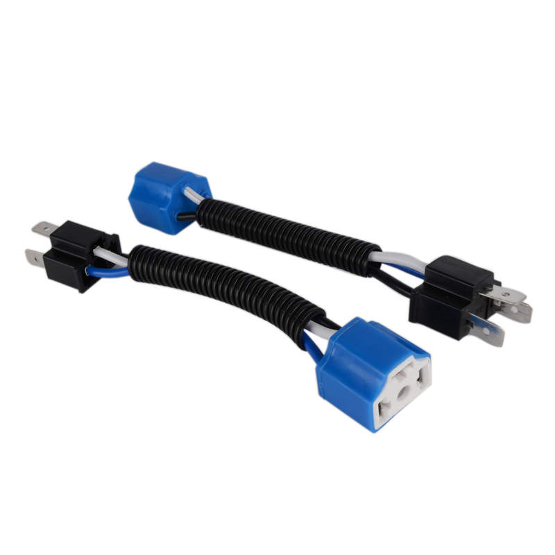

Instead of the Cibie's, I've purchased a set of AutoPal 200mm (H6054) assemblies to drop into the M1009 - also bought the parts for my own headlight harness. I built one for a friend who had a Subaru Impreza WRX "bug-eye", after I had done an HID kit for him things were behaving weird and I noticed the voltage at the bulbs under load was <9V :shock:. I'll be using the same design for that:
  • Ceramic headlight extension - for preventing melting when using halogen bulbs with OEM plastic connectors. Has both a male/female plug on a 12" cable.
  • Relays - the coils of the relays will replace the coils of the filaments in the OEM circuits. Simple!!
  • Relay sockets - makes this a bit easier to service should a relay die during my care of this truck
  • 24V bulbs - OSRAM TruckStar Pro, I'm moving all of the big chassis loads off the 12V system I can - the only one I can think of I can't move is the wiper motor and heater fan...
  • Fuse holders - yes, plural. In my bus and other trucks I've seen, as well as many Japanese cars and trucks I've worked on over the years I see a left and right fuse. This is a brilliant (ha, pun) idea, since fusing both together would leave you blind should THE fuse blow...
I'm also preparing to install Hella Micro DE fog lights I had for my Toyota that I never had the time to put in. The relays will bet set up so that the power goes to:
  • High beam relay controlled by high beam circuit - the high beam filament (ON), or the low beam relay (OFF)
    • Low beam relay controlled by low beam circuit - the fog light relay (ON), or the city light relay (OFF)
      • Fog light relay controlled by fog light switch - the fog light filament and low beam resistor (ON), or the low beam filament (OFF)
      • City light relay controlled by parking light circuit - the city light filament (ON), or dead-end/nothing (OFF)
Based on where I pull the fused power that feeds the daisy-chain of relays, this can be either 24V or 12V - the relay coils are 12V to match the OEM power. By daisy-chaining and wiring the relays this way, I ensure that high beam gets the highest priority, fog lights only run with low beams as required by law, when fog lights are on I can drop a resistor that dims the low beam filament outputs 60% of its rating to reduce back-reflection from the higher mounted headlights, and finally the city lights will only run with the parking lights. I'll be recycling the switch location for the manual glow plugs since it's there - but I'll be changing the switch to a military M-type on/off lever switch.
So the only connection to the truck will be the plug that goes into the factory light plug, and power from the batteries. Totally reversible [thumbzup]

Almost all of the parts have arrived - just waiting on the ceramic extensions.
Auto-Pal HL-109 fixtures ($44 for the pair shipped), OSRAM TruckStar Pro H4 24V ($20 shipped from the UK), and a set of common 24V/10W halogen BA9 bulbs ($14 shipped). Bulbs are installed in the fixtures, and stored away again. When I install these, I'll do a before and after of the beam pattern in the dark.

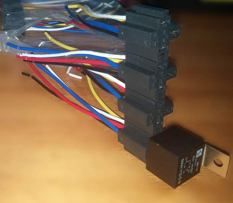

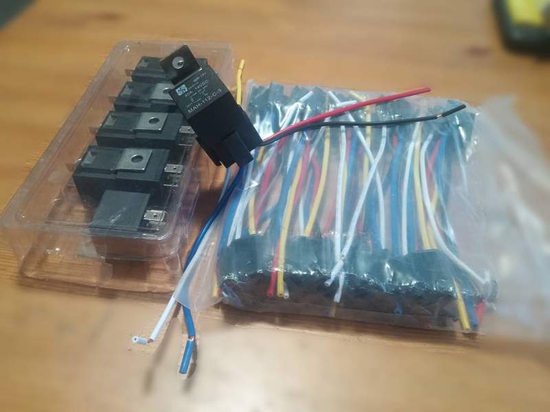

Relays and holders came also ($28 for 10x sets shipped).
I got the type of harnesses that interlock:
Which will keep the clusters neater and more uniform when installed.
Here's the wiring diagram for one side of the headlight harness - the only difference between both sides is the length of the wire going back to the battery. :beer:
View attachment SS_Headlight-Harness_1-1.pdf

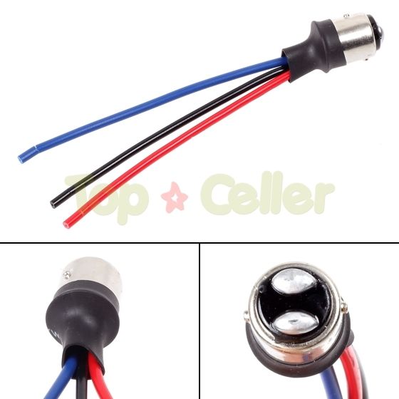

To get the parking light power, I have to pull power from the front turn signal wiring - and to avoid cutting wires there, we can use a "fix-it solution" of a male 1157 plug:
These I wire up to a replacement bulb socket (Dorman 85830) which comes as a pig-tail. Again, I don't modify the original wiring to tap power, a simple twist and the bulb can be swapped back into the factory socket and returned to original - I just need to cast a boot for the socket to keep it dry (which I'll do with casting silicone). [thumbzup]
