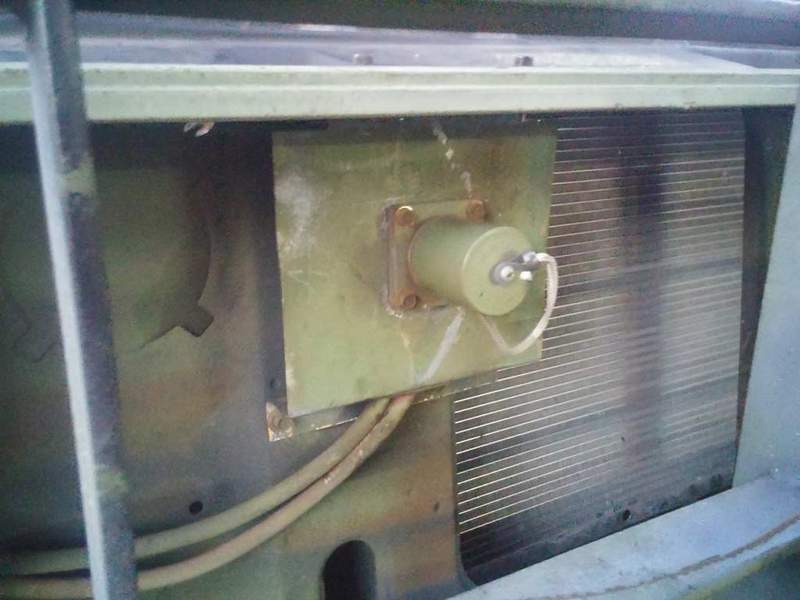

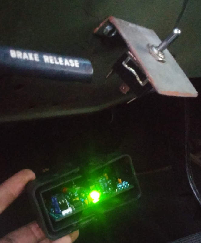

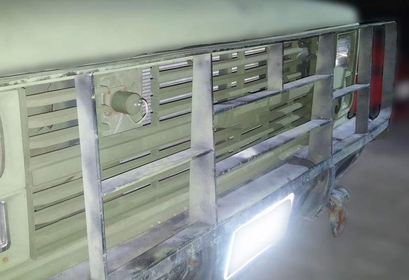

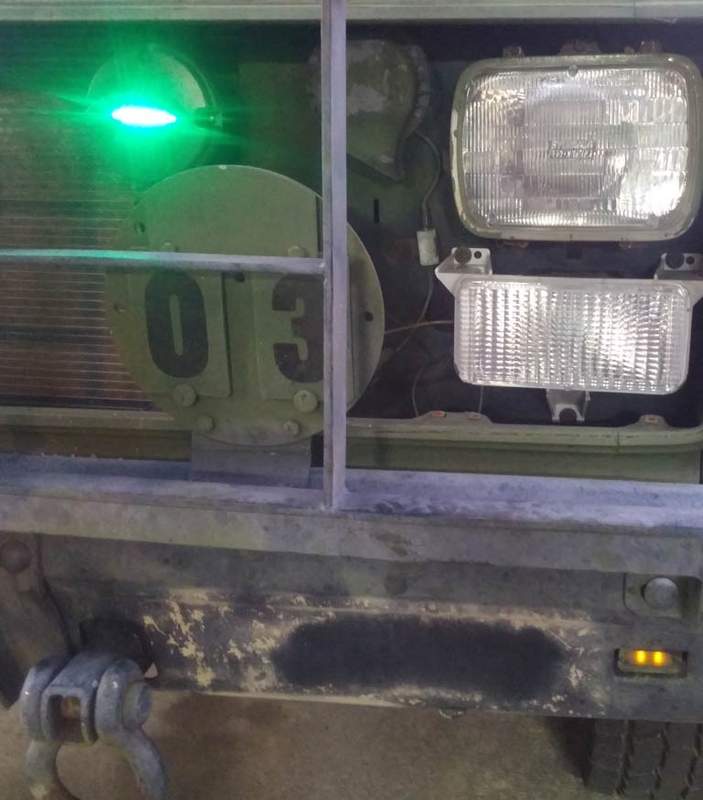

Time with kids and laundry kept me from making the headlight harness today, and I'm not sure if I'm going to have time tonight to go for a solo ride for sound mapping. That said, today was not a total wash...
Pulled the old grille (what was left of it) and started some work in the front end. I noticed the blackout headlight that previously I had mentioned had an opaque lens, also had a wet spot under it - it's been a while since the last rain, so that's telling as to the problem. I pulled the fixture and once I had the bolt loose, a bunch of water started draining from the housing (argh...). Fortunately I have a box of Trucklite BO headlights, so I fetched one of those up and changed the plug to match the weatherpak type plug on my truck. Bolted it up and gave it a test:
Next, on to the NATO port, that has been bugging me since I bought the truck. Took out the plate and it looked like it wasn't that bad, my dad went to town on it for about three minutes with a plastic mallet on an anvil, and managed to get it squared and trued. Reinstalled it with a healthy dose of No-Ox on the wire lugs:
While he was doing that banging, I spent a few minutes in what daylight I had left figuring out the glow plug harness situation. All of the wires/circuits tested out good and so did the controller, so I just reconnected the GP relay to the controller, and for good measure I put in one of my AntennaClimber GP controler cards, everything went as expected, and the toggle switch is now inert pending replacement with a military rotary switch for fog lights:
As I alluded to, there wasn't much left of the original grille, the top bar was broken at every mounting tab, and where the NATO port had been bent out the grille had caved in - I also had a moment with a hydraulic spreader to pull out the bar of the brush guard just above the front license plate. I grabbed a NOS grille I had in storage for the XM1027 project and brought it to the M1009 since it's currently my daily driver (I'll have some time to find another one... hopefully).
So before today:
After today's work:
Four hours of work and it's barely noticeable... [thumbzup]

No disrespect received - but my wife reads the forum so I need to make sure I stick up for her and giver her credit for her effort when questions come up... That's love baby!! :mrgreen:
:derailed:

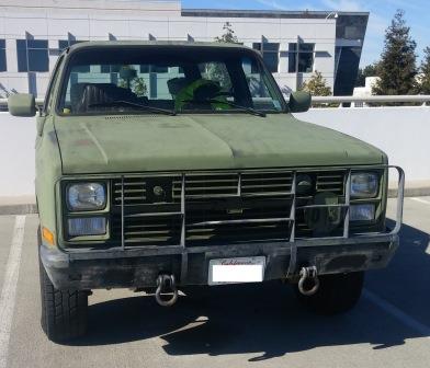

Let's pull this back in with a daylight picture of the front end at my work's parking lot (couldn't help but be happy about the work done) :beer:
