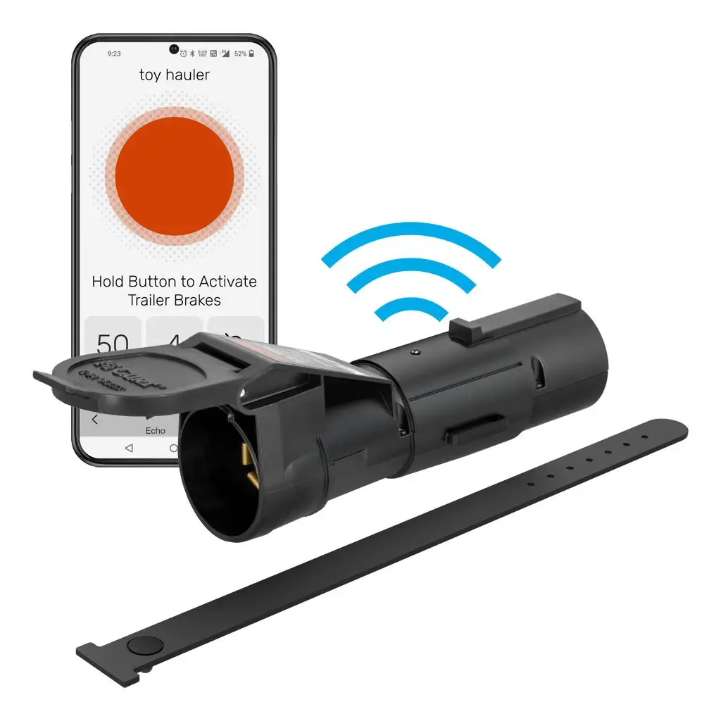

I could have done an in-line brake controller like this one:
but to do anything with it requires it to be bluetooth connected to your phone to set up and do any changes, and would require the same 30 amp 12V power wire I installed for AUX power above, but wouldn't be able to be wired over to the NATO socket (might need that on a possible future project), and still costs more than the REDARC did. While the install is a lot simpler, it wouldn't do what I might need it to in the future. As for the phone connection, I much prefer to not have it's screen on when driving, especially at night, and I'd have to have it mounted and power supplied to it. Only having a single knob to deal with makes things simpler.
