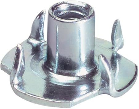

I ended up going down an interior rabbit hole and took the dash apart to rebuild the gauge cluster. There wasn’t many screws holding it in because a lot of the mounts have broken off. I think I’ll need a new cluster to mount everything back into. The gear indicator is also broken.
Im planning to clean it up and change all the lights to LED and install a new a gear indicator and put it all back together. May even throw in a new dash pad and seat cover… maybe even some vinyl flooring lol. We will see.
Please give me your advice and tips on the interior and dash.
Thanks!
cucvrus
11,481
10,505
Jonestown Pennsylvania
To me the cluster looks fine. It appears to have 1 broken tab on the left side. Common problem. Make a tab of light metal. I have used a flatted C clip or a conduit clamp flattened. The shift indicator is available from LMC. You can make a simple cable guide from a reversed T nut. Grease the T nut and run it in with a scew in the steel part of the dash. Last forever.
Metallic Conduit Clamp
Amazon.com: Parts Express #10-24 T-Nuts 50 Pcs.: Home Improvement
Tap the serrations down and use this as a cable guide. It is 10/24 size. It works. I have made many serviceable again with this method. Cleaning any polishing the clear plastic will be nice. I install the housing and reassemble the cluster from the drivers seat. Putting the speedometer and the fuel gauge in after I have all the lights working and the cluster bolted in place. Easier that way to me. Beats removing the cluster every time something is not working. Good Luck. Keep up the Great Work.
