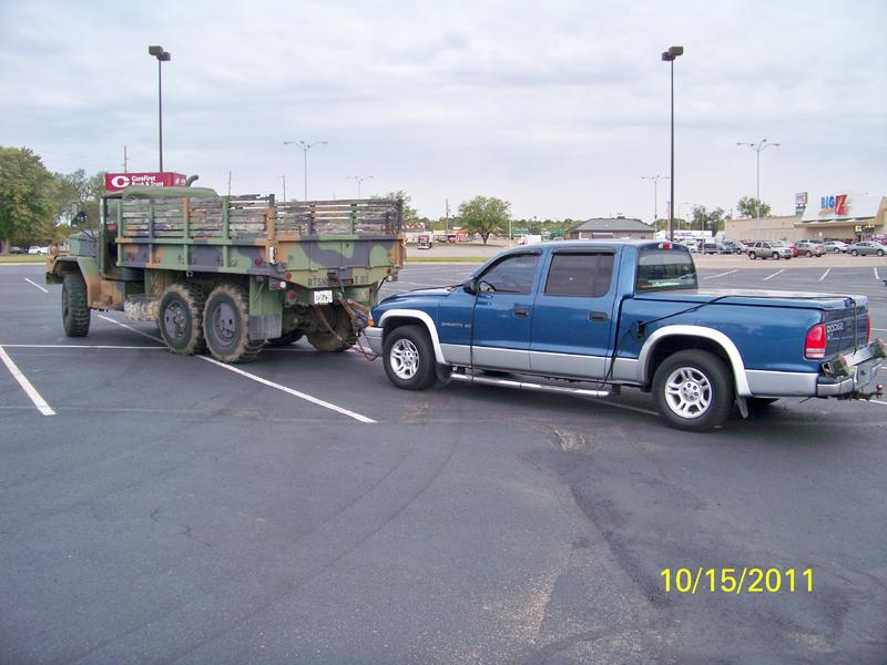

Just talk to Steve they are 60 miles North of Birmingham, AL, Says the tire wobble seems to be better since I told him to turn the CTIS. Says only traveling about 47 mph. Says he is getting 12 MPG... I will update next time he calls.

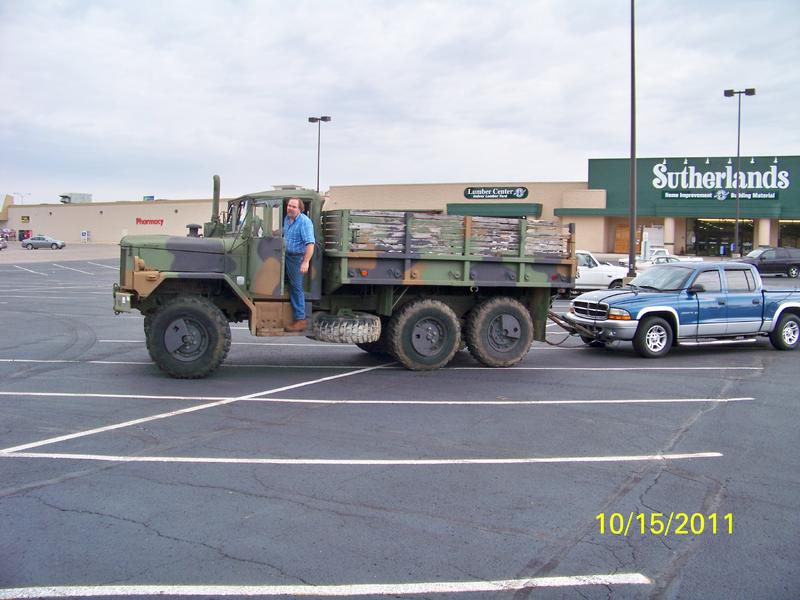

left thursday morning about 8:30 am, got there at the same time friday to pickup the truck. Drove it just down the road to a large parking lot to hooKup the pickup and get ready for the road. I thought this truck would do 55 mpg, wrong - 50 mph at 2,800 rpm and tires would shake your teeth out.

congrats on your new truck ...sorry to hear about your trans problems. being held over a barrel by some @#$ at a distant shop is every guys nightmare. yea when i asked how fast an a3 went i got alot of wrong answers and one right . these speedos are off quite a bit. the tire shake sucks, but a ss member gave good advice . 5 extra lug nuts across from the ctis got rid of 99% of my shake. i love my a3, alot more than my a2. yep it looks like its bent,especially when its loaded.:deadhorse: with a 5 speed od trans and hydraulic steering id like it almost as much as my 923

Hey Steve! Ditto on hope you are home! My a3 rides pretty smooth with a mix of contis. And michelins, you shouldn't be that shaky. Maybe your wheelweights?

All the wheel weights are in place, in southern AR. stopped and aired up the tires, the rear were 35 psi and the front i had aired to 50 psi. Went to 65 in the front and 60 in the rear, made a big differenace. Was able to get up to 54 mph rolling down a hill, but still shaking. Did well at 2,700 rpm at 48 mph.

Not sure what fuel milage other A3 owners are getting but it looks like 9 miles to the gallon at 3,000 rpm wide open. 10 miles to gallon at 2,700 rpm, i think i can get 11. Looking at 14.00 x 20 tires. This change would drop 348 rpm at 50 mph and 60 mph can be achieved. I believe 12 miles to gallon is possible.

Steve, not sure, but I do not think that the 14.00 tires will work with the duals, but did I read somewhere that you were thinking of bobbing it ?
If thats the case, 16.00s ! LOL !

Yea it would be a 4X4 for that tire. This truck will need alot of small parts, the brake light switch quit, the pass side door latch stripped inside, the air assist steering does not work, the air valve is on.
