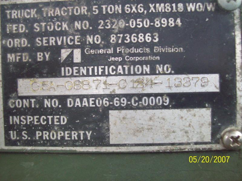

I hope this all ok info to post on this thread, but here goes
My data plate says that it is a M35A2C WO/W
Identifiaction data
Stock No. 2320-926-0873
Identification No. 95-19369-720540-10001
MFD. By AM General Corporation
Contract No. DAAE06-70-0001
Again thank you to anyone that can help me here. namely jeffhuey1n and CARNAC. This truck was bought in NC and has been in NC for a very long time (at least 20-30 years).
Thanks,
Corey

Corey, the stock number is in the old style. All NSN's now have either 00 or 01 after the first four numbers (2320 in this case). The contract was let in 1970. Your trucks contract was the first one let that year. Is there the letter C anywhere in the contract number? The identification number is difficult to figure. Since the location is NC and due to the high concentration of Marine Corps units, I'd take a bet it was a Marine Corps truck. 20 to 30 years would have put in service as late as 1982. Marine Corps units were still using that type truck around that time frame. So putting my Sherlock Holmes hat on, you have a 1970 ish M35A2C, once owned and operated by the Marine Corps. Ways to find this out would be to gently sand down the left and or right side of the hood. If the truck hasn't been stripped down to bare metal after release from the military, you'll find the letters USMC/USN or USA or possibley US Army. An Air Force truck would have the numbers on the doors as well as US Air Force. Again, judging by it's location, I think Marines but I'm kind of prejudiced towards them. Ft Bragg(?) is also in the Carolinas so maybe...a real long shot there because CARNAC couldn't find it. Air Force? Possible but the Air Force bases in the Carolinas would have lttle use for a Deuce. Doesn't mean they never had them, just highly unlikely. While researching your truck I came across this article. I think it'll go a long way to helping you as well. Use the process of elimination. If your numbers just don't show up, Navy/Marine Corps becomes more and more likely. Here's the link. if this doesn't work, I'll try another way of posting the link. Deciphering the codes: Kaiser-Jeep and AM General 2 1/2-ton Truck Production | Military Trader
Let me know if you get some positive results. I will tell you that both my 1972 M35A2s WO/W have the exact same contract number. The ID numbers are nothing like the one you list. Is there a possibility of taking a picture of the ID plate and one of the truck as a whole? If you can take a pic of the inside of either or both doors, that's help as well.
Jeff

Thank you Jeff!
I have discovered thus far that Am General was the last manufacture to fill contracts, and since mine is 10001 then Im almost sure its a 1970 truck under my trucks contract that was let in 1970.
You were right, there is a C in the contract number, its just hard to read because my data plate has been sand blasted it looks like around the edges.
Here are pics of the data plate inside of the door and a comparisson of that paint color to my hand and to arevoe 977B SG OD 24084 (vietnam era 24087).
And also some overall pics of the truck. Keep in mind that the bed has been changed out before I bought the truck.
Thanks,
Corey
