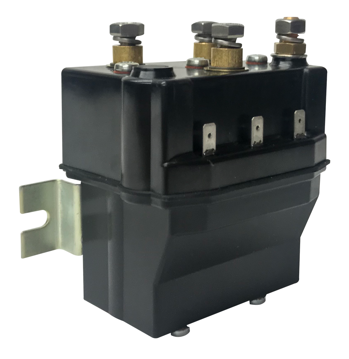

Starting to understand what the equalizer does, still a little confused about how its wired from alt to batteries, and where is the best place to source 12V for the winch..
Duty cycle is important, and with an electrical winch, obviously duty cycle pause is going to be longer based on draw. I am just not at the point to pull trigger on hyd winch system.. but would love it.
You will probably want to wire directly to your batteries. Then the equalizer is connected to Ground, 12v, and 24v at the batteries as well. The equalizer only detects if the two 12v halves of the system are equal. It helps balance them but does not add any power to your system. It pulls from one side to the other when charging.
Some winches can pull a lot of current. Talking 400a+. Look at your winch specs for stall current. That is your max it can pull. Your batteries are like giant capacitors. They source the peak draws but will start dropping down if you pull too long. Then you wait to recharge and pull again.
At least this is my understanding…. Hopefully I worded it correctly.

That looks nice. Where did you get it? A link?
Yes, I picked that up from a post in what have you done to your LMTV.. and if I remember, it was Third from Texas. Freaken great system.. like alot
