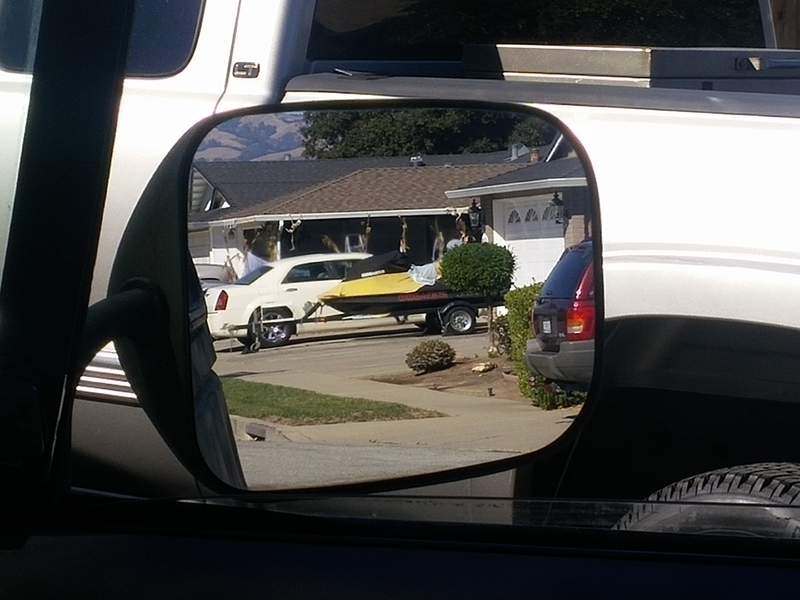

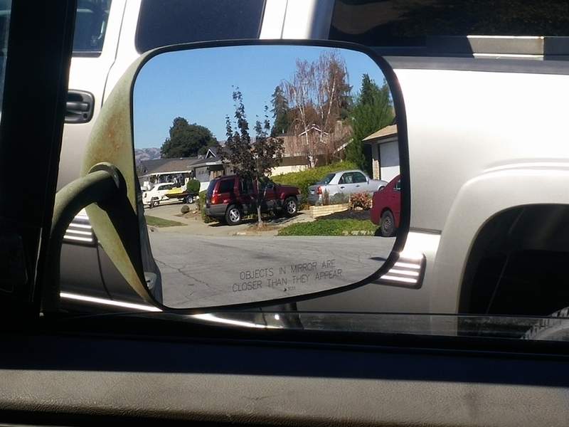

Happy Halloween!
I finally had a moment without kids or work to re-attempt the inside rearview mirror, and do the passenger convex.
Here is the before (factory) mirror:
And here's the after (Burco 3031):
Even when I'm kid free, I can never truly be kid free - my oldest came outside to "help"
