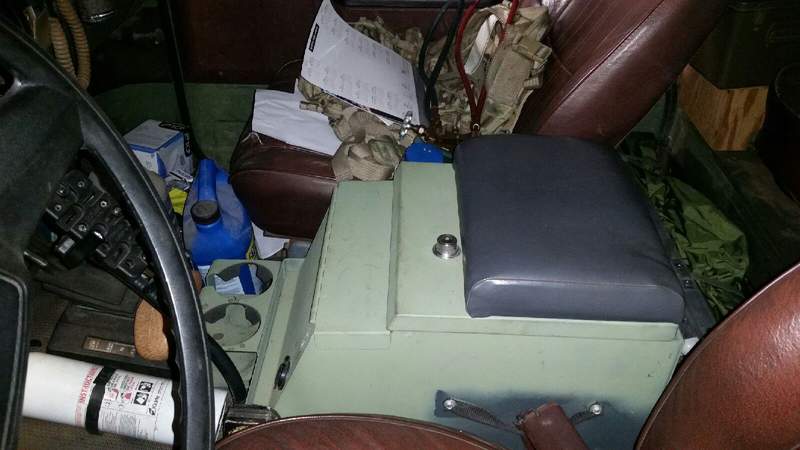

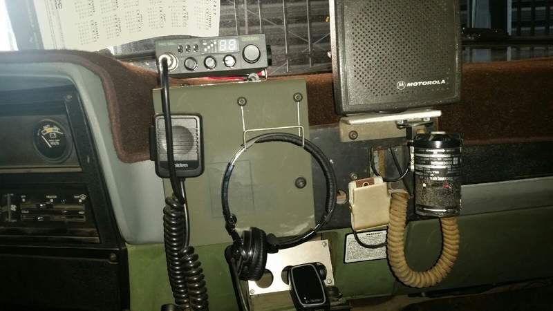

I am almost afraid to delve into the "Carputer" aspect of your build as it will probably be yet another item I find just too darn cool/useful to do with out. I did cave to the technology a bit and added a holder for the smart phone attached to the front of the center console, it positions the key board so it is easily viewed while driving and the Bluetooth headset allows me to hear someone on the phone while driving on the freeway with the windows open, which isn't possible with a normal Bluetooth. While what I have added to my truck that may not be everyone's "cup of tea", I do like the way it works for me, excuse the mess in the truck, it is carrying items for several projects at once. I made a couple sheet metal mounts for items on the dash mount for radios that do what I want but do not alter the original mounting plate if I ever want to restore it back to original. The center console is from Tuffy Products re-painted rattle can green, I like it because it has lots of room inside and is extremely secure to the point it would be more trouble than it is worth to try and pry it open when locked and it has a secure space for a radio/CD player that preserves the standard military instrument panel.

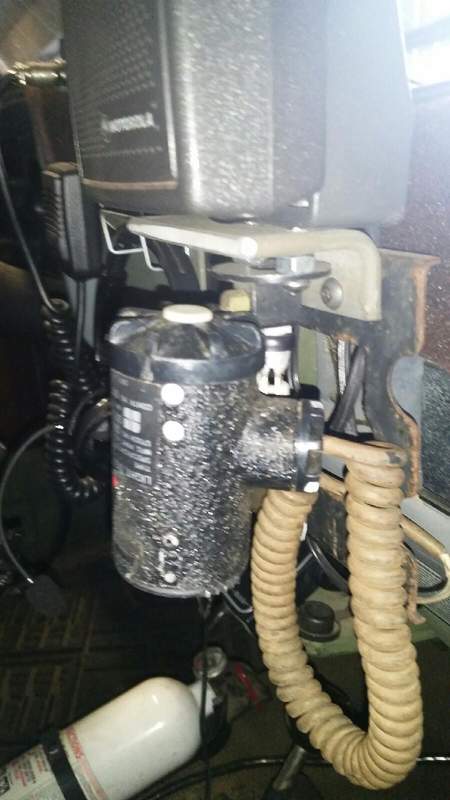

You got a real nice set-up there, emeralcove.
I'm not that familiar with the M1109; is that flexible tube from the canister on the dash some kind of NBC warning system or something...
Or maybe it's your built-in Hookah!?

Looks functional - that's probably the most important, appearance usually takes a back seat when time is short but yours looks good.
Ahab that's a gooseneck holder (phone, microphone...).
When I did the family trip in the spring, we did a cell mount to the windshield and an Aukey 4-port usb charger. We blew through 10GB of data in no time - GPS with satellite imagery eats data like a termite eats wood.
Ths trick with the carputer in this truck will be to make it blend in - not easy to do with a 1986 Chevy and a 12" LCD, but not impossible. The XM1027 will have a different style, so I'm less interested in "blending" there and more interested in the function.

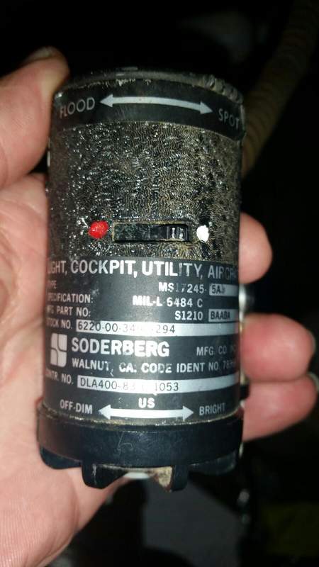

cockpit light 1.jpgCockpit light 2.jpgThat canister is actually a aircraft cockpit light and the coiled power cord is what you see as a flexible tube. It is a fun little item used in both military and commercial aircraft, has red and clear lenses as well as a flood/spot adjustment. It is set in a mount that allows the light to be pulled out to use remotely as well. You can find them on eBay for reasonable prices or new for crazy expensive prices, the good part is they are still manufactured in Walnut, CA so repair parts are also available. I joined SS a few years ago and mostly have just read what others have done, but as retirement draws closer (16 months) I find I really want to play with my projects more. My wife and I started with a purchase of a M35A2, a trailer for it then the M1009, a trailer for it, a generator.................. well you get the picture, LOL. I do appreciate what everyone on this site contributes to make this hobby/obsession vastly more enjoyable. I know shortly after I towed our M1009 home and I was working to re-assemble the pile of parts that resembled a vehicle, I learned why there was a "Doghead relay fix", you have no idea how long it takes to open the hood and disconnect batteries to stop the starter that is "locked on". It was too late for the starter but I did save burning all the wiring up. Anyway that was when I learned the value of SS!

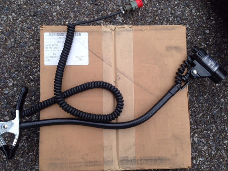

I picked up a few task lights from EnteJager for both the M1009 and my XM1027. They are similar to the aircraft map light in the picture, but use "secure" white (IR filtered white) and NVIS-A green LEDs. I figured a map light would be good and would look right given that the military uses them all over the place. Just needs 24V.

The cockpit lights are 24 volt but the 12 volt conversion is merely installing a 12 volt lamp, they do offer them in new LED but WOW are they expensive, so I am happy with them as is and can always upgrade later or perform a "LED enhancement" when other projects are completed.

The ones from EnteJager were $65 a piece - I bought 6x. He still has a few left. For the XM1027, one of my design requirements was being able to drive with AN/AVS-6 NVG which are only compatible with NVIS-A lighting to avoid washing out the imager tubes. The tubes are fitted with a 625nm high-pass cut-off filter, so the are not sensitive to light below cyan on the rainbow (blue-green, blue, violet...), but you still need to be careful with the cabin/instument intensities so that ambient light doesn't affect ones pupil dilation (making the NVG image harder to see).

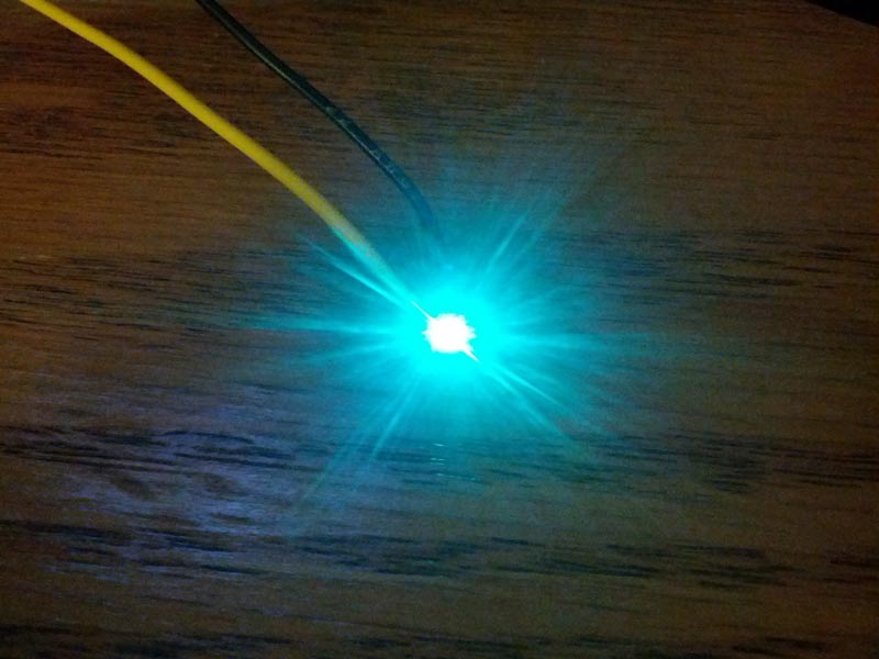

I have some NVIS-A green and yellow LEDs I bought from a vendor called Wamco (they produce cockpit display systems, etc...),
so I can do instrument lighting and idiot lights - I also have blue/white Grote LED dome lights to use - the map lights were the last piece I wanted - I don't like washing myself in more light than I need for a task, so these lights from EnteJager were perfect!!

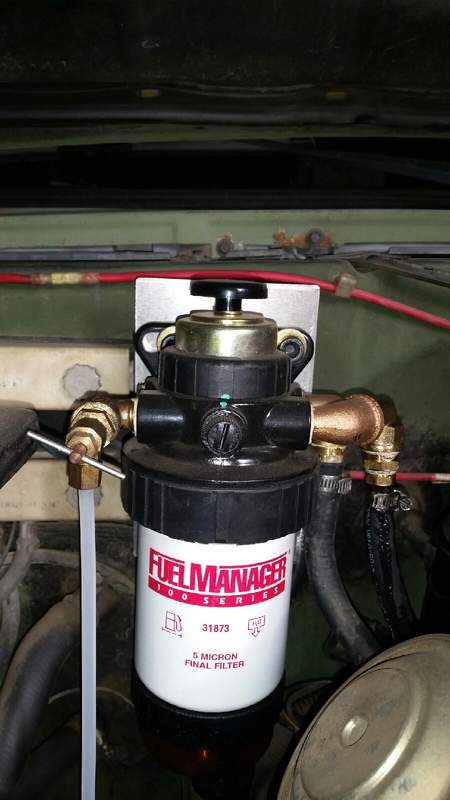

Yeah okay - today it was harder to start the truck. I did 30 seconds of manual glow, but being below 40°F (4.5°C) and being in the shade in the morning she was bitter cold. When it turned over and sounded like it was firing on only 3 cylinders until I had done some after glow (3-seconds-on 3-seconds-off pulses for about 1.25 minutes). I am now more motivated to put some time into getting the automatic glow system sorted out this weekend - gotta see if I can take the kids over to the grandparents for a visit while I work in the driveway... :mrgreen:

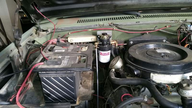

fuel filter 1.jpgfuel filter 2.jpgI have found there are two possible problems for cold starting, the first is the obvious glow plug issue, the other took me a while to figure out as it came on very slowly. I first experienced it when the overnight temperatures dropped, then later I noticed is was worse if the front of the truck were up-hill even a little, then it was a complete PITA to start and I was having to bleed air from the fuel filter, I changed the lift pump, no joy, started looking for air leaks in the fuel line, changed the box like fuel filter, still without success. Finally I replaced the entire fuel filter and added a hand "priming" pump because I was so used to having to bleed air from the fuel lines. As it turned out the priming pump worked great for the initial "bleed" but have never had to use it again, but by gosh I have it now if I need it, LOL. The needle valve is for bleeding the trapped air, it also has not been needed after the initial start up. This is a modular filter and both water separator and fuel heater can be added so the "water in fuel" light can still be retained as well as the factory fuel heater in the fuel filter. The Bracket I made is just a flat piece of aluminum and two pieces of steel tubing as spaces for the longer bolts that uses the existing bolt holes so restoring back to the original style filter is a few minutes of wrench work.
