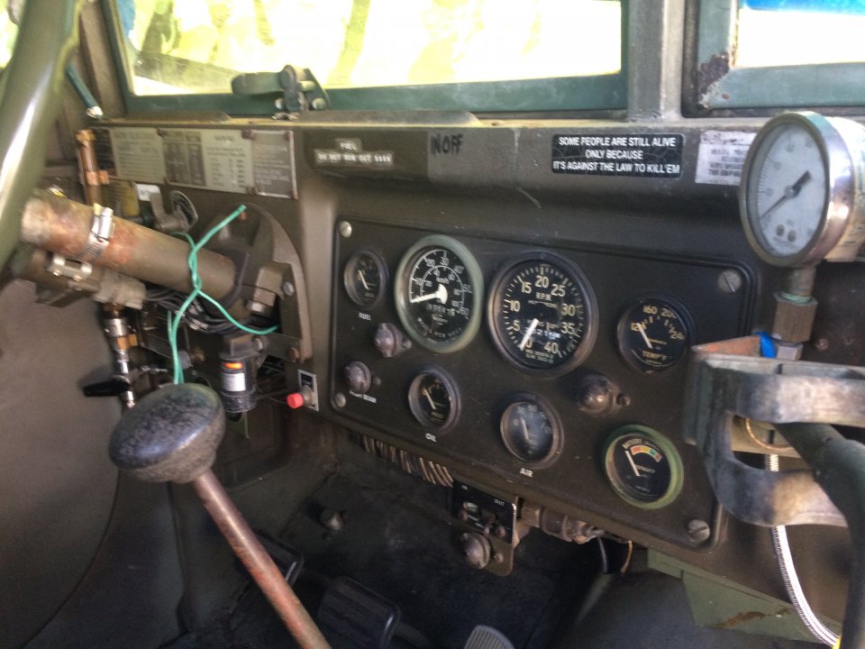

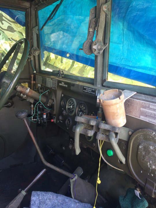

Ok, guys… one simple question. Someone cut the air hose at the dash (inside the cab) for the air-powered wipers. I’m putting electric wipers on.
would it be safe to assume that hose needs to be plugged?
Mullaney
8,207
20,738
Charlotte NC
EDITED (Thanks for clarification cattlerepairman !)
Hose runs up to the wiper, so you should have an air leak and feel an air leak.
Wiper control on and off is (NOT) mounted on the wiper motor.
If you plan to replace the air wipers, following that loose hose to its origin would be the safe way to stop that leak. Yeah, you could plug it with a golf tee or a bolt and a hose clamp, but disconnecting it solves a future leak in that hose. If you don't feel air coming out, somebody may have already "fixed" the air leak.
Danspomer
97
148
33
Colorado
I also have several push buttons that don’t match the manual. Aftermarket stuff? I found that this was used by the city of Farmington, NM for some time.
Danspomer
97
148
33
Colorado
Um...hose runs from air supply to the wiper control valve in the dash and then to the wipers. What you cut after that dash valve doesn't matter, as long as you leave the dash valve closed.

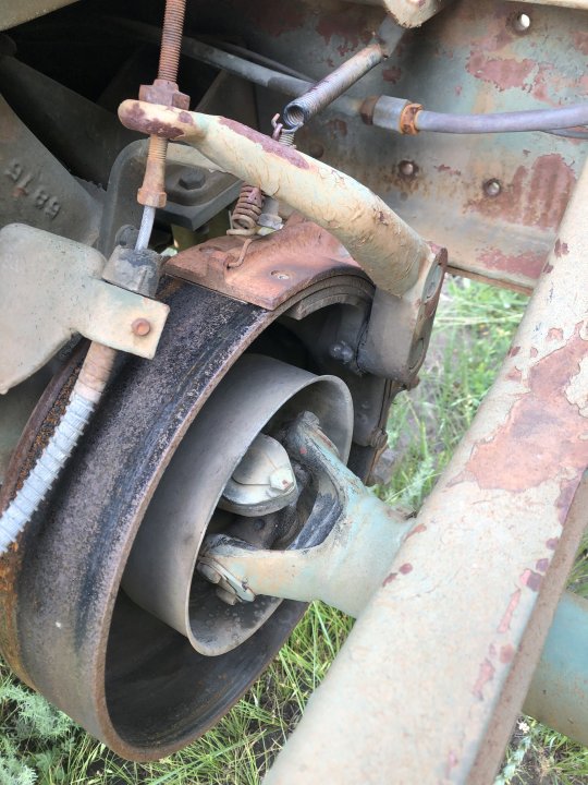

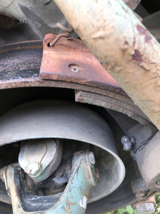

Gentlemen: attached is a photo of my parking brake assembly, taken today. I think one side of these shoes looks worn (or gone). Would that be a correct assumption?
Also, is there an agreed upon procedure for adapting the air access port under the dash with standard air fittings?
Many thanks in advance!

The outer shoe sure looks worn to me. Can't tell for sure, but it looks like a prime candidate for replacement. I wonder if that grease fitting needs a little attention. What should happen is that pair of shoes "float" on that center pin and when adjusted, both shoes should contact the drum. Out here on the near side of the drum, I don't see scores like the shoe lining is completely gone...

Thanks for the reply on the brake! Much appreciated! 👍

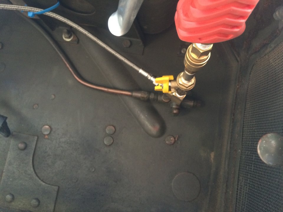

For safely airing up tires I used that. I put a tee to a real gauge up to the dashboard and a stop valve and a quick disconnect fitting for my tire pressure gauge. I put air line to the tire with latching head. Filled tires up. That Matco tire pressure gauge able to be stop set at specific pressure. Don't even need truck running after air is built up.
Air pressure needed for brakes that is why I wanted a really good gauge in my sight at all times.

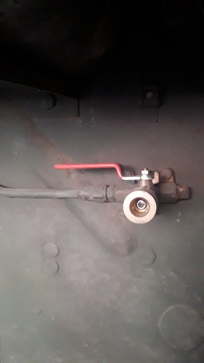

I have a valved air outlet under the dash of my M35A2. The metal pipe looks like its been there a while, while the valve and coupler both look brand new. My guess is that a previous owner replaced the original valve, maybe it was leaking? Anyway here's a picture of mine
I think the same as you, that it is intended for airing up tires, small air tools. Perhaps someone who knows can clarify.
Danspomer
97
148
33
Colorado
I have a valved air outlet under the dash of my M35A2. The metal pipe looks like its been there a while, while the valve and coupler both look brand new. My guess is that a previous owner replaced the original valve, maybe it was leaking? Anyway here's a picture of mineView attachment 839705
That looks like the original air outlet, with a new gate valves for the hose attachment. The original gate valve is much more rudimentary, but works. He removed the original gate valve, it would appear.
Mullaney
8,207
20,738
Charlotte NC
Awlright! Found somebody who had one!!
Now at least you have a picture and something similar.
Thanks for posting and the pix M35fan !
